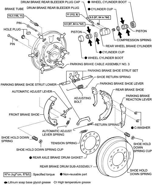

    Anyone have this spare arm from the drum brake mechanism? Mine fell off and came in contact with the drum, grinding off an end. Dealers don't have it in stock and need to order from Kentucky with two-week lead time:

    ^^^ tough one. maybe cross reference with 4 runner of lexus most likely same brakes

    a better pic i think

    Have you tried calling scrap yards around? Car-part.com

    If you can't get one maybe take the other side off make a template and do some creative grinding??

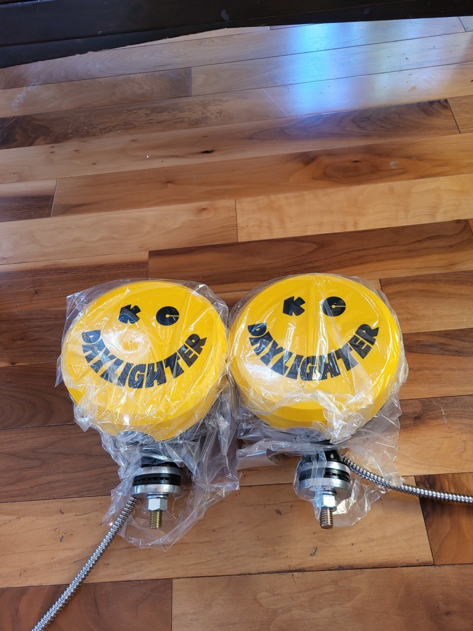

    Any input on how to mount offroad lights on a stock bumper? Are there specific brackets available or can they be mounted straight on (through) the bumper?
    Haven't really taken a look yet, figured I'd ask the experts first :D
    Also contemplating mounting them at the bottom of the A-pillars, but I'm not sure if those ditch light brackets are sturdy enough for KC Daylighters?

    define
    "Offroad lights"
    are we talking about a 30" hidden lightbar? ditch lights, a 40" overhead?, hood scewp bar? grille lights like fake raptor? whatever the fuck this grille light thing is trying to do. Rock lights, RGBQRTYZ pride lights

    few ways to go around with that;
    1) there are brackets similar to that Cali raised ones but goes outside in the same location;
    https://camburg.com/shop/accessorie...acoma-16-30-s8-led-light-bar-grill-mount-kit/
    could modify one or build a crossbar for the round lights.
    2) I've seen one of these but with less lights: (look at customer photos, there is one in there that shows 2, doesn't look bad)
    https://www.extremeterrain.com/nfab-front-light-mount-bar-textured-black-1619-tacoma.html
    3) this hoop bar thing: 4)do what @Norilsk did; https://www.google.com/imgres?imgurl=
    5) some ideas; https://www.tacomaworld.com/threads/8-round-off-road-lights.466023/
    6) get fender washers or a 1 inch flat bar and sandwich the plastic and through holes and bolt it.
    to name a few ideas

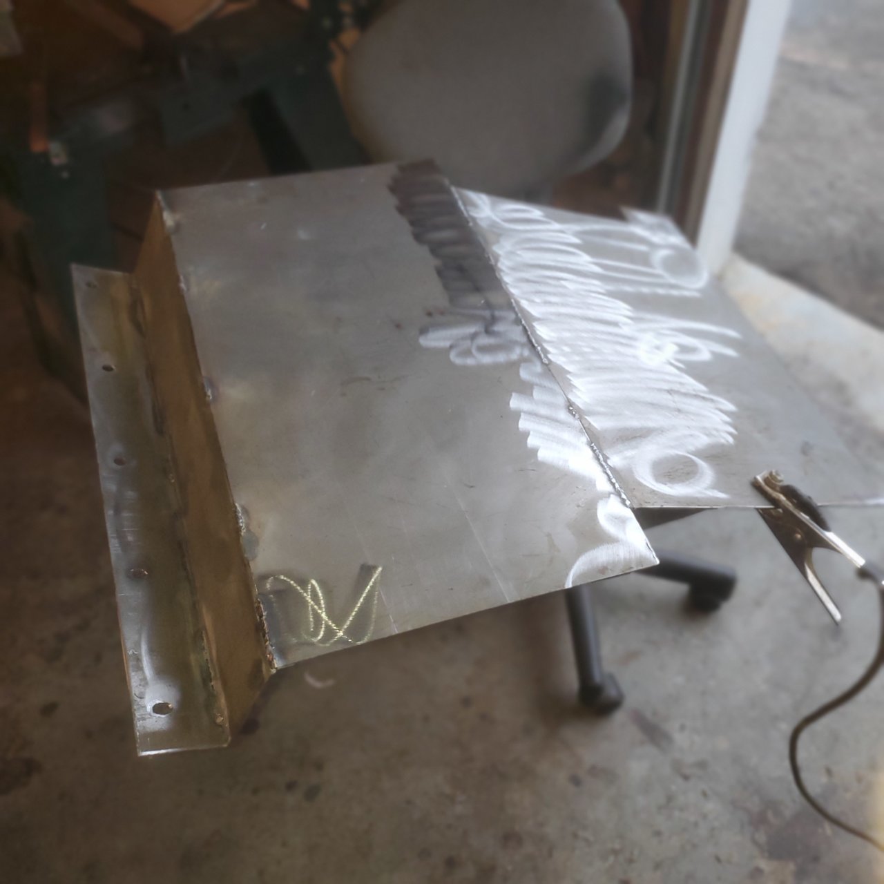

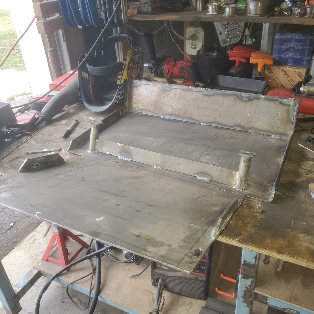

    Made a skid plate for the 02 today. still gotta paint and install
