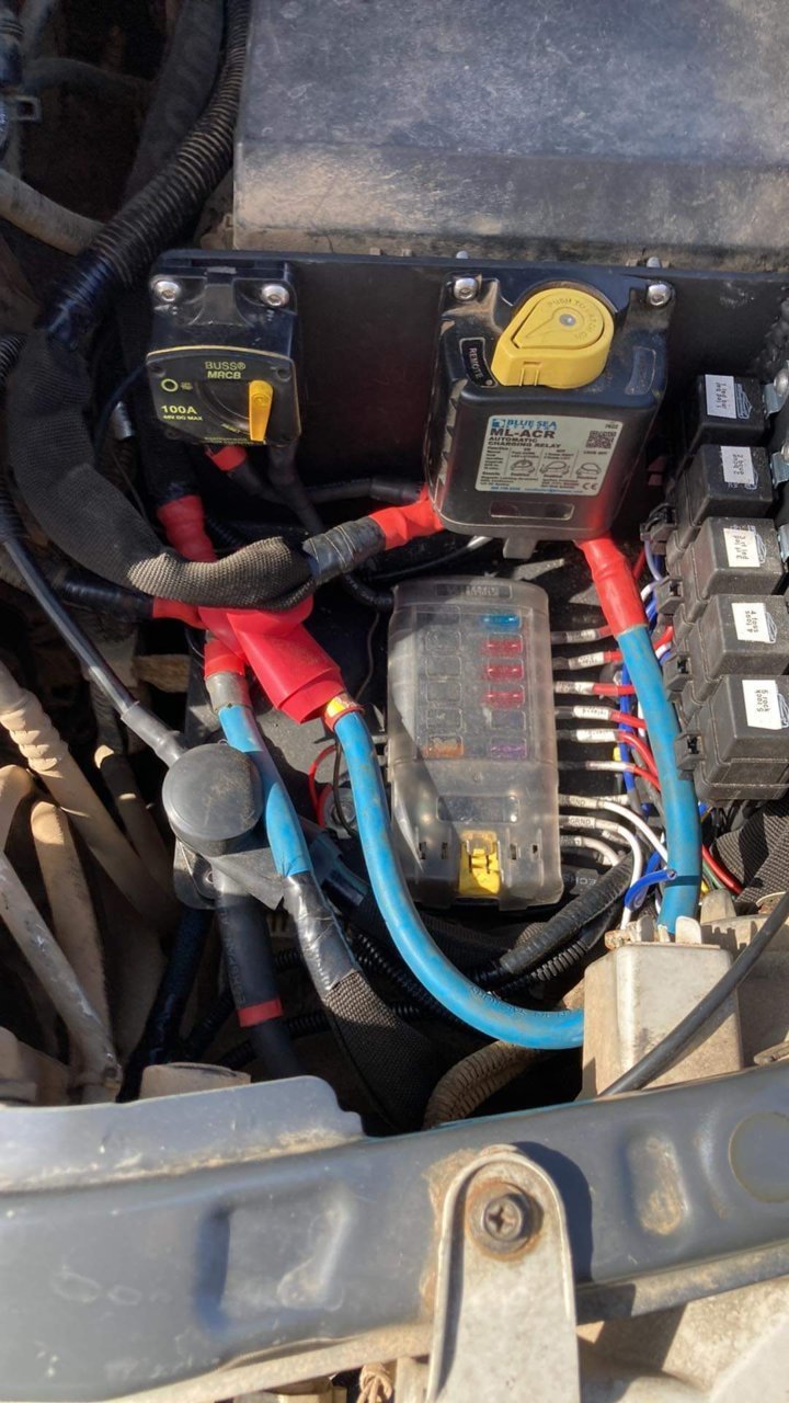

    Ill most likely be redoing my electrical but i found these
    https://www.amazon.ca/dp/B07T9G2FZF/?coliid=ILSLDSW6MRIET&colid=25UVLZVWDLOZR
    And these
    https://www.amazon.ca/dp/B08CGCWY72/?coliid=I3AKC7UEHI1E7Z&colid=25UVLZVWDLOZR
    I like the Vgates as you can bolt in ring terminals or you feed larger guage into the holes and tighten it down.
    i run a sysetm with the blue seas all in 1 unit and have a welding cable bolted to exactly where you show it, but with a stub thatbgoes to the battery.
    It may not be correct, but it works
    https://www.amazon.ca/dp/B00WM2MWQ4/?coliid=I1K6S5BX28J0IX&colid=25UVLZVWDLOZR

    That's a nice setup, very clean. I like your suggestions I'll have to put more thought into it.

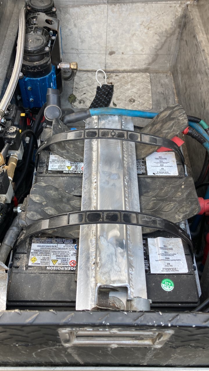

    ^Another option is bus bars: https://www.amazon.ca/Power-Distribution-Block-BUSBAR-Cover/dp/B07CCGCWKD/
    The battery tie down can loosen over time (because it's clamping down on a plastic case) and cause the battery to shift. Any wiring you attach to the battery terminals needs to have some slack to accommodate some movement, otherwise the wiring can break.

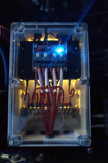

    see, it's the fuse box that's my issue with corrosion forming and blocking out the fuses. it's basically where i want to go but i want to do it with everything covered. that area is tiny to work with and ATM but plate is literally and old table saw deck that was cut up to fit....
    have a link to the project box?

    Showing off some wiring are we?
    In the process
    batteries in the bed in a modified tool box

    This the link to project box I used for my relays and some better pics.
    https://www.amazon.ca/gp/product/B07BPPJZBG?ie=UTF8
    I have the same issue with my fuse block. I have had to replace already 1x. Thinking of putting it in a project box as well.
