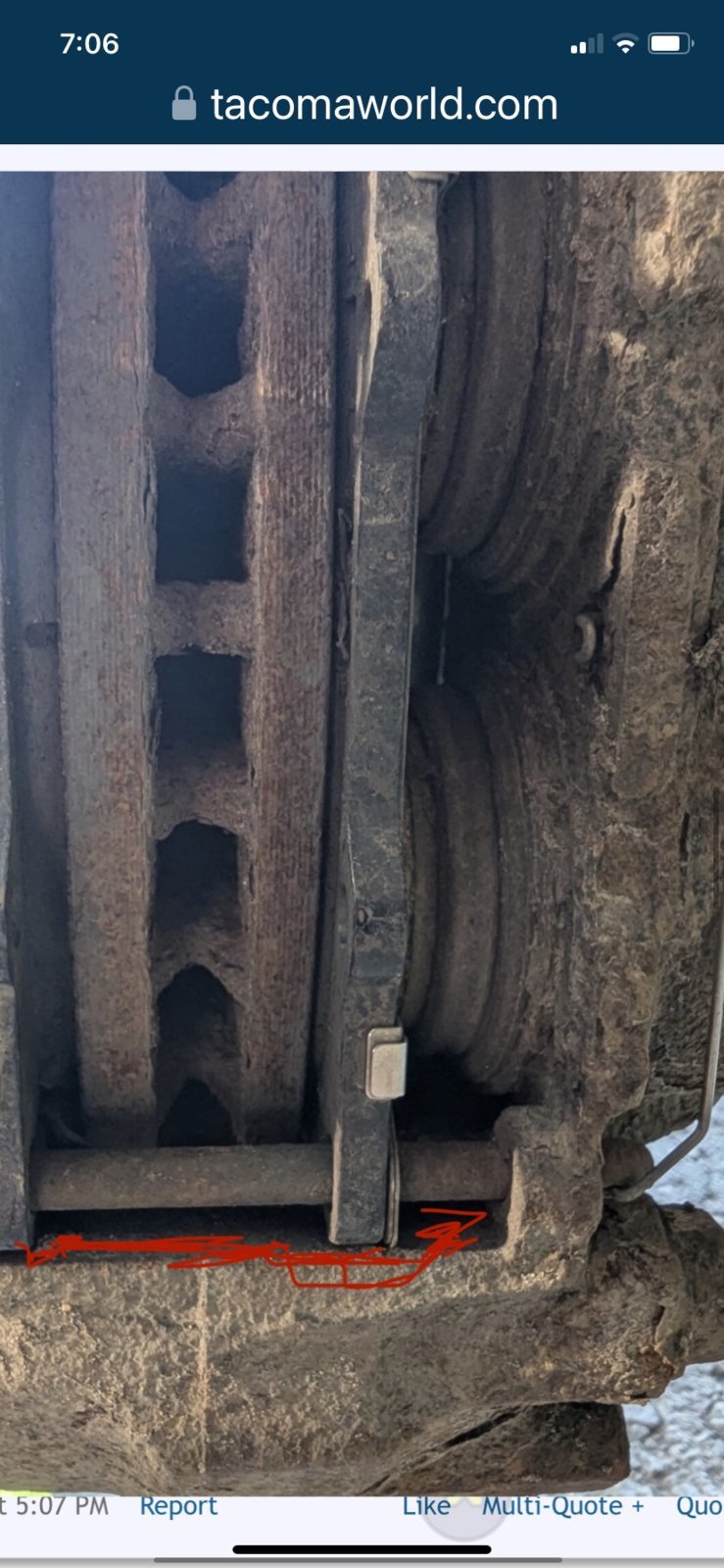

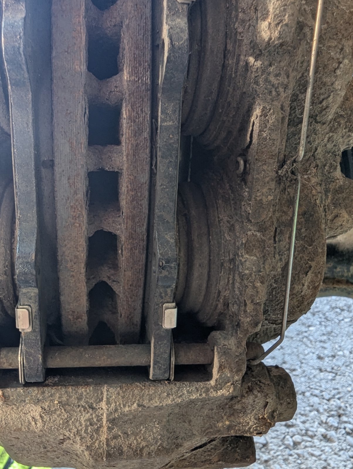

    What's up with this pad wear? Replaced at the same time not that long ago

  8. Jul 1, 2024 at 2:09 PM

    Slide pins probably sticking

    Either one of the pistons is stuck or you got some cheap china pads? How many KMs since you changed?
    Put a spring at the bottom as well, I have top and bottom springs on Yotas with this style of caliper.
    and grease the pins religiously, mine come out easy with a light touch. That’s how greasy they are.

    They're brand name. Less than 20k. Probably closer to 15. 3 are almost full. Springs have broken. Pins didn't seem like an issue but I put some anti-seize for now.

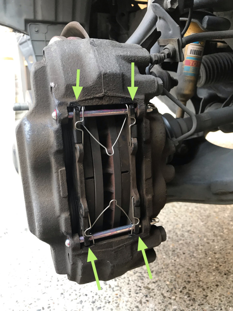

    Make sure the red area and pins are cleaned with a wire wheel and the pads move in and out of the caliper freely. I use slide lube on the end of the pads. Anti-seize will wash away.

    For the rotors I can only recommend OEM, they are not far off from aftermarket price wise and last 100K+ kms easy, I am on the 2nd set and still got plenty of life and mind you they used to stop 37s.
    for the brake pads akebono or advics are the only brands I install on my trucks.
    Having two springs also helps a bit
    And cleaning after each wheeling trip, I used to remove brake pads and clean mud and dirt and lube everything

    Blame the ADS race shocks. Your truck now chews through parts every weekend like a race truck. Better get an energy drink sponsorship :stirthepot:
    Broken spreader clip probably contributed to the abnormal pad wear.

    I just had some issues and it ended up being 1 seized caliper piston. not that that is the problem hear but If your going to change pads check them individually :thumbsup:
