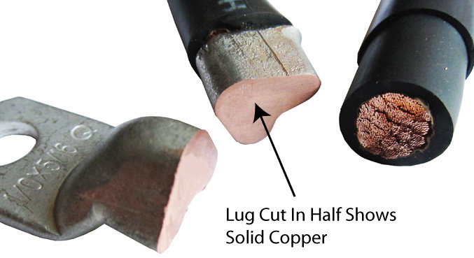

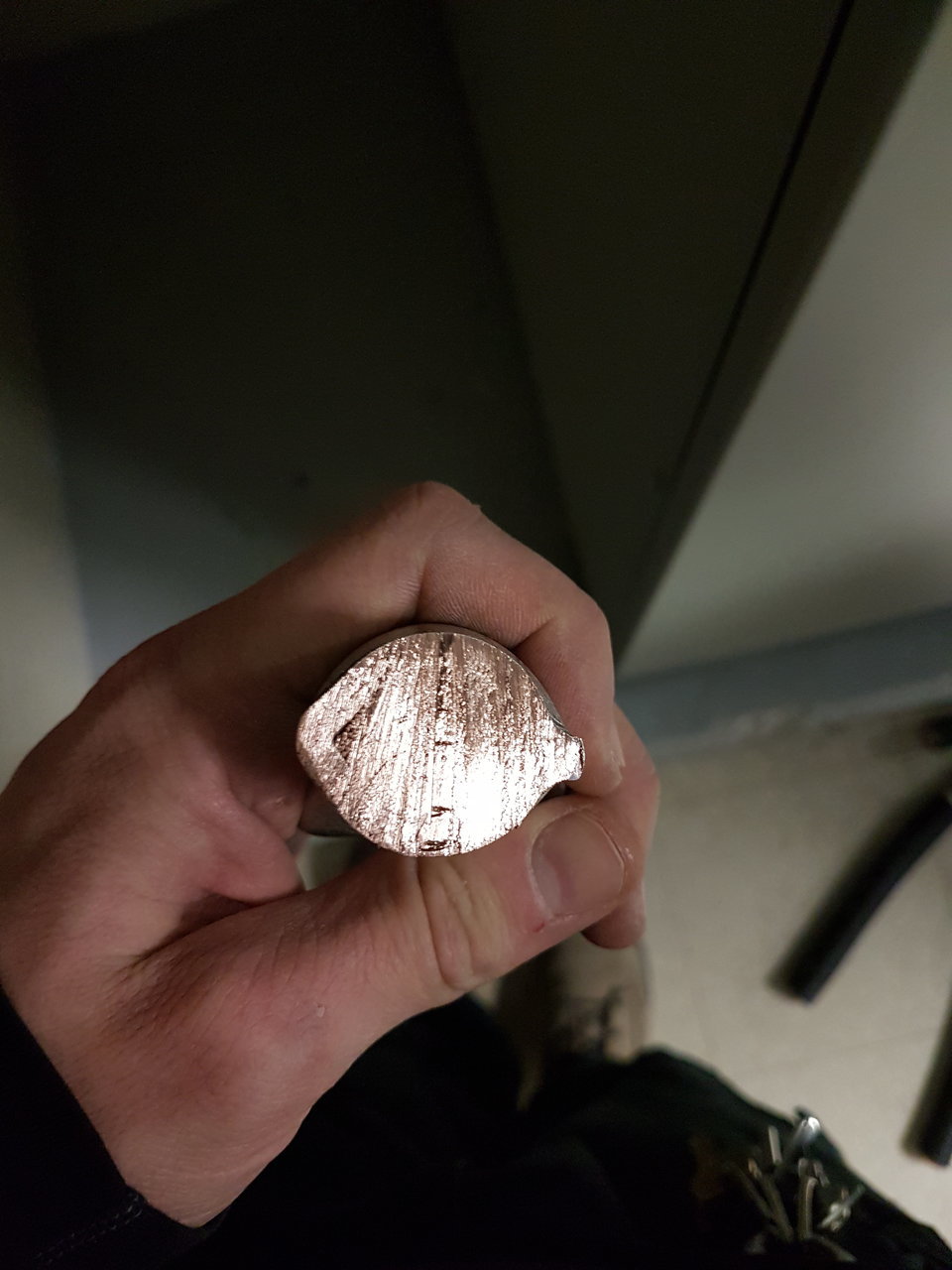

    Those are manual crimps though. Not the same as high press. High press dies are like a hexagon shape. Much better crimp.
    This is a cut open lug after high press.
    Enough pressure to turn the stranded copper into solid.

    Mmmmmm.... Solid copper.
    I ended up soldering all my connectors. More work but same effect. I like having everything I need to make custom lengths. Really comes down to personal preference I guess.
    more time + less money + custom vs less time + more money + less headache.

    In that image the copper is still stranded.
    This is fully fused

    Ya a few spots weren't good that's why we had to cut it off as redo it haha. But proper high press will be solid
