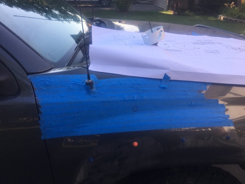

    I got a 4” hole saw. Didn’t do the donaldson but did the airflow. Pretty straight forward.
    1. Measure atleast once
    2. Cut big gigantic hole in fender
    3. Cut smaller holes in fender
    4. Install the hardest lock washers and bolts ever
    5. Read directions
    6. Fix mistakes.

    this is true
    All in all its straight forward. Think it took me 3 hours or so from start to finish.

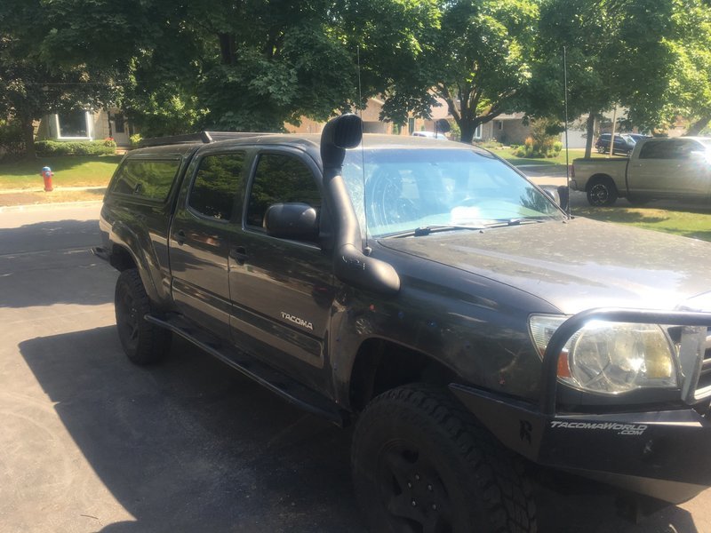

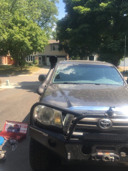

    yeah I ended up doing the velcro mod. I highly, highly suggest getting good quality velcro and clean the area as much as possible. I may end up doing rivnuts down the road. I definitely was not doing the wood screws that were given with my snorkel kit.....
    Also, on my snorkel the studs that go into the snorkel body were suppose to be locktighted in. I figured being in canada, we have the Salt and rust for that. However I am always tightening the most upper bolt as it loosens off, which causes my velcro to fail.
    Second pro-tip. Get some kind of sealant (I used plumbers putty or mastic tape I believe). I used this between any tubing joint that was held on with a hose clamp.

    I have been considering making something that attaches the snorkel to the roof rack somehow.

    ^Toyota is technically correct. Most Toyotas (including mid-engined HiAce vans) have snorkels in Egypt, for example, where it rains maybe once a year. But if you go over all the joints with sealant, it will work as a water snorkel.
    Large cushioned clamp around the snorkel tube, fastened to a steel strip that attaches to the roof rack perhaps?
