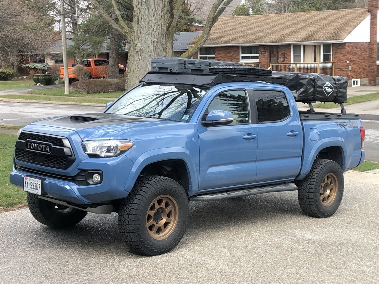

    Taco Break Down!
    2019 Toyota Tacoma
    Double Cab Short Box
    TRD Sport, Manual
    Cavalry Blue
    Interior:
    - Expedition Essentials TPAM mount
    - Ram mounts (phone, GoPro, tablet, CB)
    - Field Craft Survival mobility GoBag
    - Anytime Back up Camera with Front camera
    - OCD Center console organizer and tray
    - Custom backseat for dogs!
    - Caliraised 3 switch panel
    - Garmin 66w dash cam
    - Garmin inReach mini
    Hood:
    - Bluesea System Fuse Block
    - Sealight replacements high/low/driving
    - ARB single compressor
    - Custom compressor mount
    - OVtune -yodatune
    Exterior:
    - Ceramic Coating by Driven Autoworks Detailing
    - Vinyl Wrap-465Wrap.co
    - Frontrunner Rack System
    - Treeline Roof Top Tent
    - Prinsu Rack with Handles
    - Baja Designs Rock Lights Amber
    - Herritage TRD grill
    - TRD skid plate
    - Method Racing Wheels MR701 bronze
    - Falken WildPeak 285/70/17
    - Full spare with rim
    - Diamondback HD cover
    - Caliraised Sliders 0’ rise with kickout, plate
    - Caliraised interior LED replacement
    - Sealight LED hi beam, low beam and running
    - TRD Adventure Decal 456wrap.co
    - Mountain Hatch tailgate panel
    - Overland Outfitters Trasharoo
    - ROAM 84L case
    - Bunker Traction Boards
    Suspension: Installed by Offroad Addiction
    - Front King 2.5 coilover with Reservoir
    - Camburg UCA
    - Rear King 2.5 with reservoir
    - OME heavy duty leafs with add a leaf

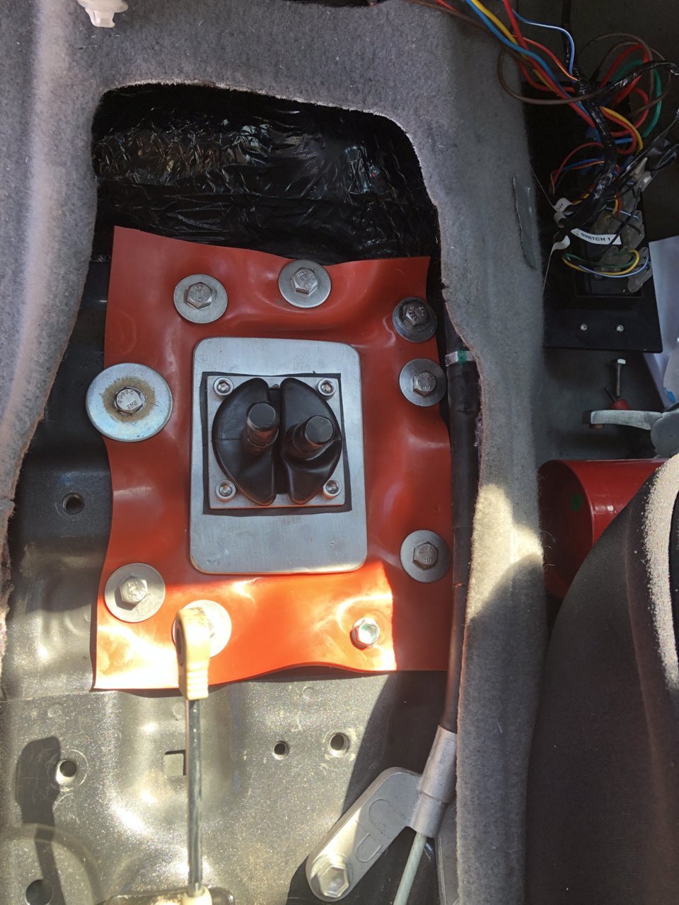

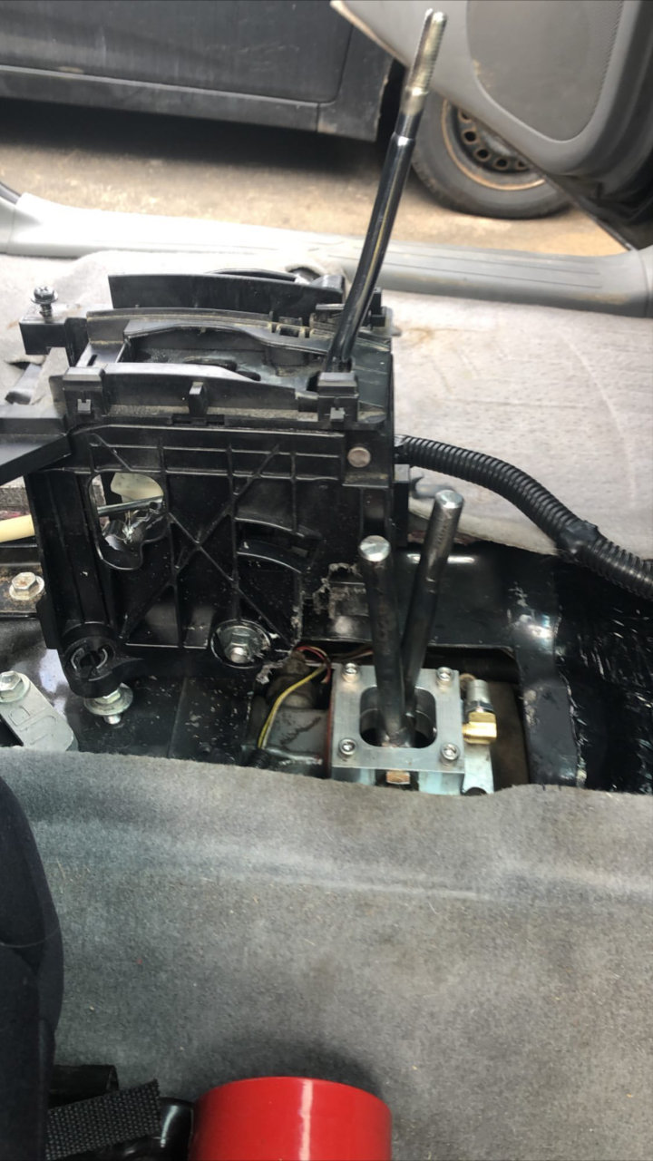

    I gotta question for Tacoma16:
    When you swapped the t case if you just left the twin stick shifter for the fj case where dose it come up into the cab.
    Eg. In a cup holder, in the center console maybe by the shifter. Just planning my next move...
    Thanks.

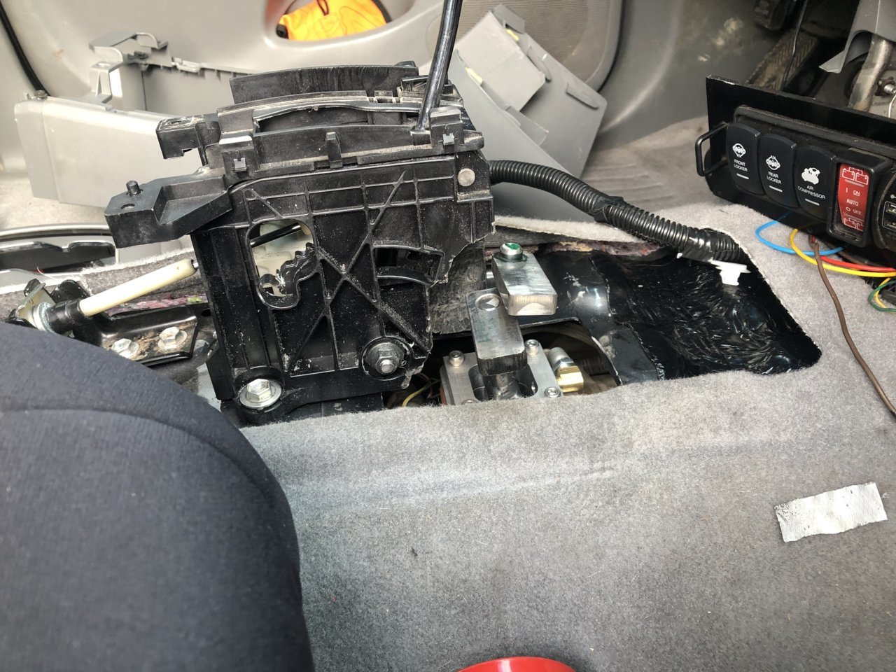

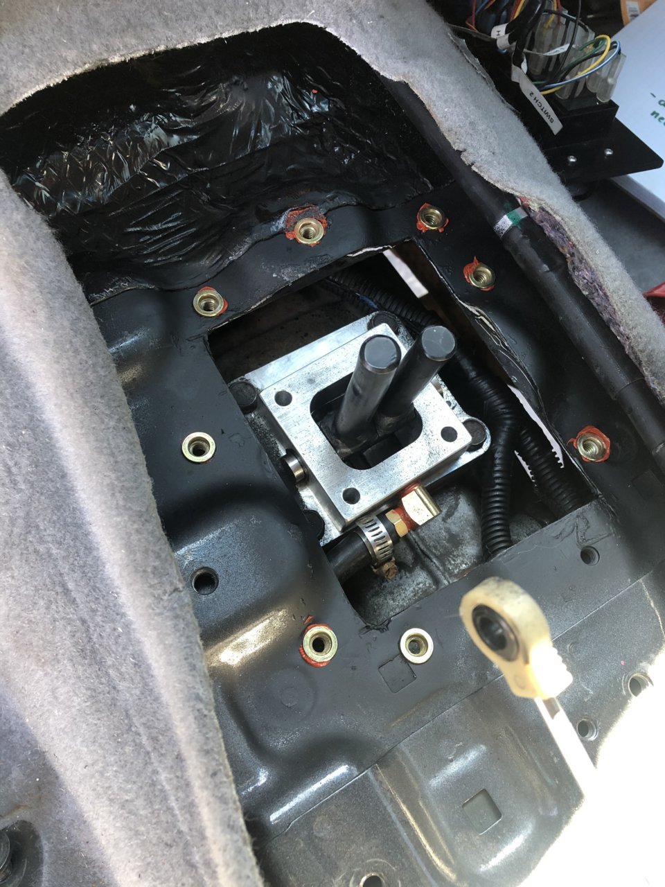

    pretty much comes right out where the stock shifter is. You can see how much I trimmed to make the twin sticks come out and clear.
    I went with the “bolt” on shifters, but I would just bend and weld them if I could go back and re-do it. It’s all bolted in anyways, so if you have to drop the case you can just unbolt the twin sticks and your good.
    Hope that helps!

    I had the tcase in and out a few times. It sucked benching it into position a couple times. Literally just put some grease on the shifters and could see where I needed to cut. I cut my hole pretty big and used a high temp rubber gasket material to sandwhich it. Drilled some hole and used rivnuts to seal it all. Similiar to a stock shifter. But uglier. Much much uglier lol
    also have a bunch of rtv under there
