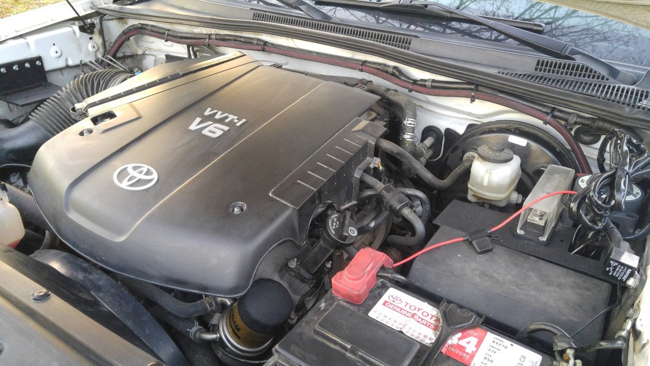

    Some people say it comes from the factory with the wrong grease and that you can add your own. Its a great little winch. But @tacoma16 and I upgraded all the wiring to a size up and relocated the solenoid to inside the engine bay

    This was the craziest winch install ever lol.

    Why change the wiring to a size up?

    The wiring that comes with a winch is only 2 gauge. It can only handle so many amps for so long. When relocating the solenoid your lengths get longer. By upsizing your allowing the winch to get the amps it needs without the resistance which causes heat. Less heat means less chance of a fire. Fire bad.
