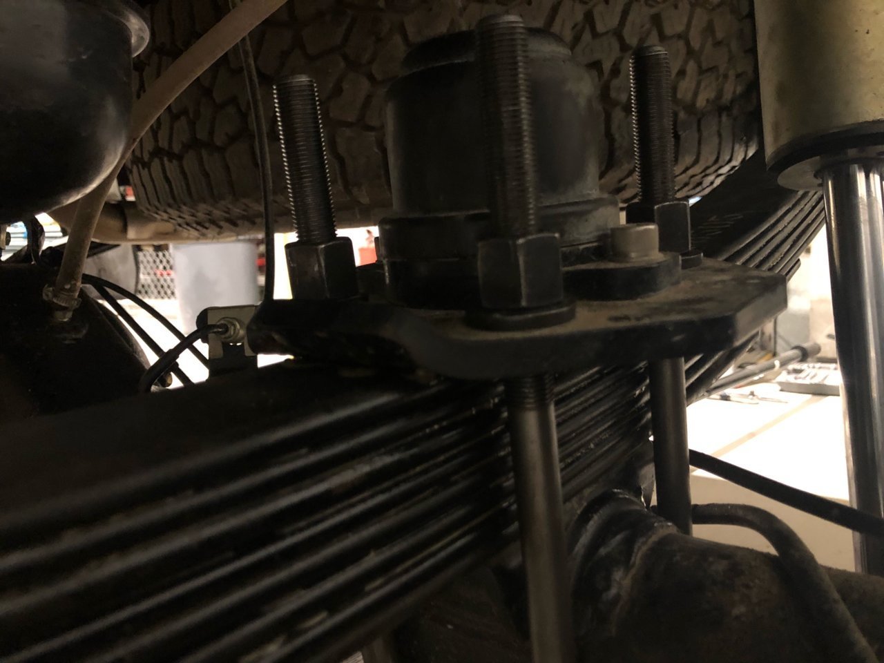

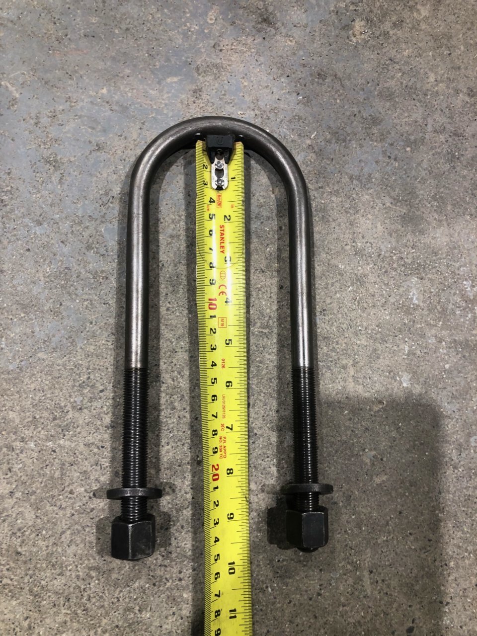

    u bolt length and a pic of them on

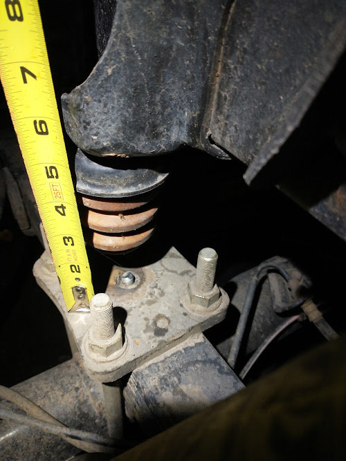

    Would be worth giving those a bit of a trim. I noticed my bolts are jamming into the bump stop mount/ stop.

    Usually cut them flush or just slightly above the nut.

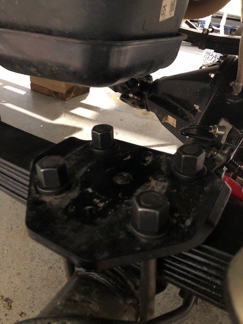

    i get them snug with a wrench and then cut off the excess thread. i dont have a 7/8 deep socket either so have to trim before final torque. once torqued i end up with about 2-4mm of thread above the nut.
    pic is before torquing and bumpstop removed. most specs say torque ubolts with weight on but since its a PITA to get in there with a torque wrench with the wheels on i just put a jack under the rear diff.
