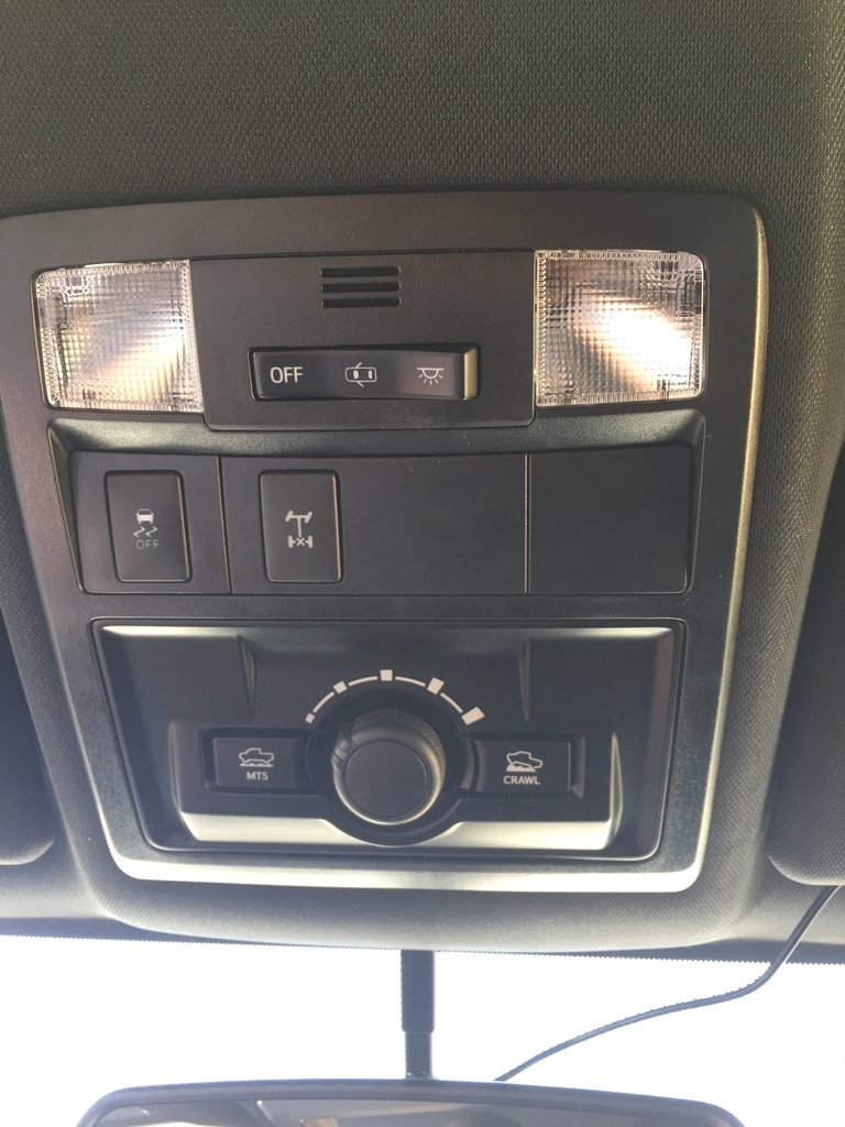

    I want to hard wire in a dashcam and need a 12v overhead power supply for it near the mirror- anyone temporarily remove the overhead switch plate to do this? How do you open it?
    You can see the wire in this photo that I wan to insert under the plate instead of running down to the lighter plug for low wattage 12 volt power. The camera itself uses 5volts, but I have a small variable voltage regulator to use for it to do the same from a 12 volt supply. Thanks!IMG_0866.jpg

    I believe the whole panel can be pried off.

    I edited the title because I'm really asking what is the best way to open it safely and where are the best pry points to open it.

    Only 4 of the red clips holding it up there. (Top of photo). Easy pulls all around, then once started give it the yank.

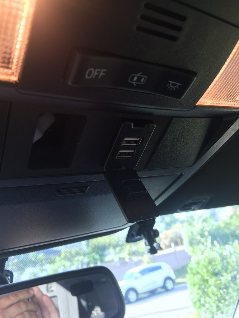

    Shape ways for the panel
    Amazon for the USB
    Just got the USB 2 days ago and haven't had time yet to finalize the wires

    You can get a panel pry bar at your local auto part store. There are two tabs in the front, and two in back. Pretty easy to pry off. I did it to install a homelink mirror.

    That's the same panel. Google shapeways promo code for a discount. They always have a code floating around.
    Amazon USB used the seller "All dazzling " however that took about 2 months to get to my house from china. Might want to find a different seller lol. The USB will sit flush once pushed in, just haven't done it yet.
    I'm also waiting for an arb fridge wiring kit to show up, then I'll dig in to the dash finding the passage ways to run the wires from hood to cab.

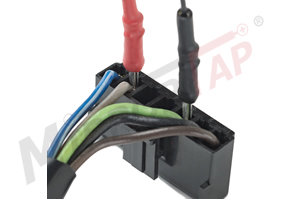

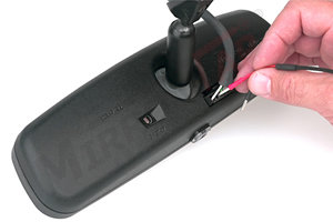

    Ok, before you pull your overhead panel to get 12volts for your dashcam, check this out. You can easily DIY it or get the needed part for $$$ from https://www.mirrortap.com/. Keep in mind in either way, you will still need a 12v to 5v regulator if your camera uses only USB power, but those are easy to find in Amazon like this one https://www.amazon.com/gp/aw/d/B00O...340_QL65&keywords=12v+to+5v+usb+adapter+cable
    0552D5E2-68BF-44CF-BD0D-44C2BB73FC30-16104-000020E6D1D26D9F.jpg 468A783B-6896-4DFB-AE1E-436E2B13C3FA-16104-000020E6CC6DC41C.jpg

    I slid my fingers under the "back" side (closest to the seats) and pulled down firmly. The whole thing popped right off.

    I ran a dedicated 12v power wire up the passenger windshield pillar and through the header. I then installed a 12v to USB converter (5v 3A) that is stickied to the roof above the headliner.
    Granted I have to pull the console out to unplug / plug in anything, I don't normally need to unplug my camera so having the hidden USB and a single wire coming out worked better.
