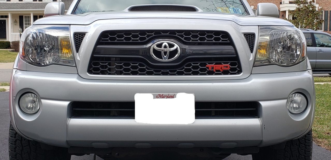

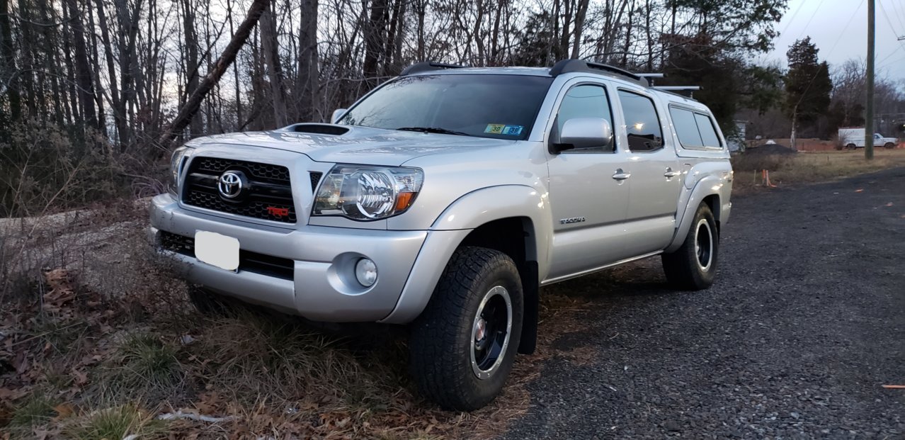

    Hey all, I just facelifted the truck over these past couple weekends! Using grill P/N 53100-04450-B0 (1E7 painted 2011 TRD grille) and the smoked headlights (81110-04173 and 81150-04173). The grille I bought new, but on the headlights I got lucky and found an almost new set on ebay for a pretty good deal. Anyway, here's the before and after shots:
    Before:
    After:
    Next I'm going to add a factory roof rack I picked up used, and touch up the paint on the hood scoop plastic which is very faded. I'm pretty happy with the look of the front end now, but I still need to do something about the fog lights. Considering a yellow lens option to make them pop a bit. Any recommendations on yellow fogs?

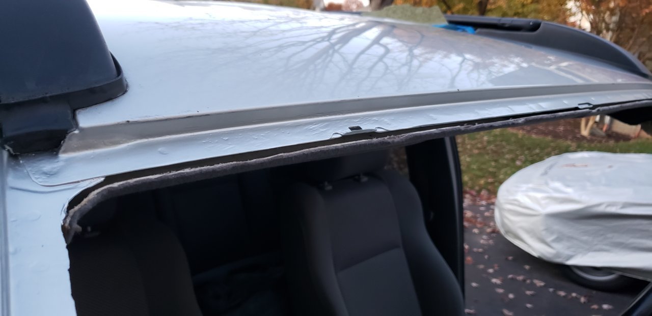

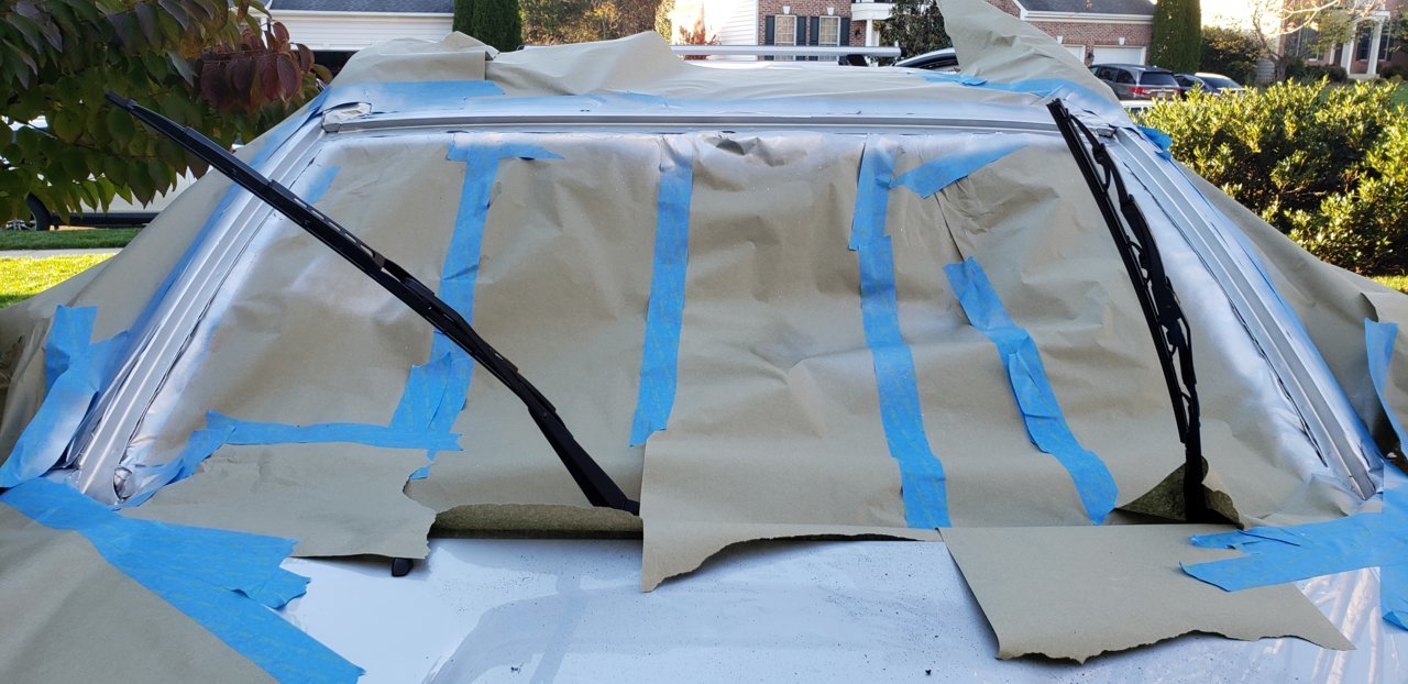

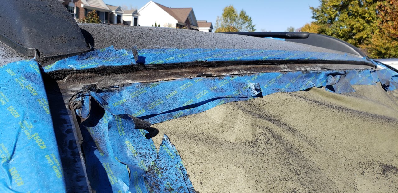

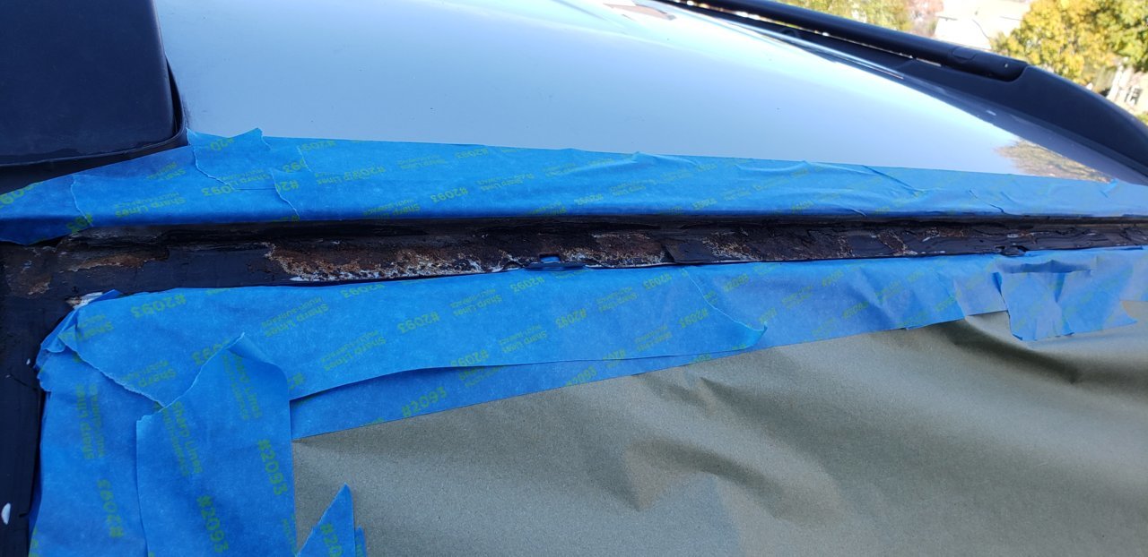

    So it's been awhile since my last update. Since I bought the truck I noticed a small interior water drip leak from the headliner in the front, and sometimes the grab handle bolts on the A-pillar. I had this same issue on my other car, and it turned out to be an improperly sealed windshield. So I parked it somewhere I could work on it, and called a mobile service to come replace the windshield. Sure enough, they pulled the old windshield, said it was too rusty to but in a new one. So I masked up the cavity, wire-wheeled and ground the old sealant/rust off, primed, painted, and cleared the windshield frame. Then the glass service came back and installed the new glass. Since then, I haven't had any leaks, you can see pictures below.

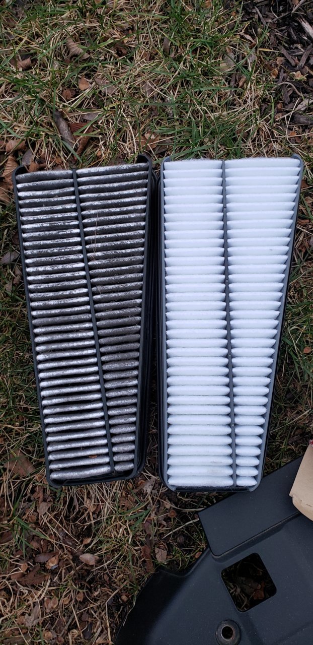

    Also, today I changed the spark plugs for the second time. I bought the truck with ~161k on it and immediately replaced the plugs. Now I have ~201k on it, 10k beyond the recommended 30k interval. The 40k mile plugs looked great, nice brown with no soot or lean evidence, but the gaps were all around .048", bigger than the .044" max spec. My air filter also looked new when I changed the plugs the first time, and as you can see from the pic, it needed to be changed. With the new plugs and filter it runs great, and seems to idle better.
    Old rust, bad on the sides too:
    Partway through the grinding:

    Old vs. new air filter

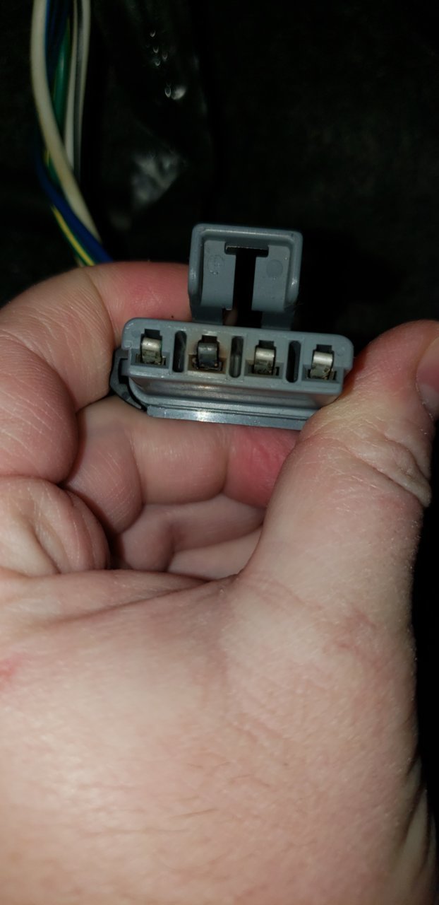

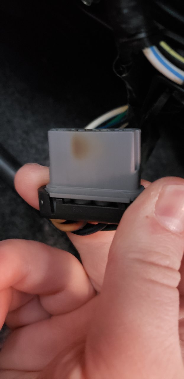

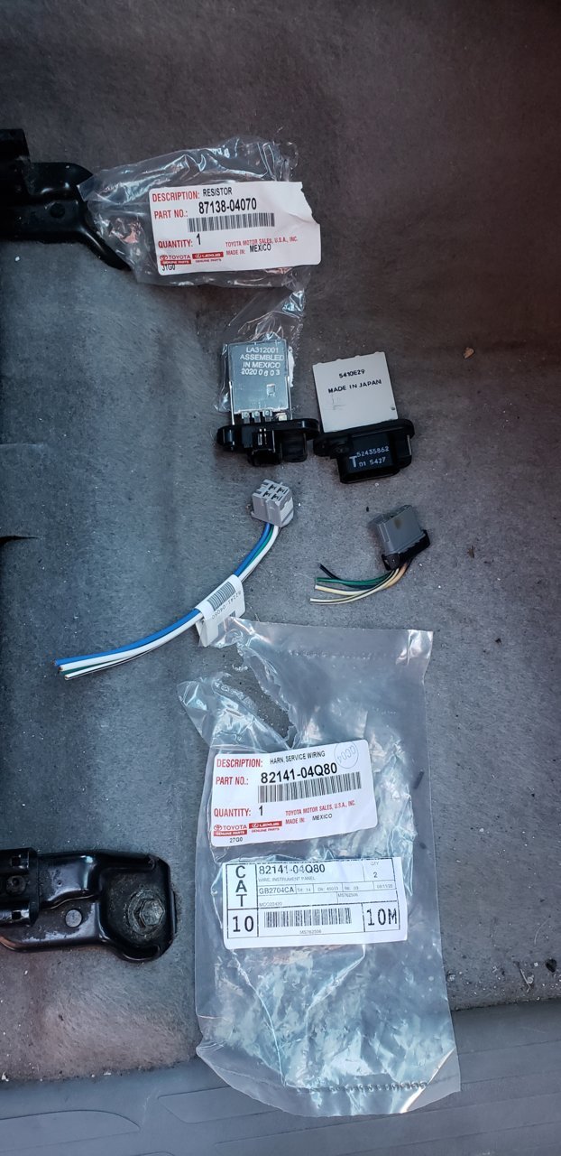

    Well I have another small update. last week I noticed that my cabin blower fan was only operating on the highest setting. After some searching on TW I found some helpful threads. The main issue with these is the connector to the blower resistor. Over time one of the wire connections degrades and causes excess heat in the wire, probably because it is improperly sized. You can see the burn mark on the connector in my pictures below.
    There is a Toyota TSB for this, but at this point the TSB lists connector/harness P/Ns that are no longer available. If you have this issue, you will likely be buying both a new resistor (87138-04070) and connector/harness 82141-04Q80) (these are 3rd Gen Tacoma parts). You can also get the Toyota crimp connectors (82999-12030) or just get your own. I found all of the above OEM parts for about $57 online, not too bad. The following thread has the correct method for joining the new connector wires:

    New vs Old:
