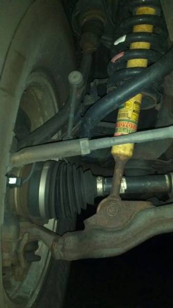

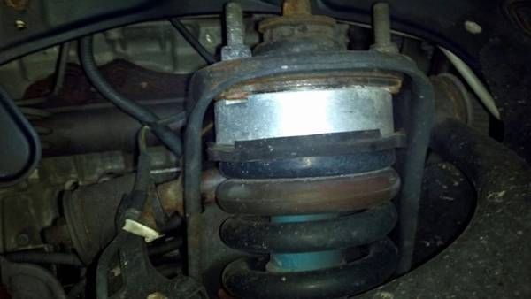

    That looks dangerously like a spacer lift on stock TRD front struts. I would recommend getting a true front suspension lift with springs that can handle the weight before getting a plate bumper.

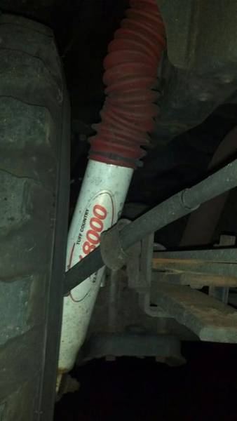

    Thanks guys. It is a spacer lift, unfortunately. Thats what that little reflection is in the picture. Any suggestions?
    Here is the spacer shot...
    And here is the rear...
    if you replace the front do you need to do the rear as well?

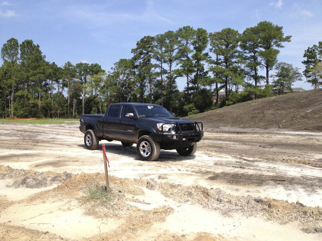

    I have an ARB with a spacer lift and it sags a little bit. Hopefully I will be able to replace the suspension this month, but I have been running it like this for two months now 5K miles and no problems. No, you don't have to do anything to the back if you change the front. Those Tuff Country shocks look a little old, so maybe in a couple months, you might change those out and stick a TSB AAL in there from ToyTec: http://toyteclifts.3dcartstores.com...af-for-Tacoma-with-rear-TSB-springs_p_16.html
    I just have a block in the back of mine. I am wanting to replace it with an AAL or Dakar leaf pack in a few months, but right now my funds are going more toward getting the front upfitted and a Remington 870:D

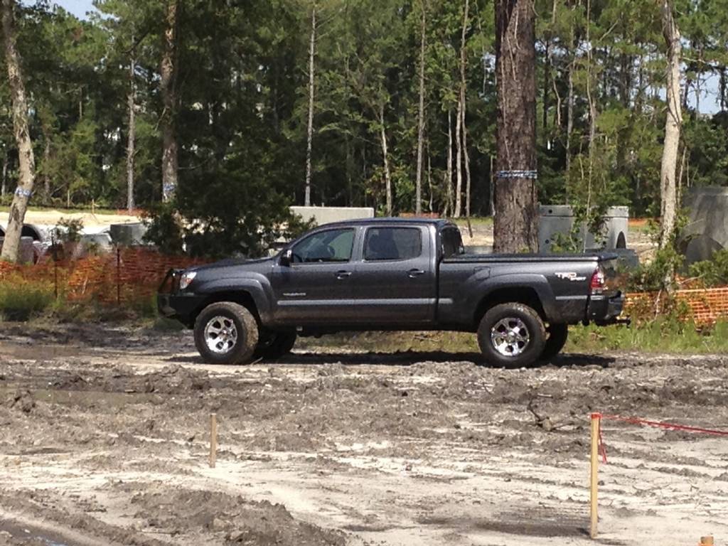

    Here is my truck as it sits now (I am running 285/70R17):

    Nice truck man, i really do like that ARB bumper. It's going to have to be a choice for me, either the bumper or correcting the suspension. The latter would probably improve the ride quality I have now. the good news is I got a good price on the truck, the reality is it's because I didn't know any better so now have to improve it.
    These are the leafs which to me also look a bit odd..
    i'm thinking a complete suspension overall would be the smartest option right now, especially if I plan on doing a x-country trip...

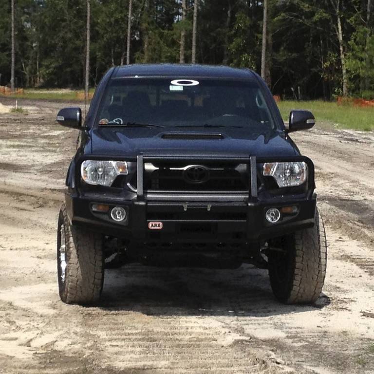

    I have the ARB w/winch on a spacer lift and desperately need to upgrade the suspension. I can live without it, but it sure rides like crap compared to stock. Love the look of an ARB though.

    Thanks man!... I love your truck, but unfortunately, I am going to have to agree with you: Your suspension looks like it could use an overhaul. I would recommend doing the complete OME kit with the 886 coils and a trim packer (gets rid of the driver's side lean). If you're ever planning on getting a plate bumper or a winch on there, just go ahead with the 886s - they'll ride rough at first, but once you get some weight on there, it'll be great. I don't have them on mine, but I have ridden in Sandman614's Tacoma, and it rides like a dream.
