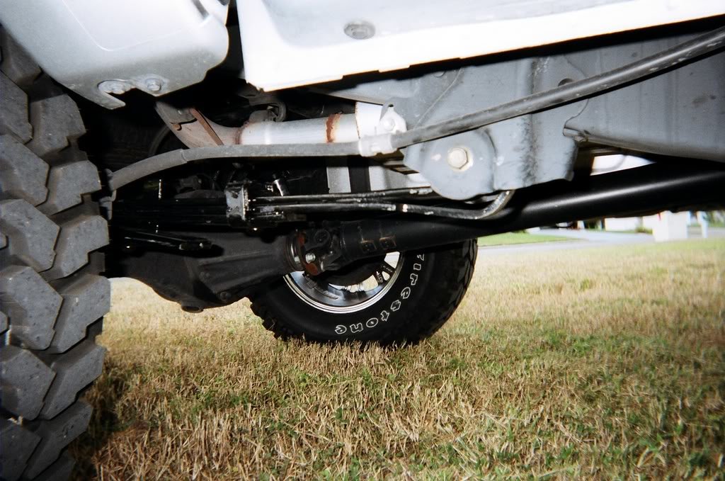

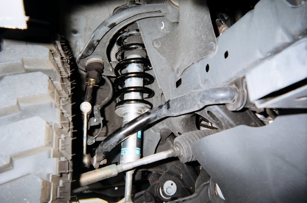

    you mean this one? 29740026_55588ccfa8cac9d9f57a81af92cbd8f7ee725055.jpg [​IMG]albums/dd172/sicktaco727/29740025.jpg[/IMG]29740025_878a0bb38caa3f1fa6c3394d4adb19dfb509632b.jpg
