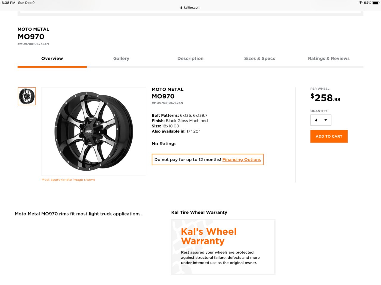

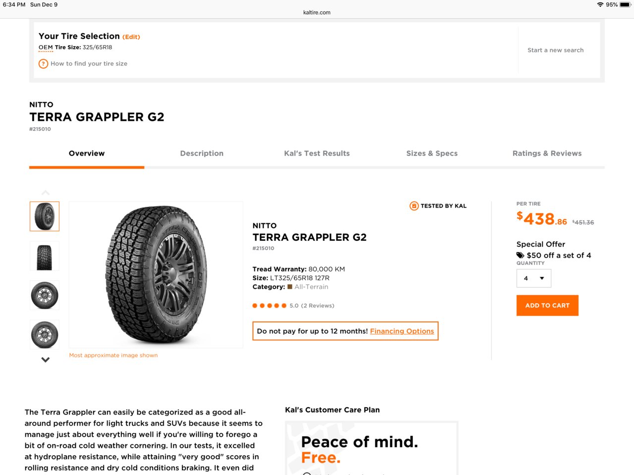

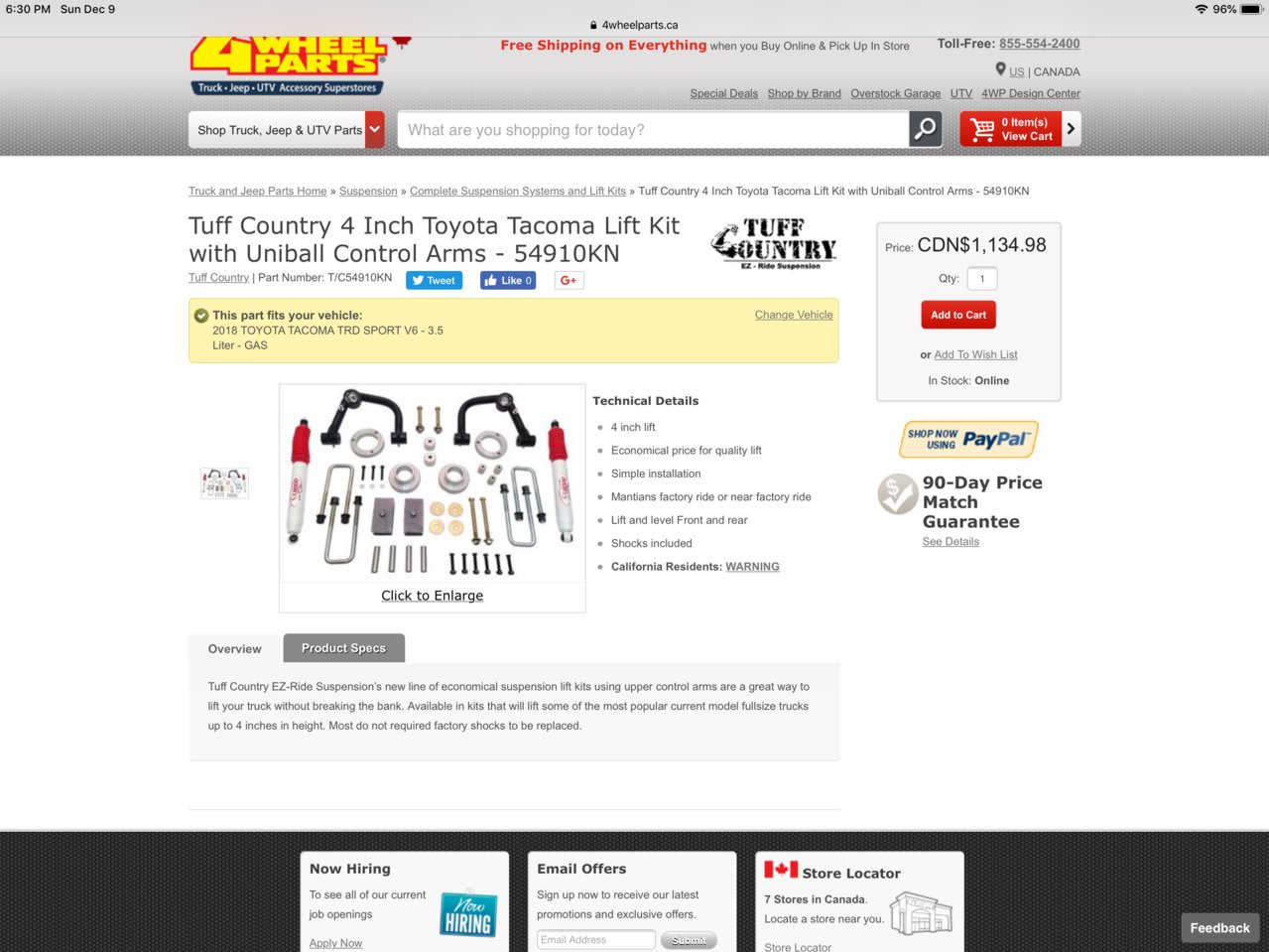

    Going with 4” lift 33x13x18 Grapplers. 18x10 wheels with -24 offset. My concern is how much trimming if any with this offset. How much poke I will end up with. Anyone foresee any complication with this?

    That’s a pretty wide setup. - offset with the 325 wide tires is going to be challenging.
    Here’s a calculator 3.4 inches further out then stock plus the tire width difference.
    width difference of the tires of 1.2 inches per side. So it will stick out pretty damn far.

    Aside from the $4,000 in expense? No.

    Looks like it’s in Canadian currency which equates to about $3000 US dollars. He could still do better for sure.
