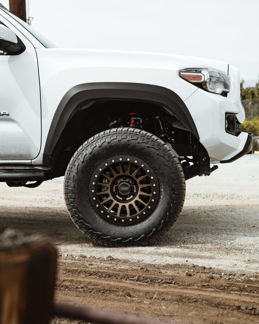

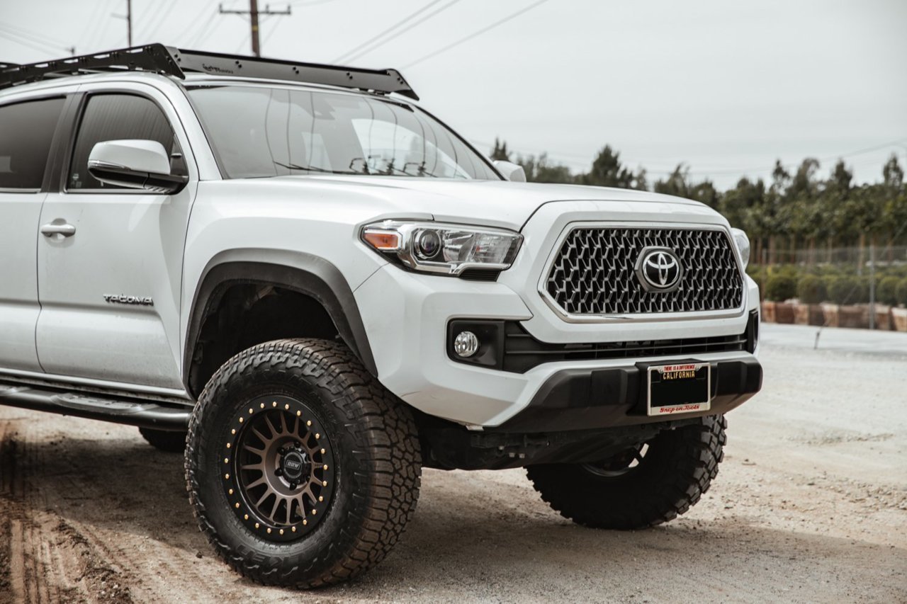

    What lift, re-gearing do you guys recommend if I want to run some rrw rr6-h wheels with 35's ?

    You'll need a BFH and 5.29s. A typical lift doesn't determine max tire size.

    The tires on that look cool. Does it have Maxtrac spindles or is not that high? I can't see see any CV axles but they might be there.

    All you really need are adjustable coilovers in front and an add-a-leaf mini pack to get enough room to clear 35's at ride height going straight.
    To get the ride height you want and tires to clear whilte turning you'll have to turn the wheels and see what needs to be moved out of the way.
    But to really get a functional setup you need to remove the coilover, lift the wheel to the bumpstop, and turn the steering wheel to the locked position in each direction. Whatever is in the way needs to get removed via hammer, tubbing, etc.

    too much offset. Tires are too big and it doesn’t like like rock crawling is in that vehicle’s future.
