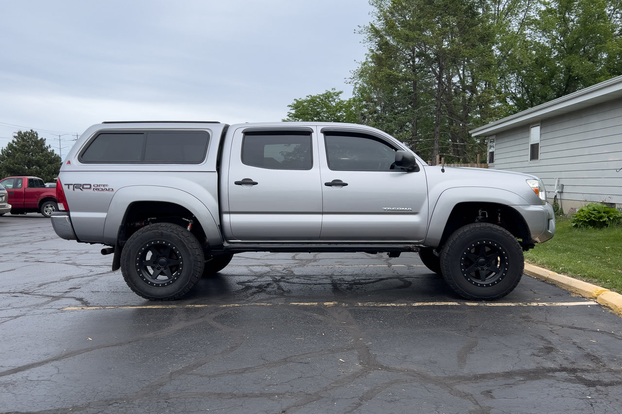

    Ended up going with Fox Performance Elite 2.5" + 600lb springs in front, and the same Fox PES 2.5" shocks + Deaver U402 Stage 2 leafs in back, along with an Archive U bolt flip and yellow bump stops. Has worked out very well so far. Not quite perfect yet but that's just fine-tuning everything to how I want it. I have plenty of details in my build thread starting at post #115 if you want some additional reading.
    Here's how it looked right after installation. I adjusted the front preload down a little so it had a tiny bit of rake, then the coils finally broke in and now front is down a little further. I was waiting on installing other things like bumpers and skids and then I'll tweak the preload again to get it where I want it. Overall about 2-2.5" lift both front and back. Deavers gave more than 2.5" lift even with camper shell and custom drawer/platform system but now after then are worn in I love how they ride.

    Looks sharp, are you planning on adding bumpers down the line?
    wi_taco[OP] likes this.
  15. Feb 20, 2023 at 1:25 PM
    wi_taco
    wi_taco [OP] My skid plates give rocks taco flavored kisses
    Jul 20, 2020
    #335129
    4,115
    Adam
    SE Wisconsin
    2015 Toyota Sienna with rear locker
    Thanks, yeah I already have a rear bumper (pending paint & install come springtime), and will be adding a front bumper + winch + lightbar in the future.
