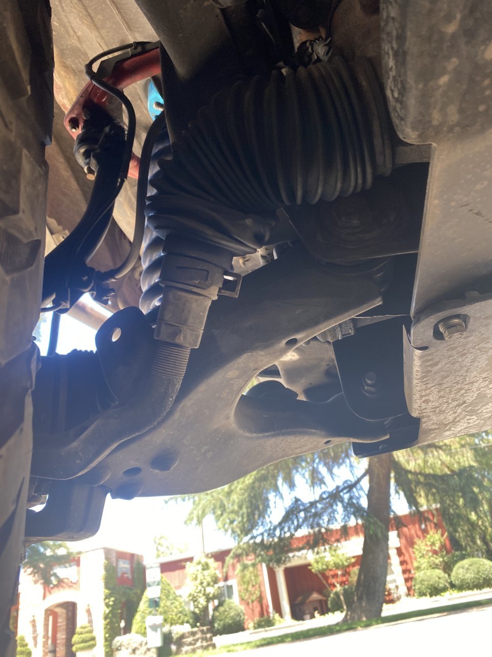

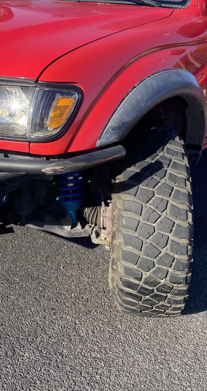

    E0D59802-E397-48AD-9917-6263CDCAA4E8.jpg What do you guys think I need from just pictures?
    I was hit by a vehicle that was illegally in my lane over a double yellow. Waiting for insurance. But really itching just to fix it my self. I’m thinking new tie rod and maybe axle. My brake lines are good no fluids anywhere. Hoping my frames not tweaked and my rack is okay. My bumper and tire took all the hit. F6C05535-E914-4377-8FA3-B9EB224455EA.jpgB2B3E2A2-1621-4BF5-A1D1-1A4C44F34E39.jpg

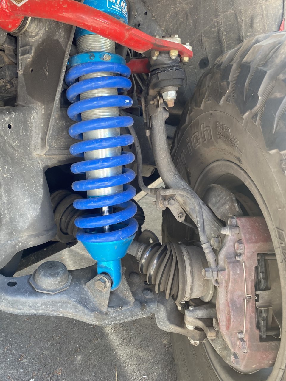

    Aslong as the LC mounts arnt bent should be an easy fix. Looks like you just need a new tie rod and CV.

    Steering rack definitely might have some issues now

    Im expecting it. Haven’t takin the boot off yet but it looks fucked beyond the tie rod

    Yeah I'd get that looked over by a shop at least, then decide what you want to take on yourself. Have them make sure the frame's not tweaked. Good chance your spindle and arms should get replaced as well, if they got tweaked at all you'll never get a good alignment.

    Ya know.. with as much as everyone points to the LBJ as the weakest link in the chain, I'm surprised that it survived... But I also wouldn't take any chances and replace it as well.

    Yup, that shock tower might have gotten tweaked too,
    It doesn’t take much to throw out an alignment

    Upper control arm
    Lower control arm
    Lower ball joint
    Tie rod
    Steering rack
    CV axle
    Spindle
    All those items are possibly compromised; you didn't ask to get hit so fuck it, let them cover it all if you feel it's damaged now.

    To add to the list of what others have said, your steering rack could be suspect, too. Basically everything is suspect.
