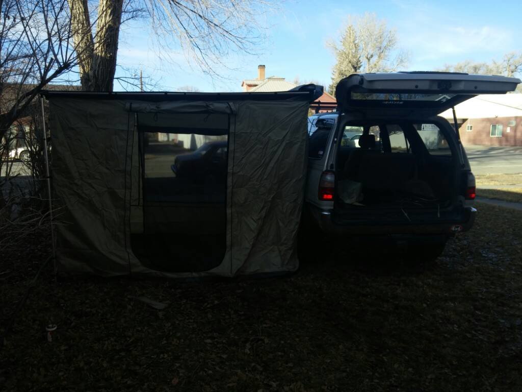

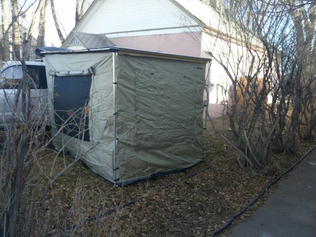

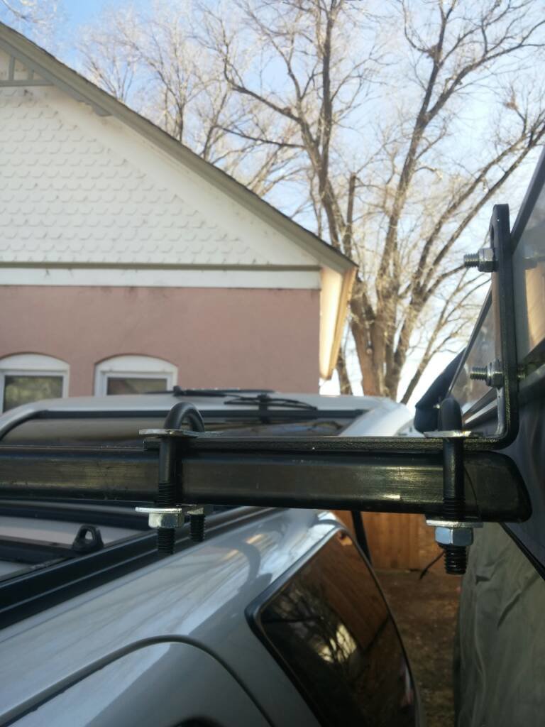

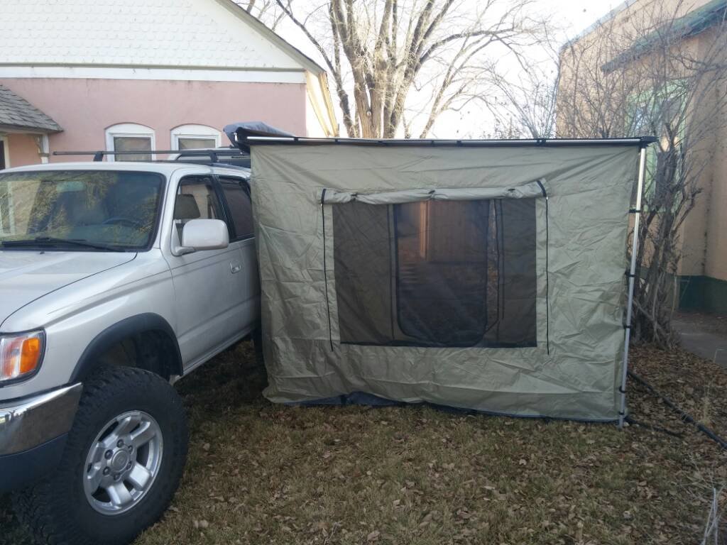

    Powder coated some of my awning hardware today, learned a lot.
    Put the awning up with the ARB room I got today. I am excited to go camping in this thing. I can almost stand up all the way. Great place to get away from to bugs or the sun for a little bit. Lots of cool little features!

    Love it! how much did it run you?

    I paid $350 for both. Autoanything had a 20% off sale. I think normally the room is $135 which honestly is a steal...

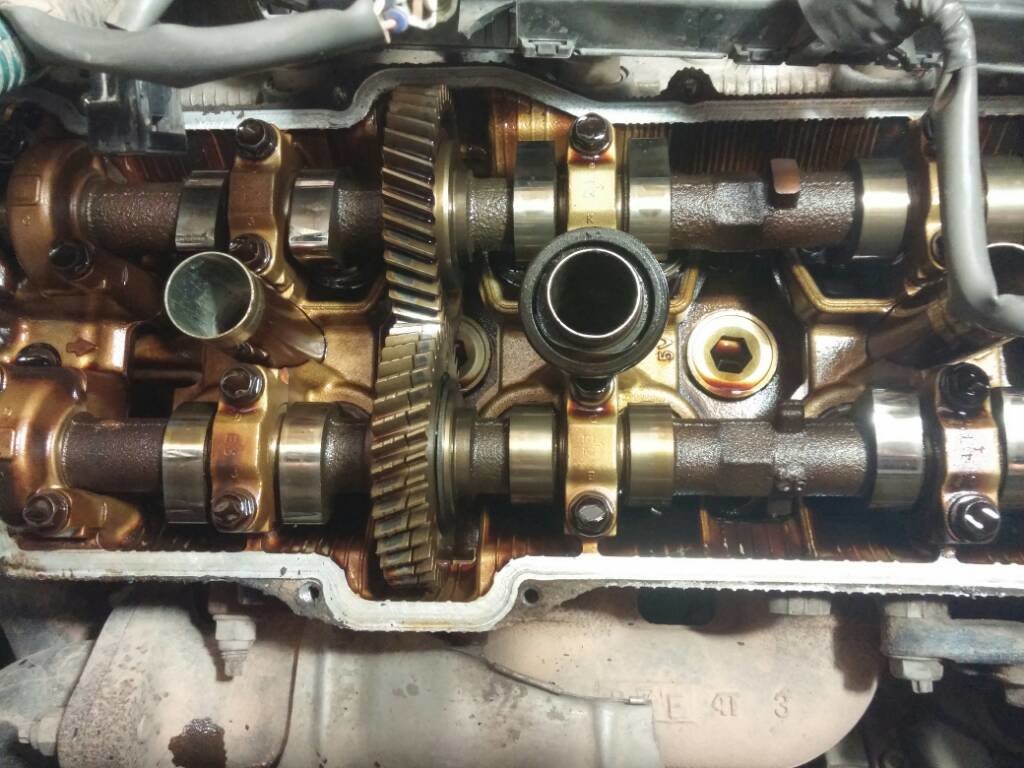

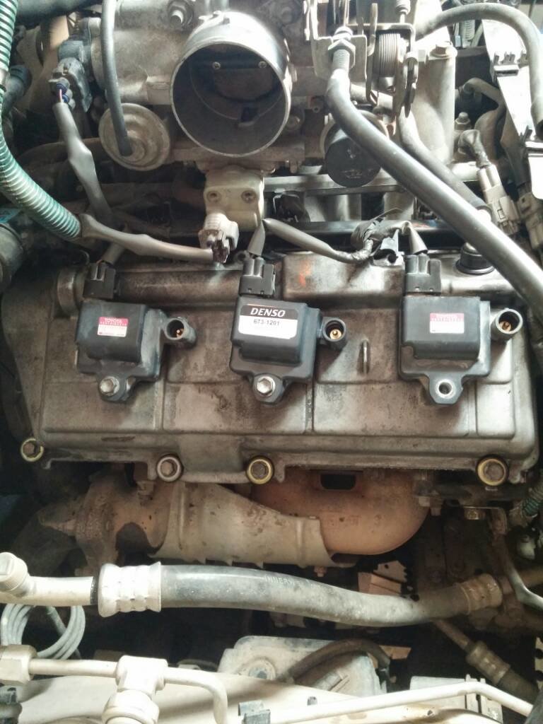

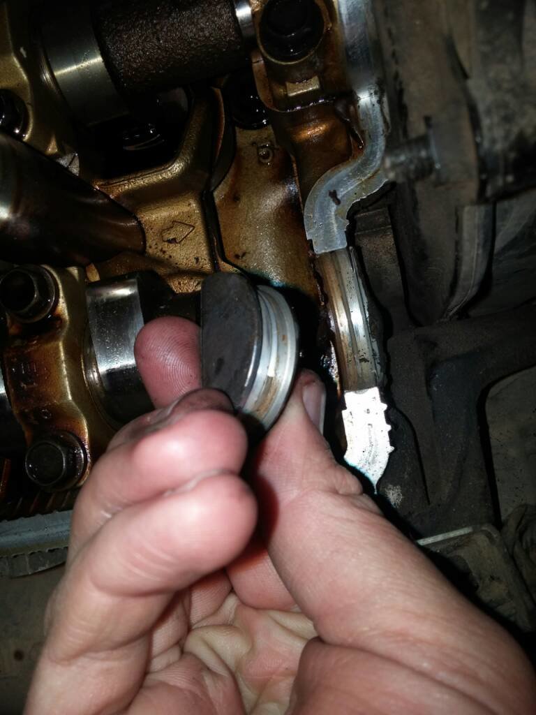

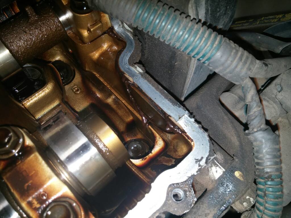

    Tackled the passenger valve cover gasket yesterday. Also trying to diagnose a super annoying new auto shutoff my engine has decided to have. 100% my fault, water etc. One of my spark plug tube seals was gone, and after installing new ones I can see how they get messed up.
    I got 2 new gaskets, 6 spark plug tube seals, 16 washers, a pcv grommet, a coil, and some copper RTV
    Coil:
    http://www.amazon.com/gp/product/B002Y39NFY?psc=1&redirect=true&ref_=oh_aui_detailpage_o00_s00
    Gasket Set:
    http://www.amazon.com/gp/product/B001G6GY8Y?psc=1&redirect=true&ref_=oh_aui_detailpage_o00_s01
    Not bad for 202k!

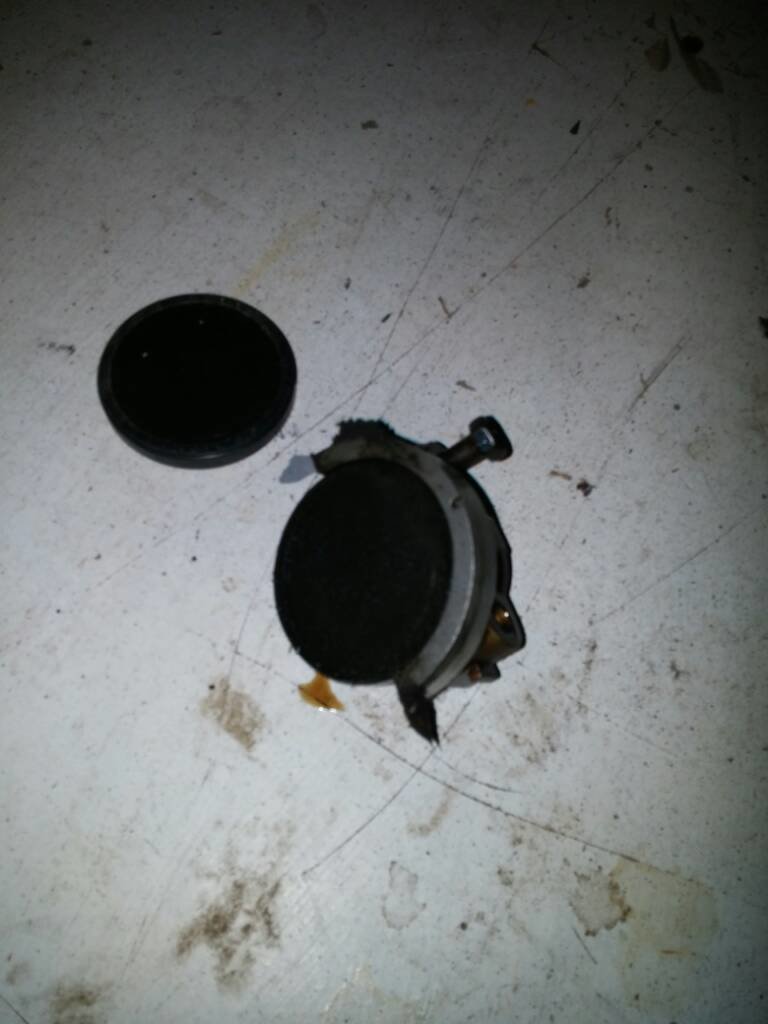

    So here you can see the half moon plug on the front. There is a matching one on the back.
    Grab a pair of pliers and pull straight up.

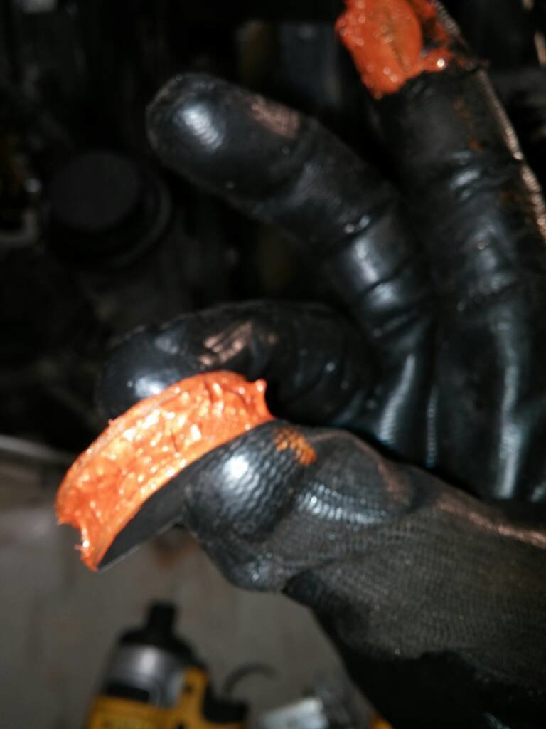

    Clean and apply RTV. I used a ton, I don't want this shit leaking!
    Push back in and clean the excess.

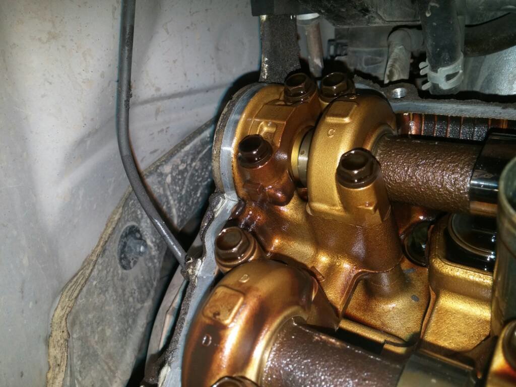

    The full plug is the last set of bolts on top. Comes off pretty easy. Tighten back to 12ft-lbs
    The old one with the bracket. Could have reused the plug, but I had a new one.
    All sealed back up. Took about 3 hours. The worst parts were getting the spark plug seals in and out. That alone probably Took an hour. Nearly impossible to get lined up without screing it up and dropping bolts in places you can't reach! I tightened the VC bolts to 54in-lbs.

    you forgot a bolt ;-)

    I know! I dropped one of the VC bolts and it went into the black hole. The bolts that are on the coils are the same as the VC. I eventually found it sitting on top of the steering rack. All good now!

    So there is four half moon plugs? one on each side?
    Also, that full plug comes out when removing that bracket, or does the bracket come out first, then the full plug?
    is it just ONE full plug?

    Each head has 2 half moon, and one full circle plug.
    The half moon is held in with RTV from the factory.
    The full moon has a bracket. I put RTV on the edges to have a better seal.
    The engine has 2 full plugs, and 4 half moon plugs.
    Better?
    I will try to take more and better pictures of the other side. I still have to drive to work every day so I have to take this project in chunks.
