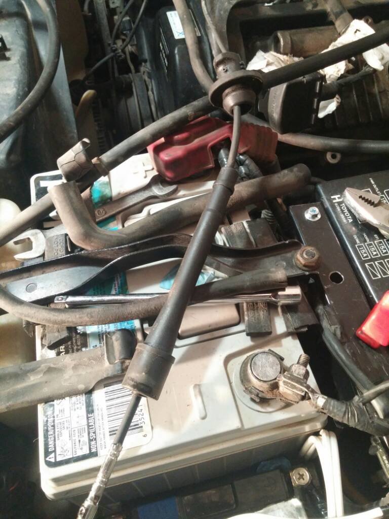

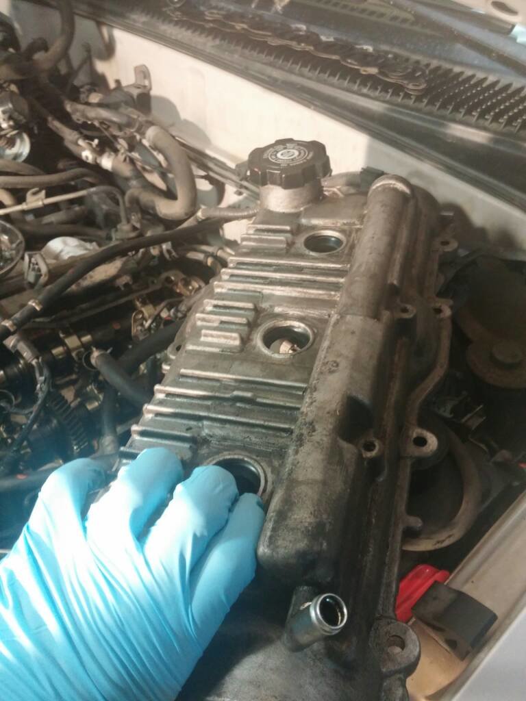

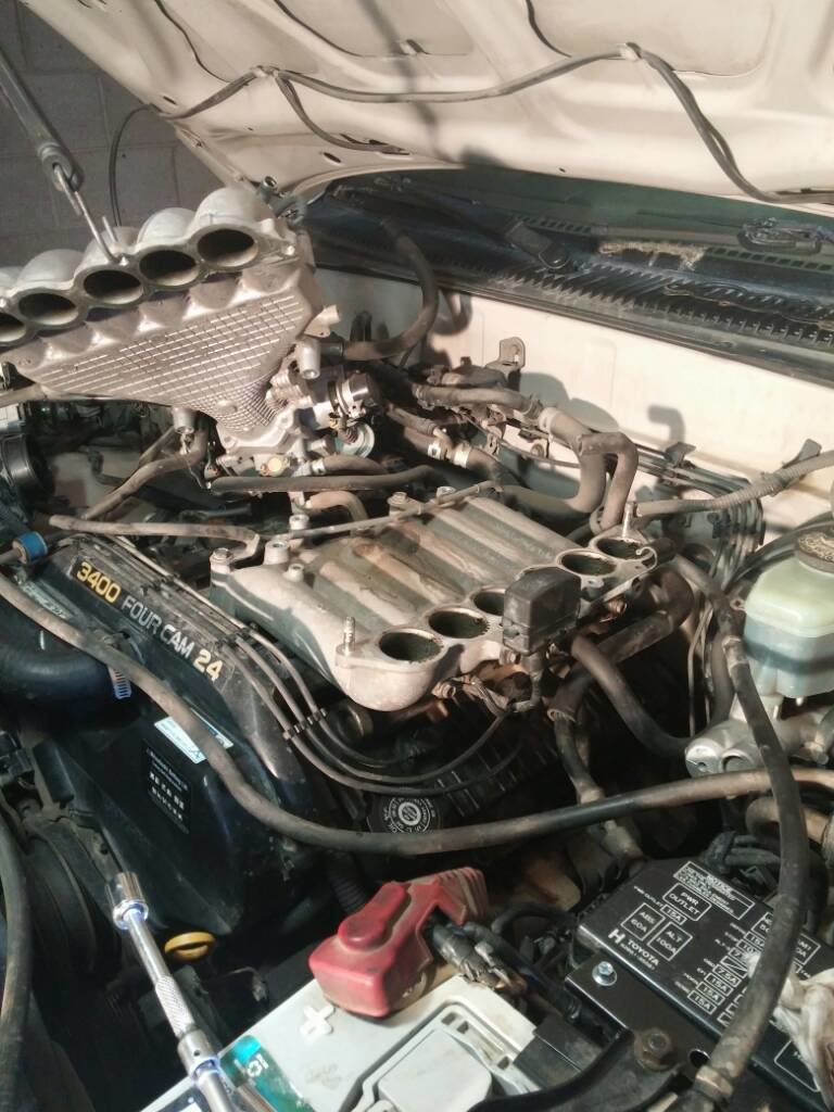

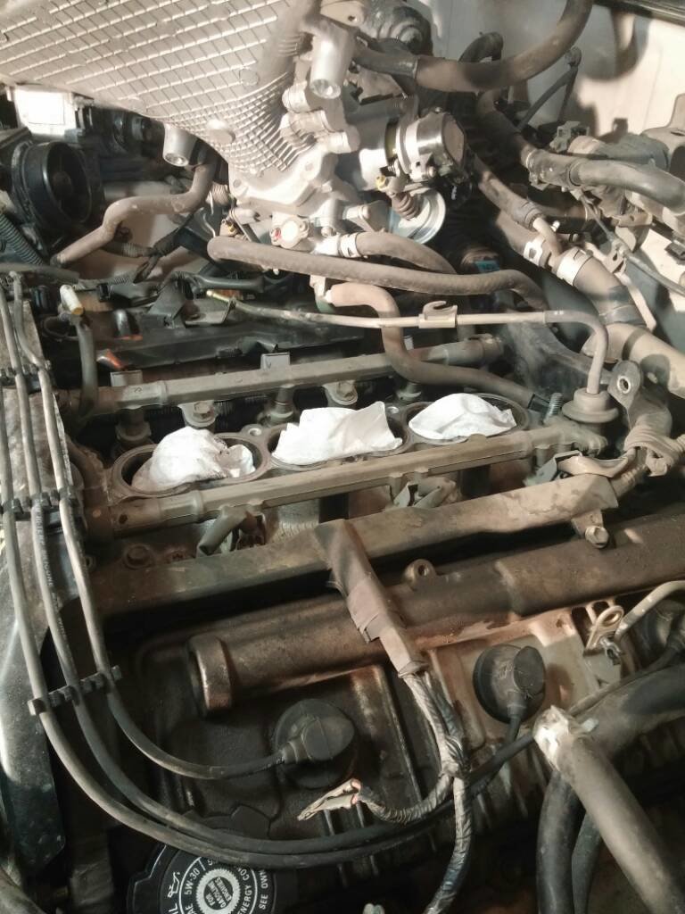

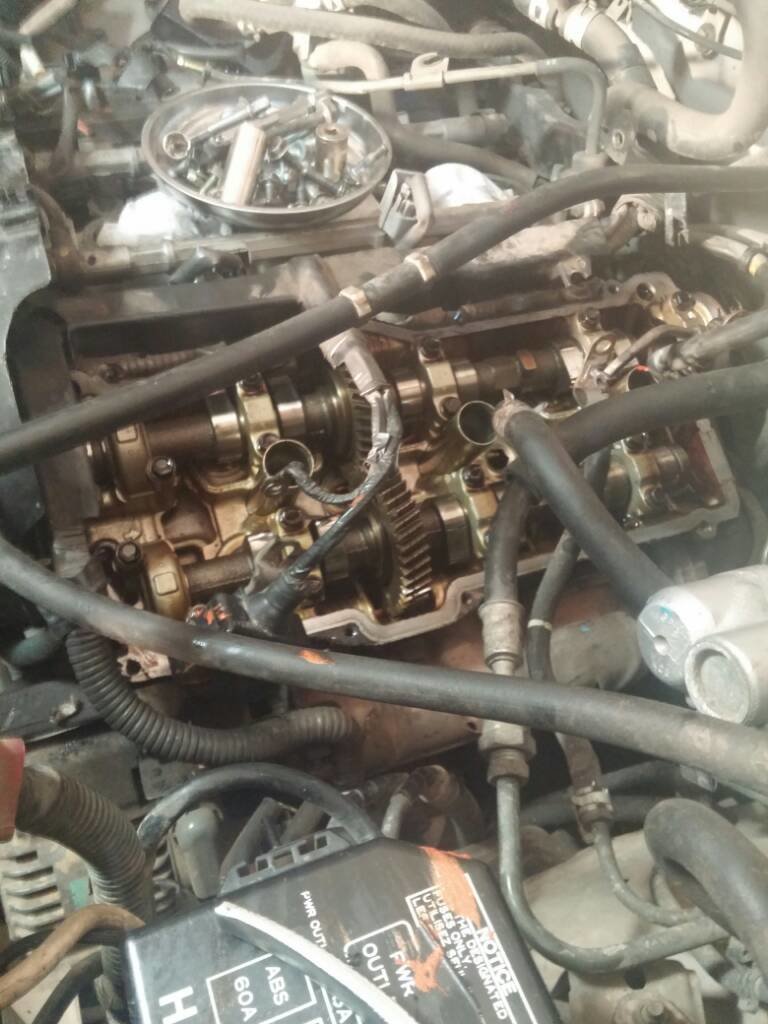

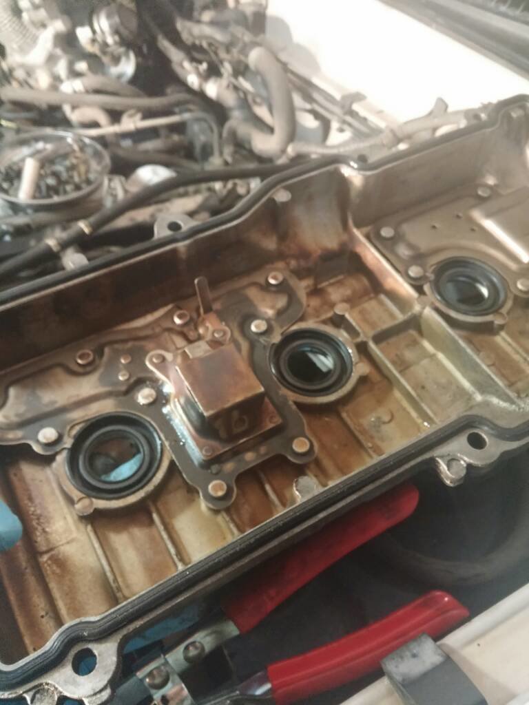

    Part 2 of the valve cover gasket. The driver side. Somehow the driver side took less time than the passenger side. 3.5 hours.
    The top piece of the intake manifold comes off really easy. All 12mm nuts and bolts. Steel gasket that can be reused.
    One of the more frustrating parts was the the plastic cover that goes along the vc. I couldn't get it to do what I wanted so I broke it in a few spots. Wrestling the cover out can be tricky.
    Pulled a plug wire apart. I had a spare that was a little short but worked. So not the end of the world.
    The spark plug gaskets seem to break apart.
    Lot of clutter
    New seals and gasket.
    All cleaned up
    I have some videos of the block plugs I will upload in a few.

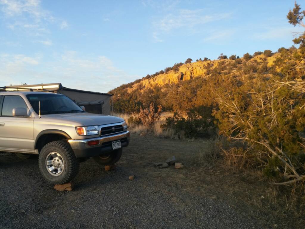

    Well I got the travel big yesterday. Decided I wanted to go camping. Never been to El Malpais National Monument, so I jumped in the 4runner and went! 26 hour trip. 14 of those hours were behind the wheel. Next time I think I will take my time.
    Gotta love that New Mexico traffic
    Overlook at the monument
    Obigatory 4runner picture
    Camp set up. I love the room. I can stand up in it. The buddy heater makes it toasty. Next time I am going to get a table and maybe a cot and try sleeping in it. Super fun to put up in the wind. Each side has 4 or 5 good steel stakes so I wasn't worried.

    I'm way behind here. So did you have to take off the throttle body to do the passenger side?
  20. Mar 7, 2016 at 4:00 PM
    #60
    mr optimist
    mr optimist [OP] Mr Lazy
    Dec 2, 2013
    #117787
    3,221
    Sam
    Alamosa, CO
    1998 4runner SR5 5 speed
    Supercharged, 5 speed, AOR Sliders, Tundra Front Springs, OME 906 Rear springs, Bilstein Tundra 5100s, Factory Diff lock, Wrangler Authority 275/75/16
    So sorry I didn't see this.
    I ghetto hung the top part of the intake with some bungee cords. I didn't want to mess with cruise control or the butterfly setup. I didn't pinch and hoses so I figured it worked! Haha
