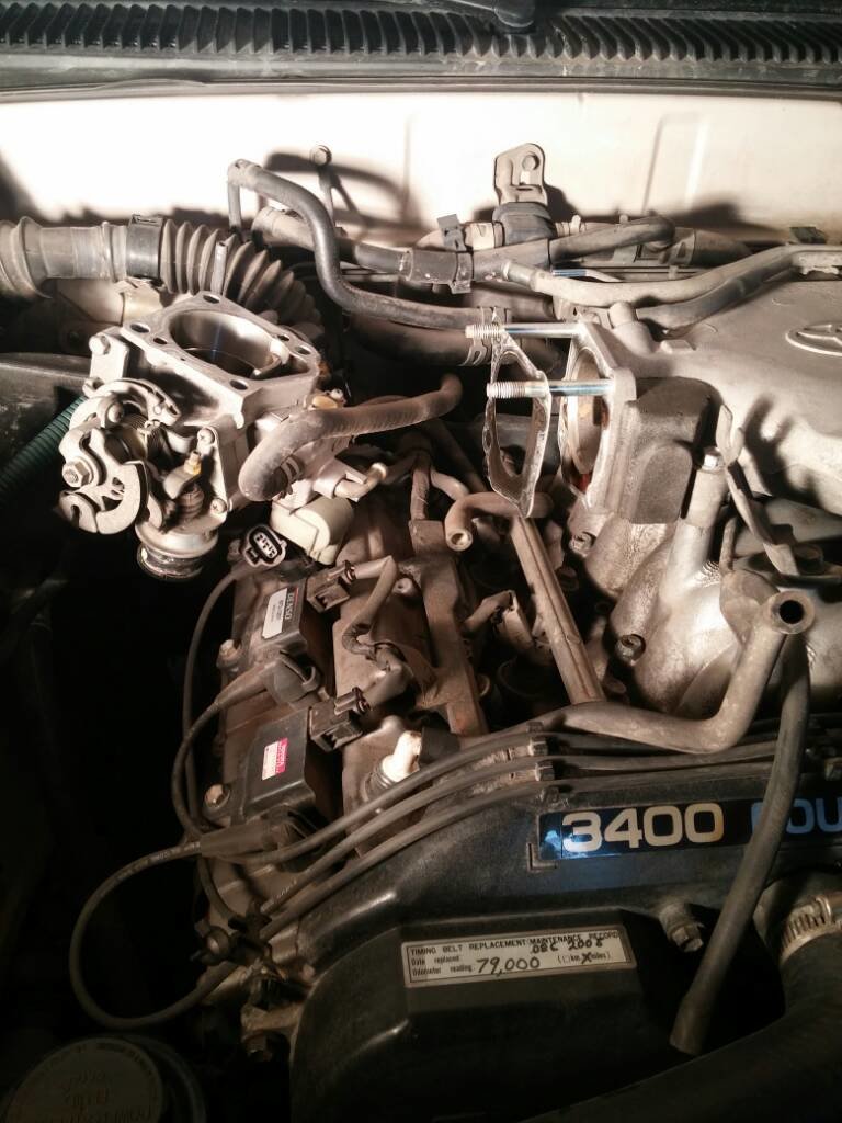

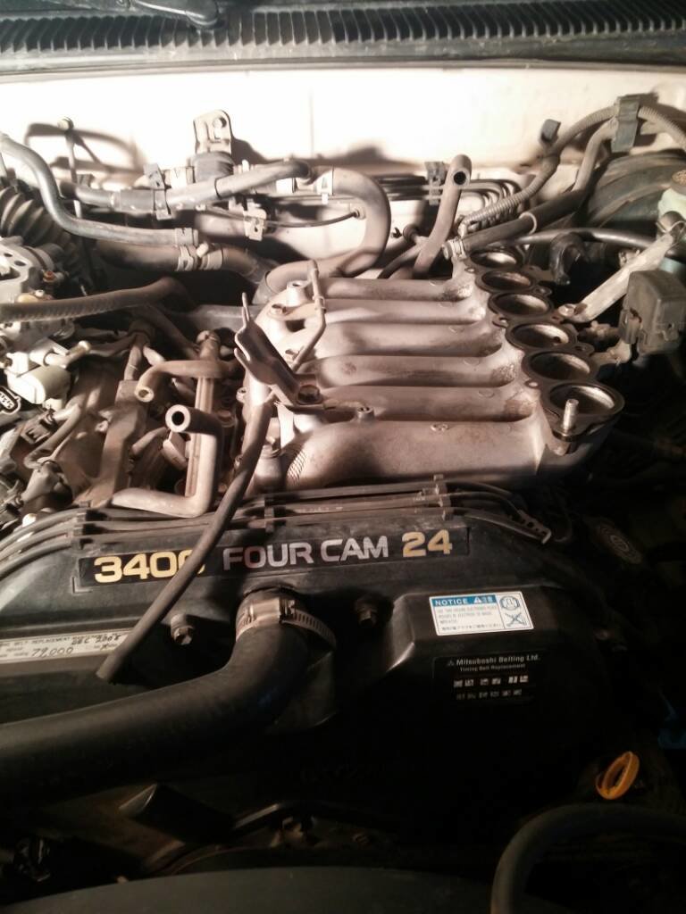

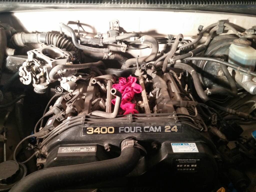

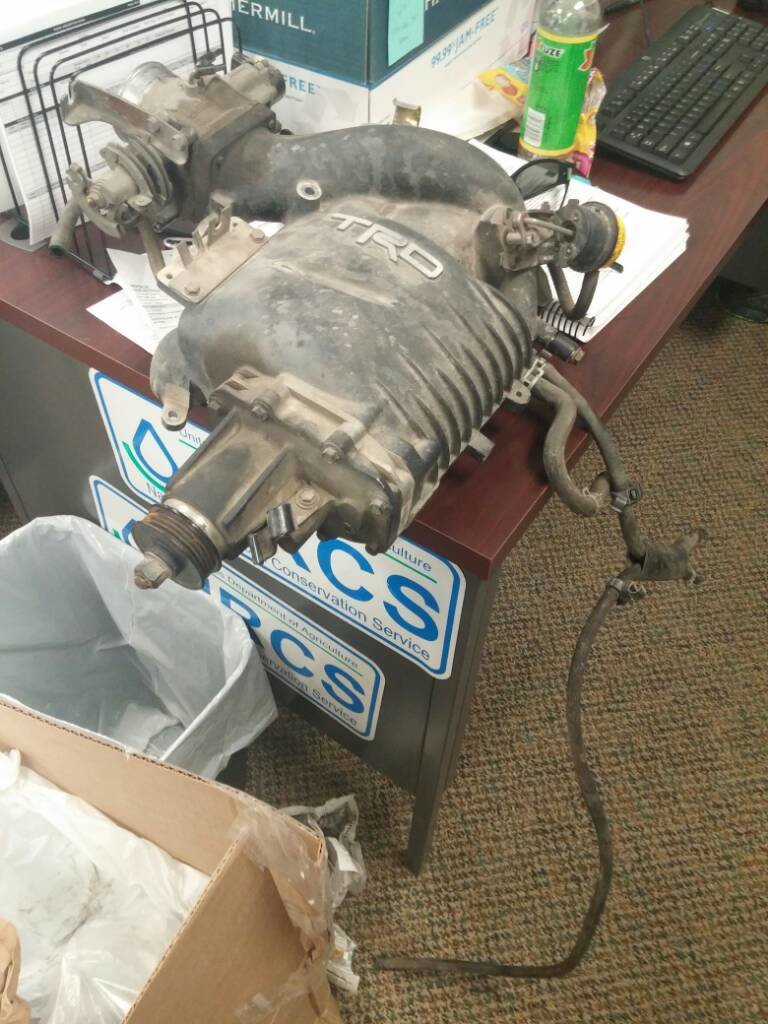

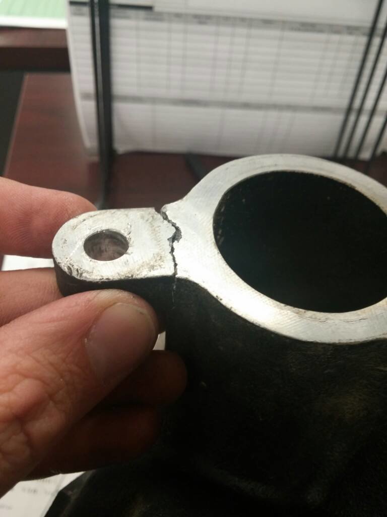

    So the 4runner sucks now, or blows. Depending on your view.
    FedEx man dropped the box at my work desk.
    And the result of said drop
    I got it fixed my a guy in a shack on the side of the highway. Seals perfect and bolted up no problems!
    Just for reference, before:

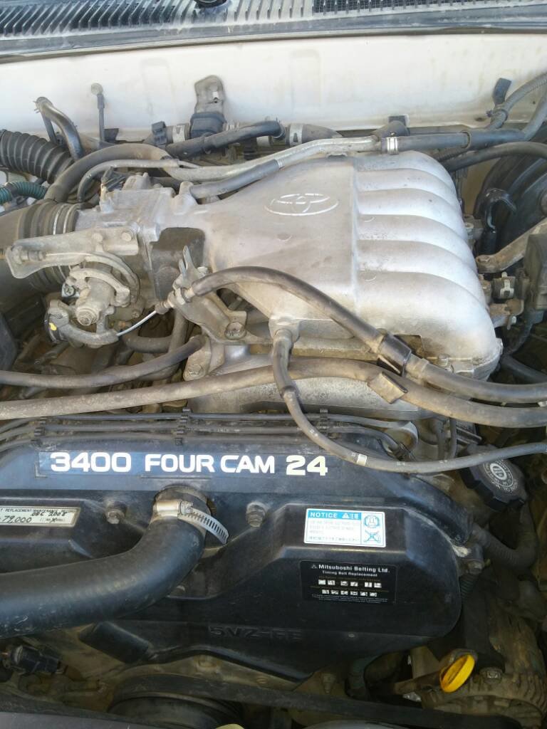

    When putting the supercharger on theoretically you replace the stock metal gasket with a less restrictive one, but it is a month out, and I am not that patient. I will be a little down on boost at first, but it will get fixed.
    The stock intake and manifold is about a 20 min job.
    I had trouble with my thermostat bolt so I bent the wire bracket back and fort 1 million times and just snapped it. No reason it had to stay. Will update with more pictures.
    Fired up no problem the first time. I had the idle all wrong at first, but it was an easy fix.

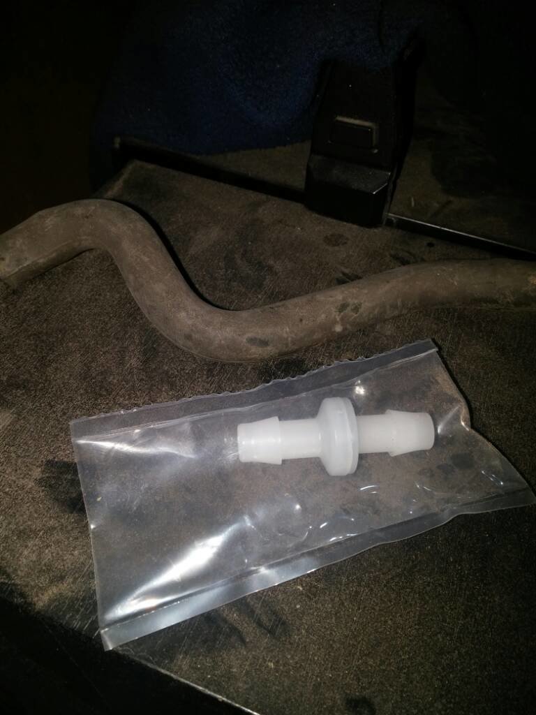

    Also improvised on the check valve. One is on order, but in the mean time I picked up a 1 way pcv valve and made a makeshift one.

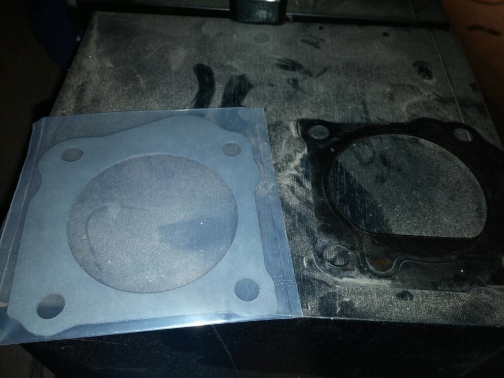

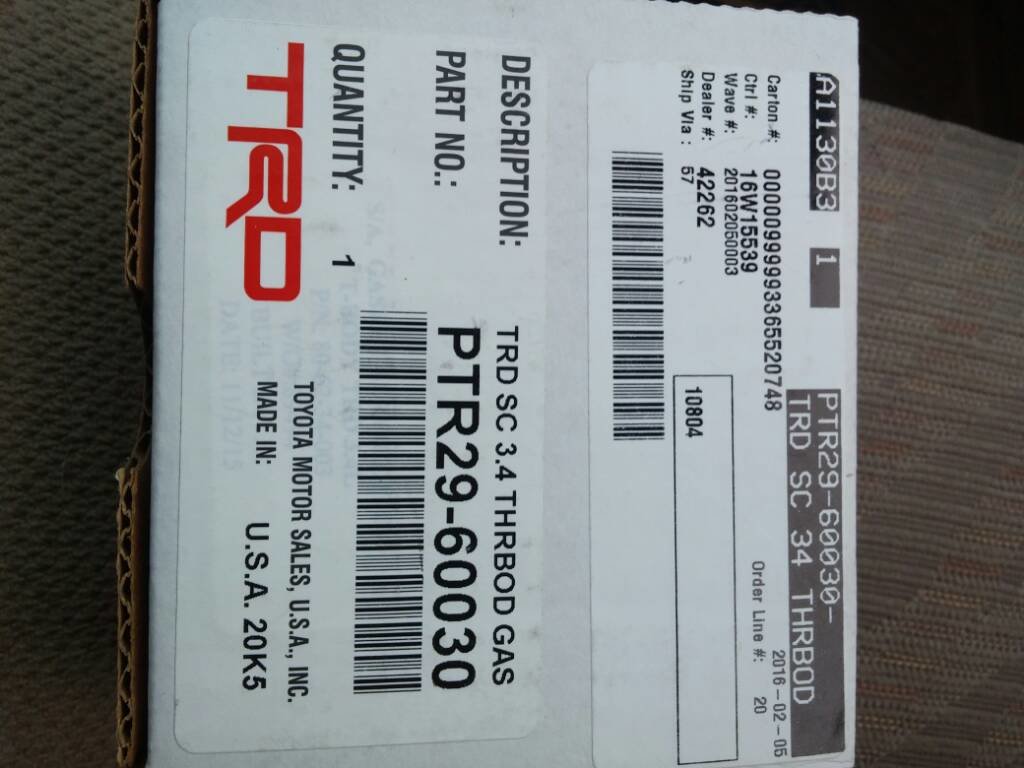

    Tackeled the supercharger throttle body gasket yesterday.
    When putting a new or used supercharger on an NA engine it is a good idea to get the TRD gasket. Why? Because the stock metal gasket restricts airflow.
    You can see the gasket on the baggie is a perfect circle, whereas the metal gasket is more of a "D" shape.

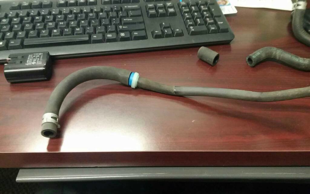

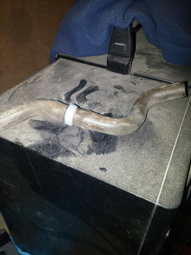

    Also added the intake air control(IAC) valve. Also from trd. I had fashoned a temporary one out of a one way pcv valve until the part came in.
    Pretty straightforward. Cut in the straight length of hose and install. Making sure the direction of airflow is to the throttle body.

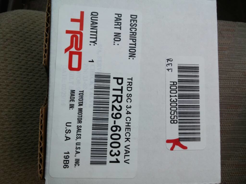

    Here are the boxes with Part numbers on them. I know these part numbers are hard to find, so hopefully it helps someone!
    Both with $11 worth of shipping were $26 from Toyotapartsdeal.com. took 3-4 weeks to show up. I exchanged emails with the sales person and he said these parts are still being produced. Order away!
