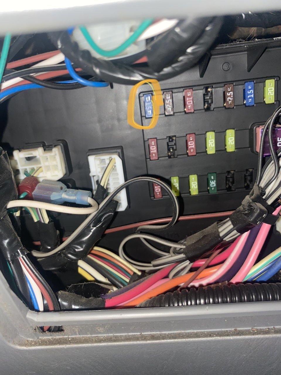

    Auto theft is a big issue today, I leave my Tacoma unattended for hours and sometimes days at a time. Question: "The Immobilizer Fuse" behind the left hand dash storage compartment -If i remove this- Will that "immobilize" my vehicle??? That would certainly be a good added precautionary measure as long as it doesnt cause damage starting w/o the fuse... Thankyou for any intel you can provide.

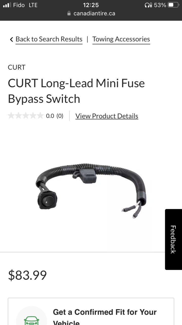

    Kill switch would be my preferred method, but if OP wants to pull a fuse daily, he might consider a short fuse extender like this so the wear is on a replaceable part and not his fuse box. Also would make it easier to find the fuse.

    It seems that you already have a T-Tap to something somewhere.
    If you don’t want to fiddle with wiring.
    I believe there is a switch that plugs into a fuse, that you can use.
    But those are very easy to find are fix for a determined thief.
    One of the first spots a thief would look at is the fuse box.
    Other than that, you are looking at mechanical locks, such as clamps, boots, etc.
