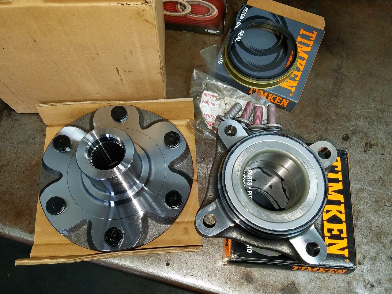

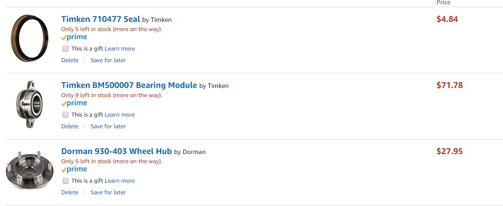

    Just want to verify these are the correct parts and that I then also need the 4 hub bolts and an O Ring from Toyota?

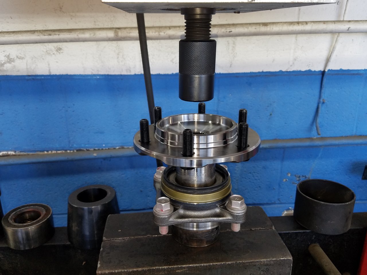

    Double check the seal just to verify that it's correct, I can't remember the part# off the top of my head. The o-ring most likely can be re-used and not needed to be ordered unless you desire a new one.
    however, I won't be able to press it together until after I get back from the Mint400 race which will be Monday March 12th. Until then I wont be able to get to it, it's crunch time for us prepping for the race, and of course race week all next week.

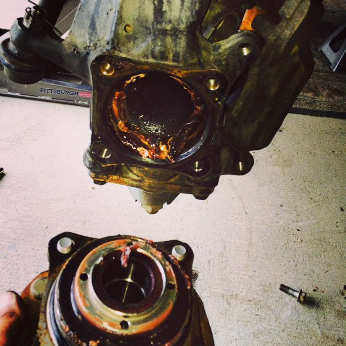

    Also to add
    I got some assemblies from bill back in 2013, by November 2014 with only 20k miles on them the grease had completely came out of the wheel bearing (I hadn’t noticed) and the hub with bearing matted together because of the heat. This happened to both sides...
    Had to buy new bearings
    But this time I got them from Jason @nj636
    About 80k later and still running great! :woot:
