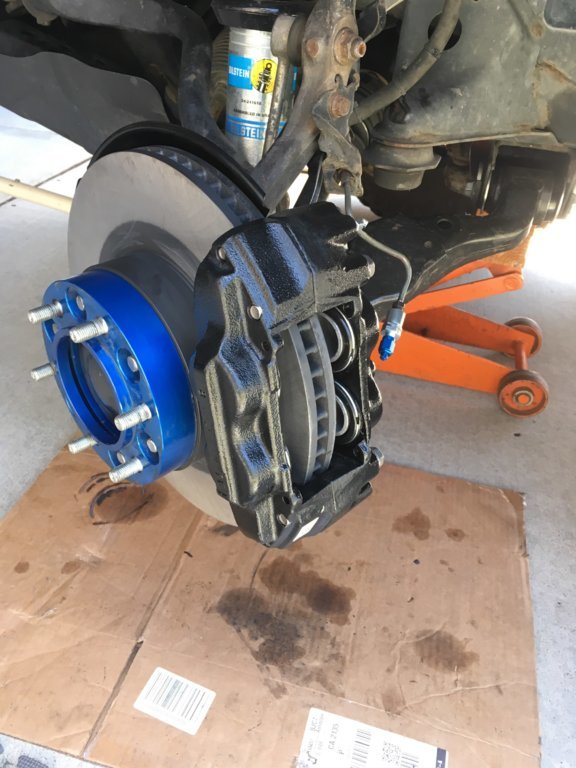

    Replaced my trashed hub/bearings over the weekend and did the Big Brake conversion at the same time.

    The Lexus calipers or which ones did you use?

    Do the tundra brakes work with your trucks too?
    Edit: just saw the link

    I think that only works on the 1st Gens.

    Hmmm I wanted to buy a bbk (stoptech) but forgot about this alternative

    Yeah, 17's.

    Cool thanks for the info

    yep the tundra breaks are only for first gens, they are about the same size calipers as the second gen tacos. From what I read, the true upgrade is the WL not the WE calipers...difference is 03 tundras had upgraded calipers due to complaints of stopping power.
