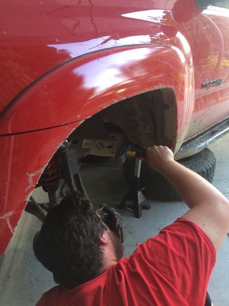

    Im bored at work so i think ima bang out the pibch weld... anyone have any pointers or pics of what it should look like when im done

    Notch it first and then BFH

    @eccracer104 notch it? I remember we talked about it well idk if you remember haha

    Ima just take the wheels off ... my office is off today so no worries about anyone showing up so i just wanna bang it out without notching if i can

    We tried bending without notching. It was a pain. Probably will take twice as long without notching

    Only picture I can find of it is @4x4Banger hammering my pinch weld. Notched one side, it bent in so easily the other side we did it without notching and it was barely more difficult.
    Hit the pinch weld flat towards the outside of the cab.

    Maybe the 3rd gens have more metal there? Or maybe not heavy enough of a hammer?

    I just did one side no notching .. a pain but it works outs

    I used a 4lb not to bad ... just slowly start from top to bottom and repeat ... and yes there was blood :anonymous:
