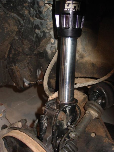

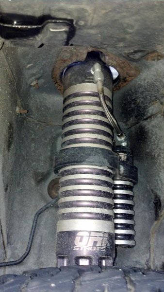

    Here are some pictures of my strut mounts for 10" ORI's. I don't have the lateral support provided by an upper control arm, so the bottom mount is retrofitted with a sleeve made from the stock struts to act as the spindle. I gained a little more compression travel by welding my tabs to the top of the upper mount. The lower mounts are an older style (same diameter as the piston shaft), and I have a 12" piston shaft for a 10" strut, so the spindle sleeve wouldn't limit my down travel. I used a couple pieces of rubber on the upper mounts to keep the struts from rotating, so they don't twist and knock.
    The picture of the spindle mount is old. The sub-frame has since been dropped 4 inches and my CV axle isn't all torn up like you see in the picture. I've also added the reservoirs, nice tight fit. This was an experimental design to see if the ORIs could handle the side load without an upper control arm.

    ummmmmm what is that mounted on for vehicle wise, im ummm speechless to be honest

    That is pretty interesting. I take it they are holding up as the spindle? I wouldn't have expected them to honestly.
