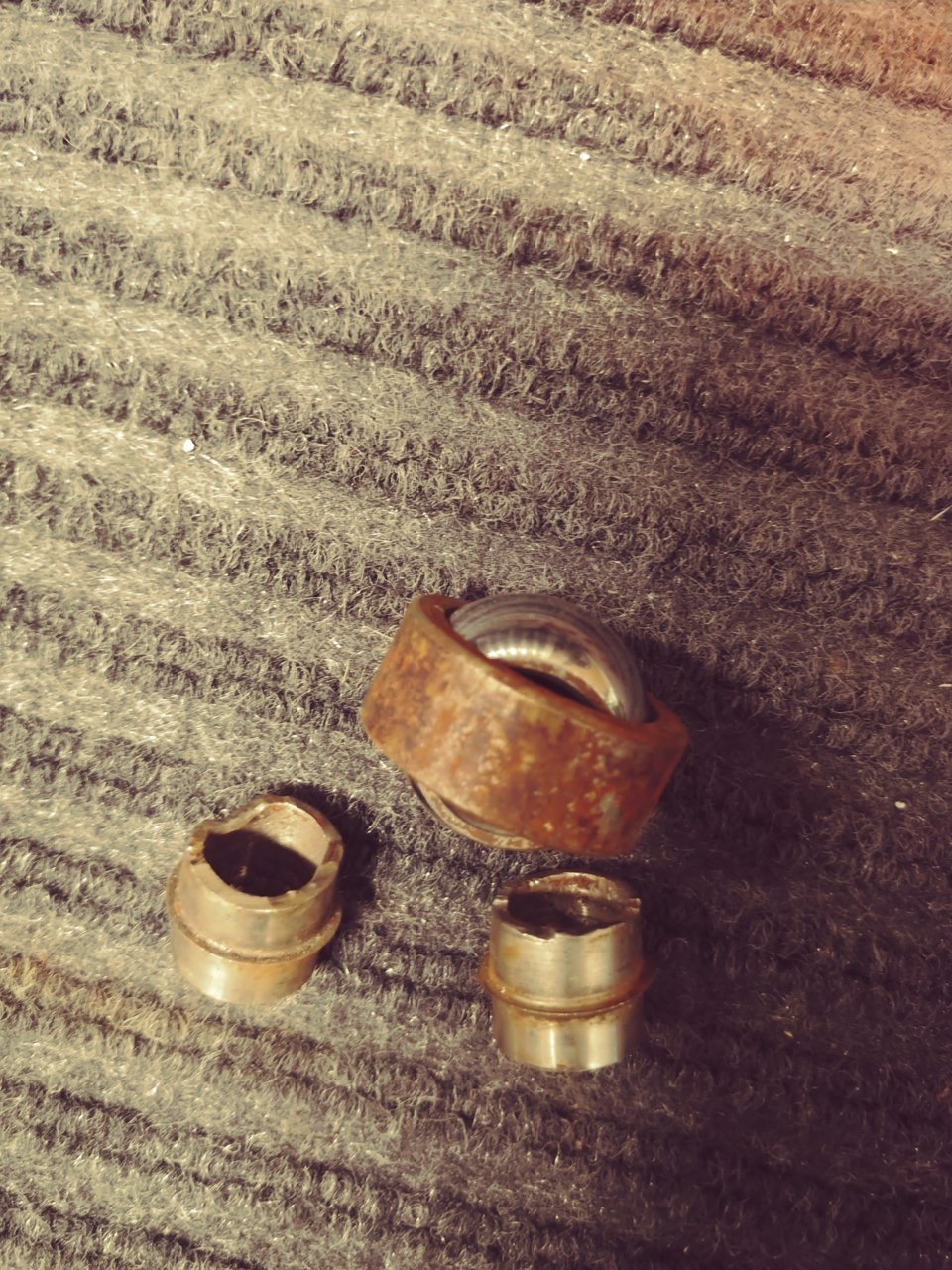

    I have a set that I will be rebuilding. All parts are acquired but I am having a hell of a time finding the top misalignment spacers that will fit the BAMF top hats. The lowers are 1/2 to 5/8th total length of 1.6 inches the old uppers are total length of 1 3/8". My google-fu is failing. I have made multiple wrong orders. Can sombody point me in the right direction. Thanks!

    Thanks for the link, I haven't contacted BAMF yet. I figure I post this on the forums so it would be searchable. And for referance this is why I need to replace them and cant just use the old ones. Actually looks as if the pieces were cut from the 1.6" to make the fitment to the top hats. 20180720_194045.jpg

    There is no off the shelf option we turned down the ones supplied from ORI for every set we sold. All you really need is .75"x .120 wall DOM and you can make your own.

    Thank you! Figured it was something like that. Was driving me crazy for a bit.
