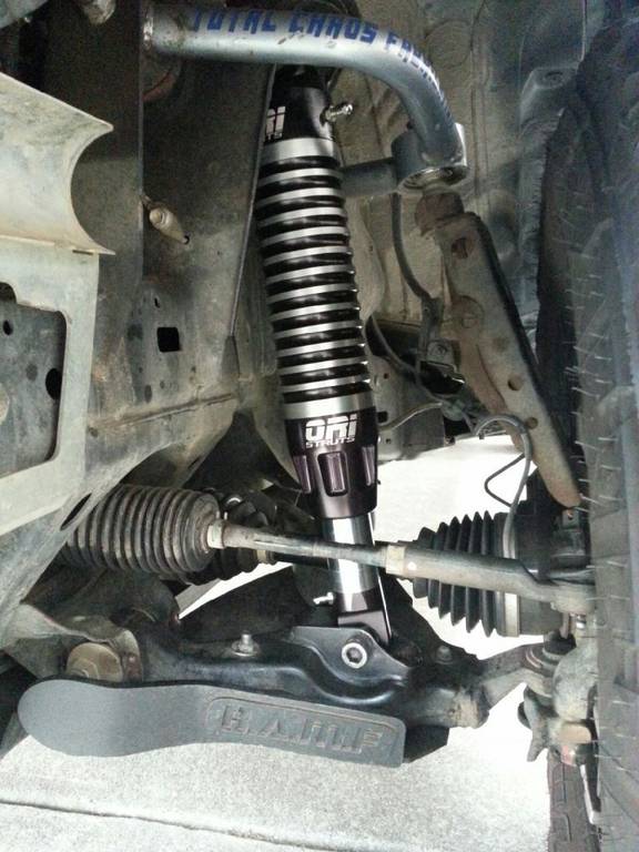

    ride Height:

    OMFG!!!! Anyone want to buy some Fox ext travel shocks?! :drool: How do you have it setup with all the weight for your bumper and winch?

    We're still working out the settings. Will keep you guys updated.

    Holy downtravel! Hub to fender measurments at full droop?

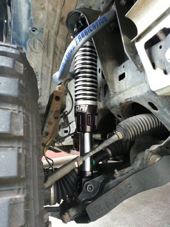

    He can't drive like that the CV would snap as soon at he moved. They will be strapped just before the CV binds but more travel then any extended coil over.

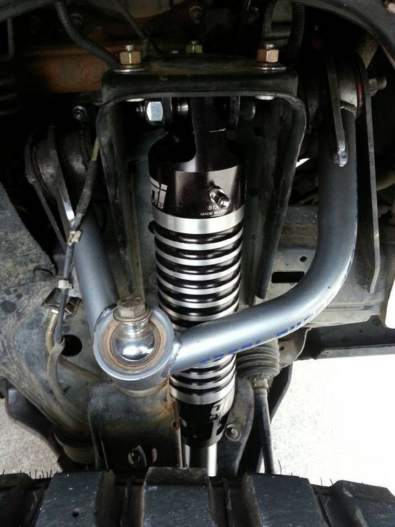

    Will the bumps need to be extended? Or are these able to provide that much more travel with stock mounting points

    The factory bumps might be able to be removed depending on the tire size. The ORI's have an internal Air bump so if the tire fits the wheel well there is no need for factory bumps.

    :eek: wat? So is there any downside to these? I would love to know how they ride. Just to recap for our trucks, pulls much more travel than ext travel coilovers, cost about the same price, effective spring rate can be adjusted.
