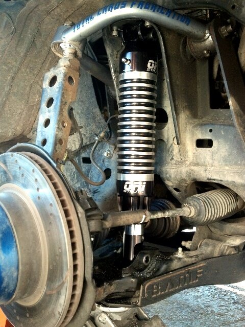

    Holy truss Batman! Haha... looks good.

    Thats what i was going for :D

    This is the first set on a mid travel IFS Tacoma so you wont see much on these for IFS.

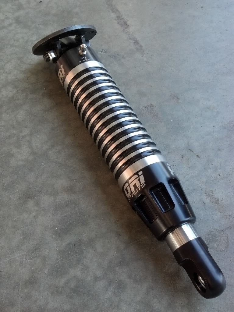

    The 10'' stroke ORI's with the BAMF top plate.
    ORI's next to extended travel KING coil overs. With the smaller body of the ORI there is no issue with the UCA hitting the strut at full droop like some coil overs have.

    such a nice assembly
