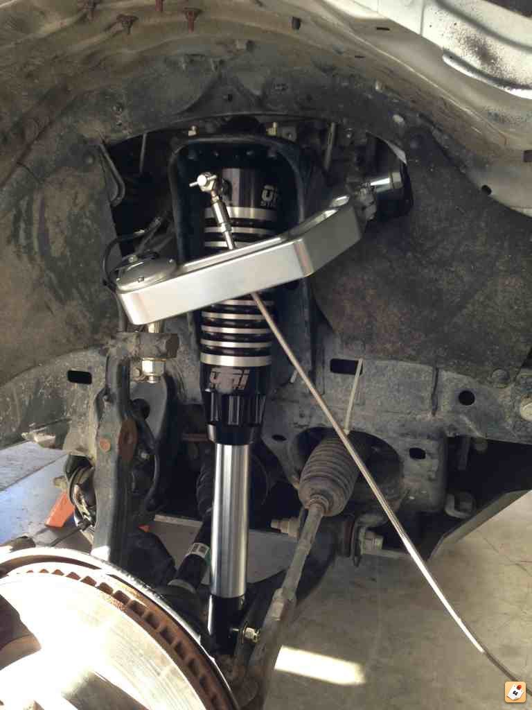

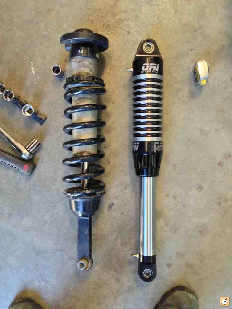

    Was at Jerry shop this weekend and got the 8" ORI in. Got a nice top plate designed that maximizes the full stroke and no need for a limit strap. Compared to my extended travel icons it gained about .5" down travel but a lot more up travel than before. I can stuff my 35's down to the factory bump. Thy ride great also.

    Awesome I ordered a set as well, what PSI did you charge the upper/lower chambers? What ride height did you go with? Are you running a limit strap? and more pics if you got them.:D

    Went with 95 psi in the lower. Unsure on the upper as the regulator gauge was broke. I just put a level on my frame and brought it up until level with the rear
    It's about .5" higher than my icons where it's set
