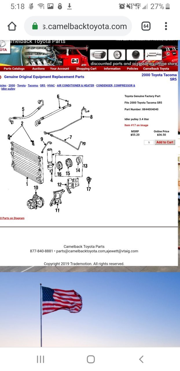

    Where would you get the AC idler bearing from? I can't seem to find it on rockauto.
    I am about to order the fan bearing bracket, fan clutch, and power steering pully. Timing kit will be here Friday. Looking forward to getting this repair done :thumbsup:

    My AC is aftermarket, but I actually can press out the old bearing from the steel pulley and press in a new
    bearing for 10.00

    He isn't looking for the compressor. He just needs the idler/bearing, which can be had for $15-$30.

    $36 for OEM pulley assembly from Camelback...
