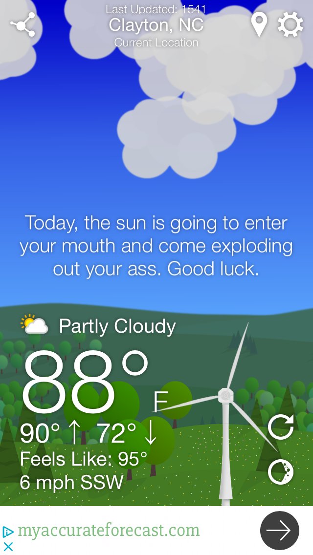

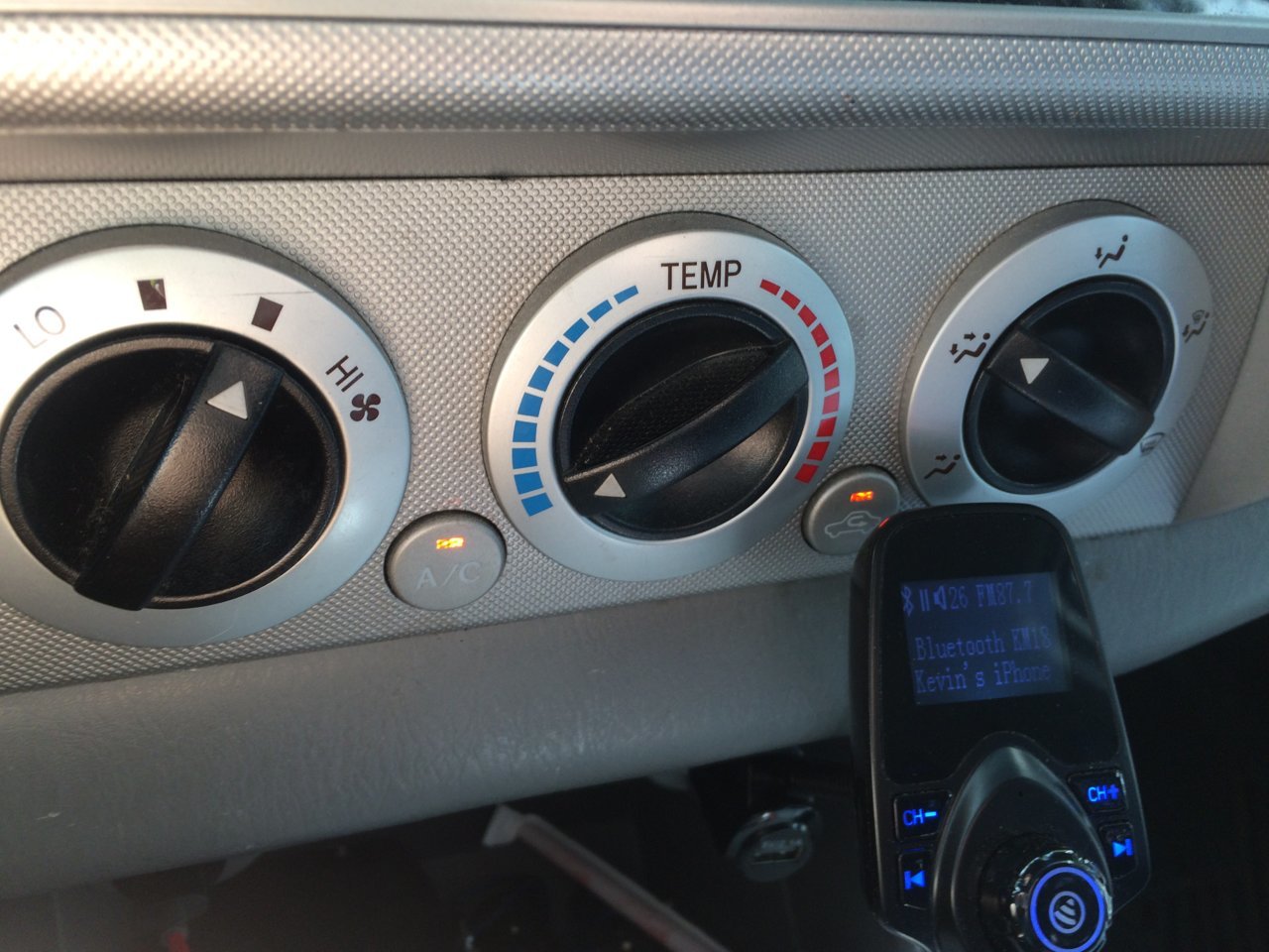

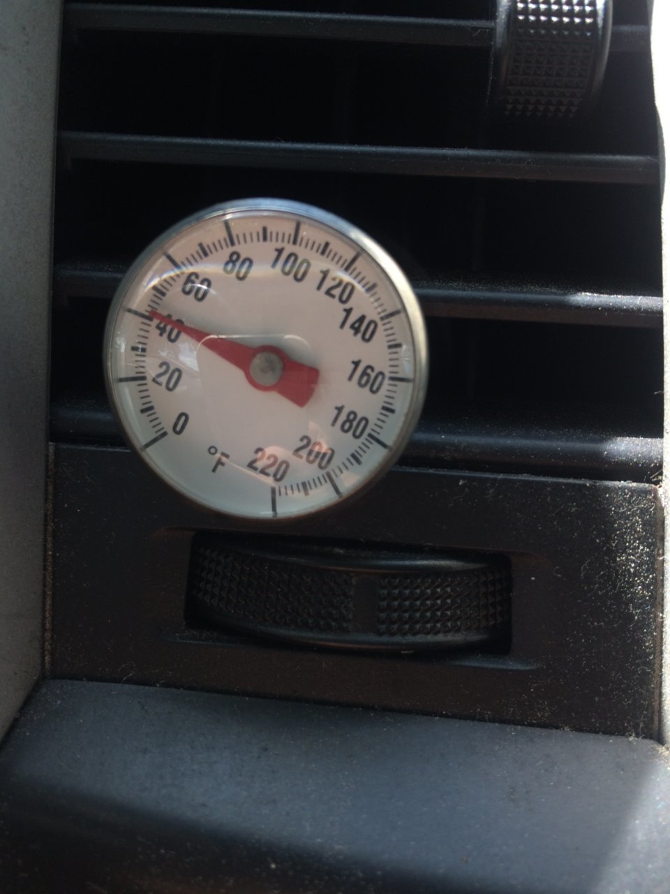

    Sitting here waiting to go in drs office, 25min idling ac on
    What am I doing wrong ?

    It's under 100 degrees outside. That's what you're doing wrong.
