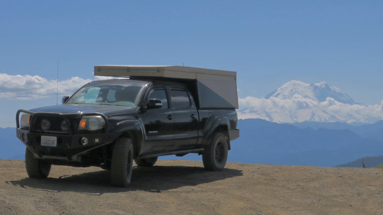

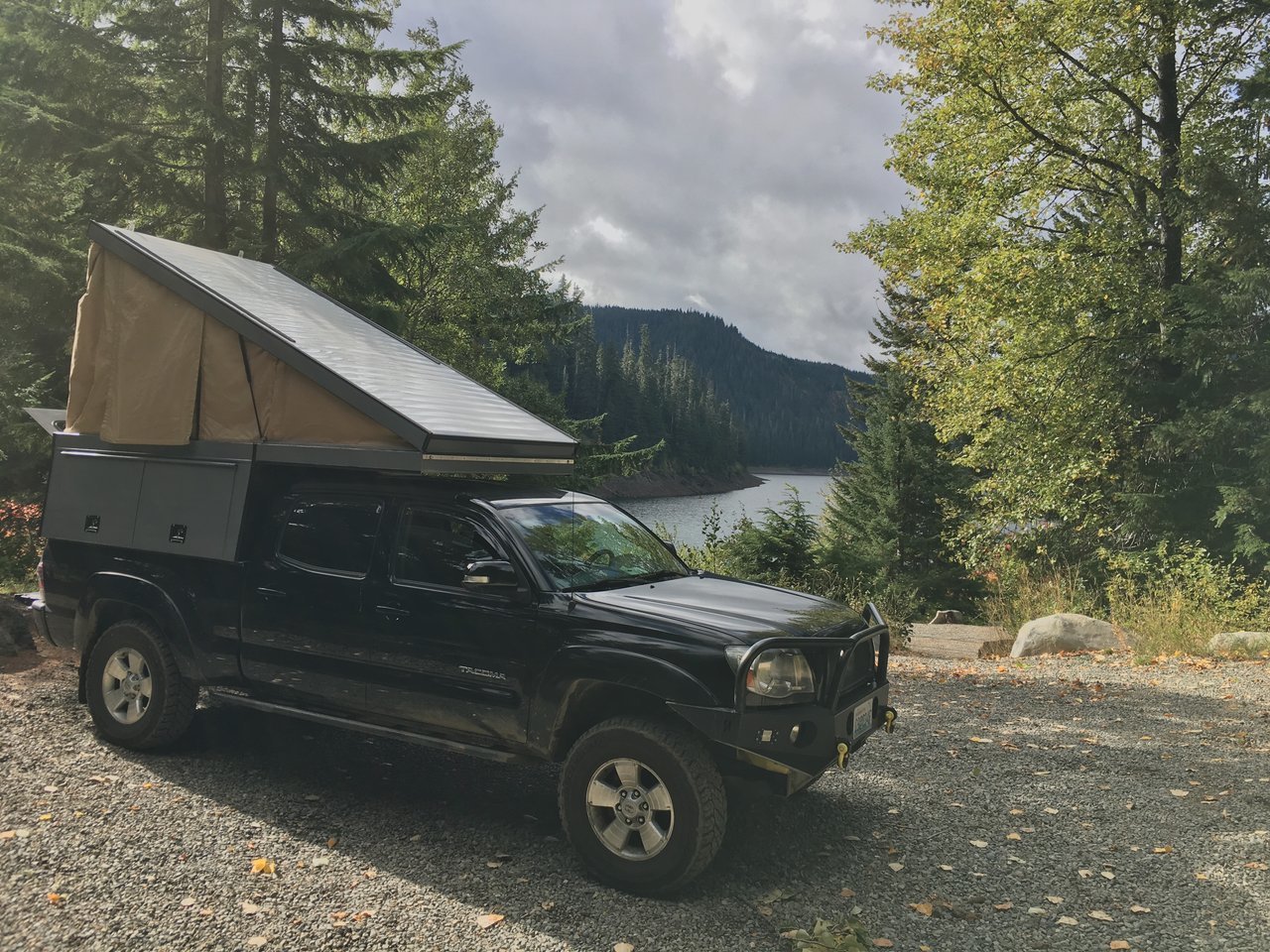

    Finally decided I've screwed around with my truck enough to justify a build thread....
    Current setup:
    Custom welded front & rear bumpers, sliders, and pop-up camper.
    Bilstein 6112/5160 front/rear shocks, OME HD Dakar rear springs, 255/80r17 skinny MT tires

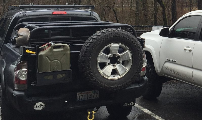

    Bed Rack
    The original design
    Added spare tire & fuel can mount:

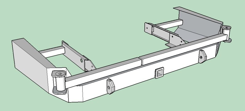

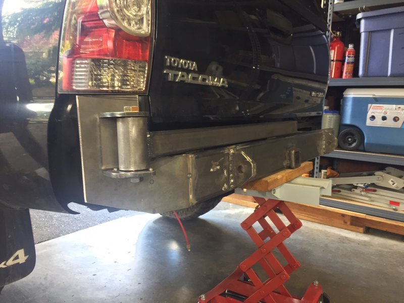

    Rear Bumper Build:
    The idea...
    the two swing arms will eventually support 2x 20L fuel cans, bike rack, and maybe the hi-lift jack. Haven't modeled them yet, but I think the 2x2" square tubing will be a good foundation.

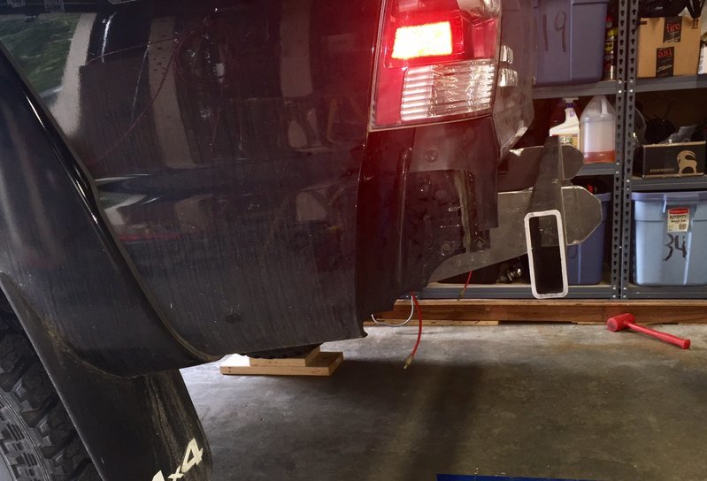

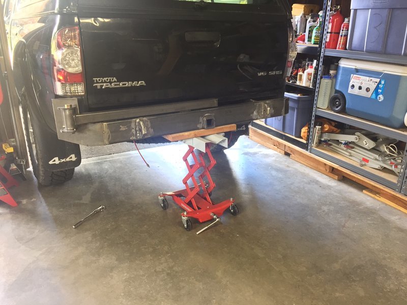

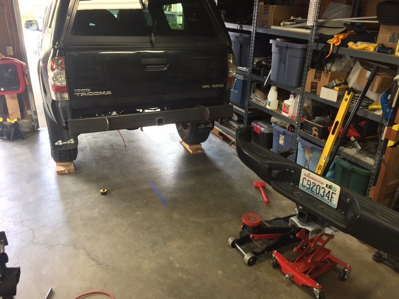

    The slow reality...

    I like your rear bumper.
    I ended up buying a Pelfrybilt, but I am going to build a dual swingout, like you have. Have you figured out how you are going to latch the swingouts to the bumper? I have some ideas for mine, but none I really like.

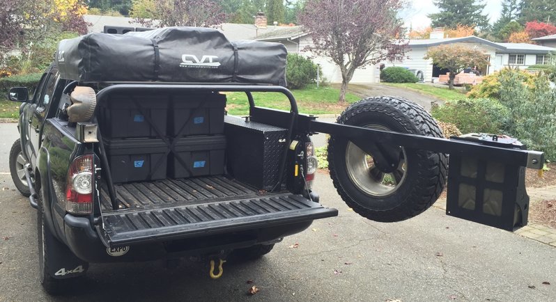

  7. May 17, 2017 at 11:53 AM
    OutbackHack
    OutbackHack [OP] Well-Known Member
    Dec 3, 2009
    #26963
    633
    Golden, CO
    2014 DCLB Heavy
    Haven't decided 100%, but most likely going with a bolt design similar to the previous swingout I built. Basically a big 1/2" bolt with a handle welded on. Little bit annoying to open and close cause you have to turn it a few times, but I like the security and simplicity. Clamps the arm tightly closed, kills most of the vibration/wiggle that other latches allow, and cheap. Since this will be a dual swingout, I'll probably make a bracket that overlaps the 2 arms so that a single bolt can secure them both.

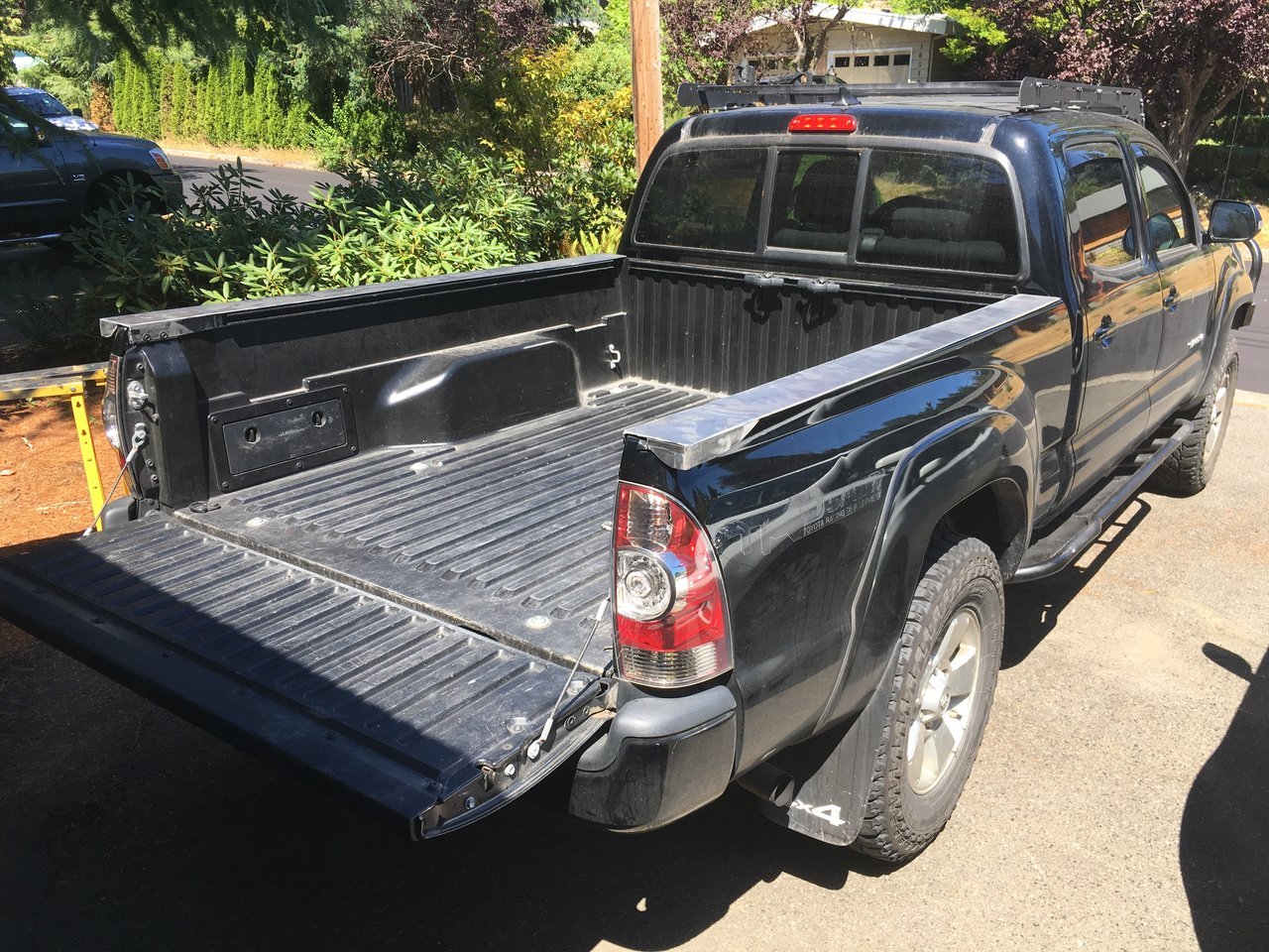

    #ConvertingFromShortBedToLongBedProblems
    #TooManyProjectsNotEnoughTime
    MarX likes this.

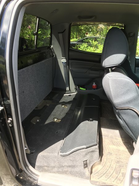

    Removed the rear storage and seats to maximize storage, made a carpeted panel to cover the exposed sheet metal and put some insulation back in.

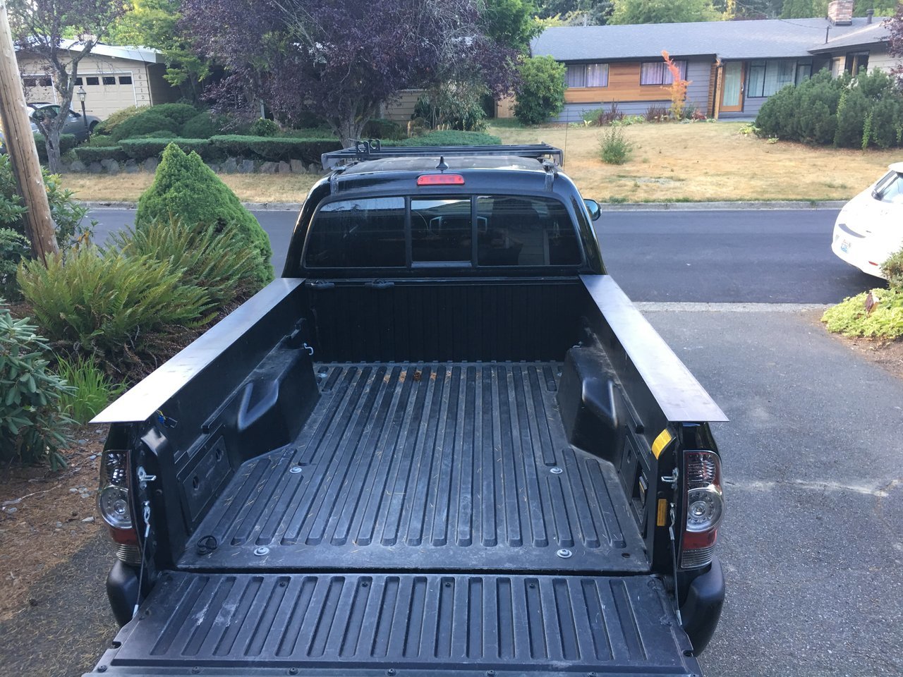

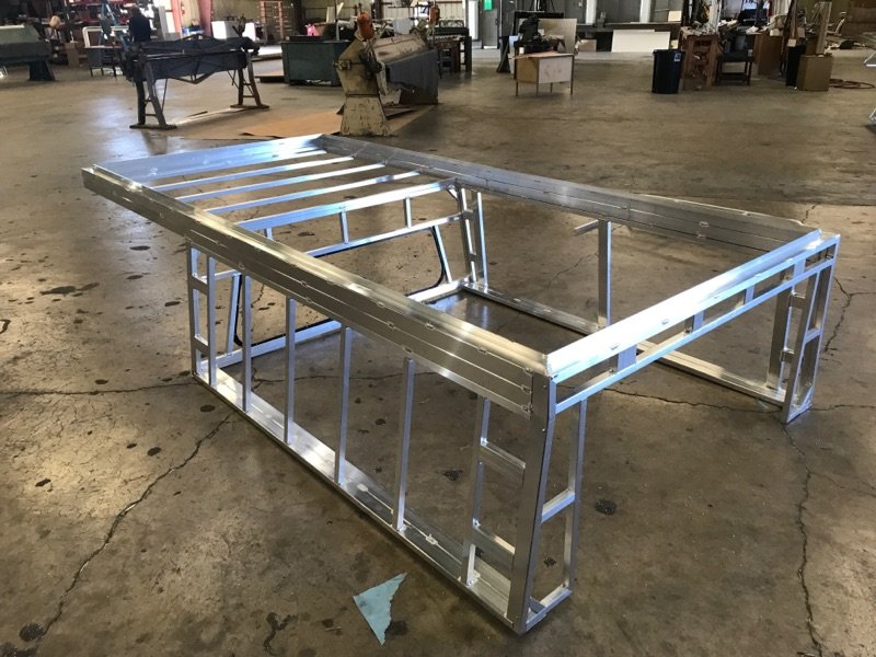

    First version of reinforced bed rails to support the camper and give me a flat surface to bolt to. Extended out a bit to match the camper's 76"x66" footprint and compensate for the fact that the stock bedsides taper toward the rear.
    First time welding/plasma cutting such long sheets of only 1/8th steel. Metal wants to warp all over the place. The second one came out better after experimenting with a couple different ways of clamping and pre-stressing the metal to make the distortion work for me.

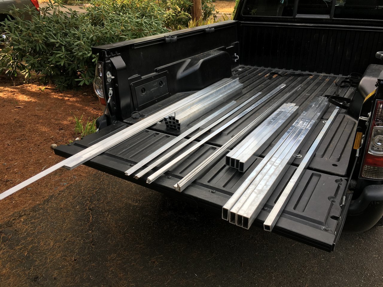

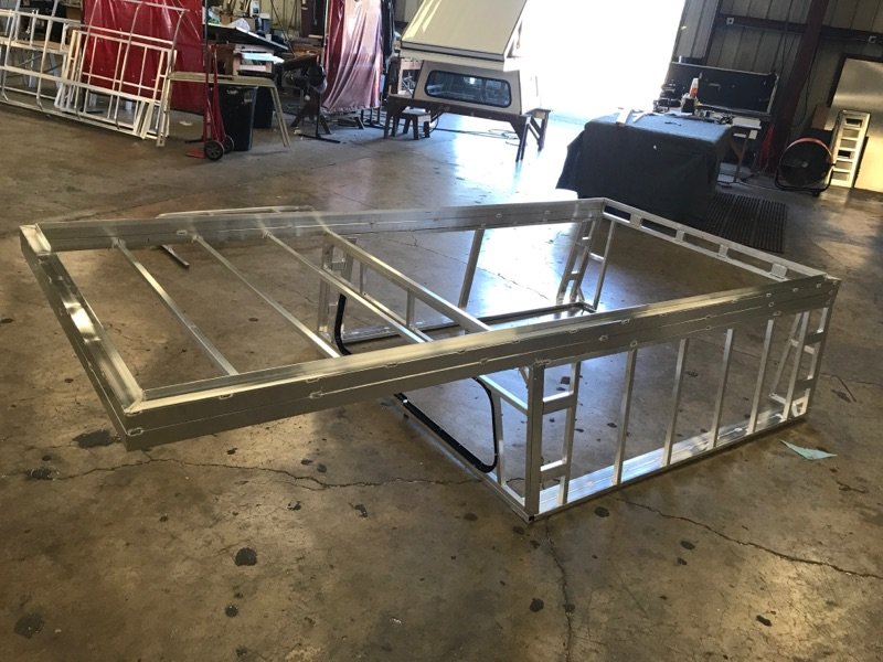

    So it begins....

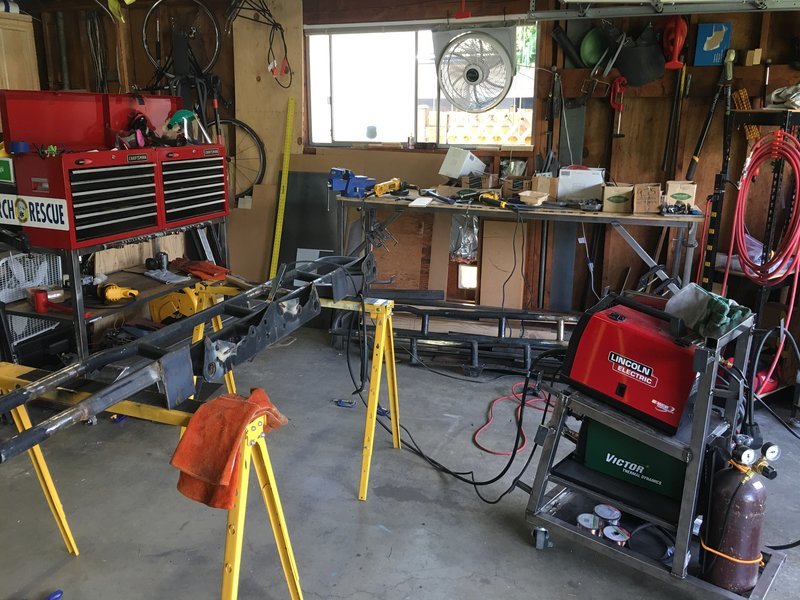

    spoolgun practice... :headbang:

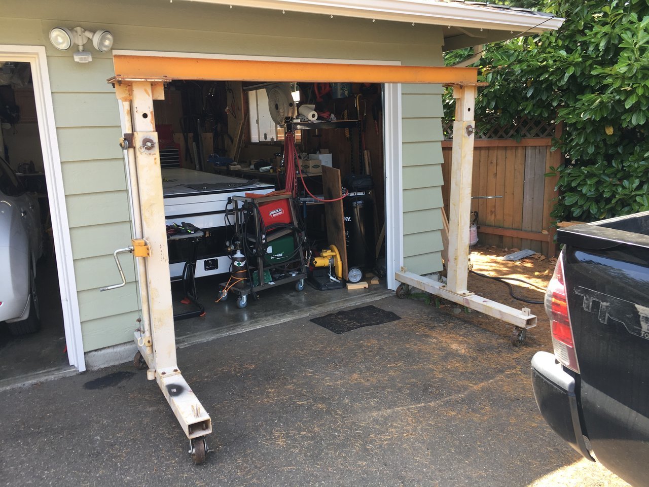

    MarX and SonnyBones like this.
