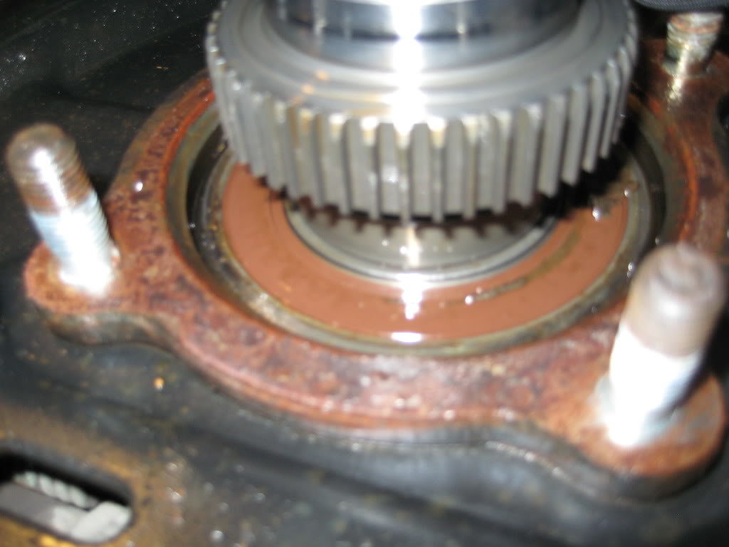

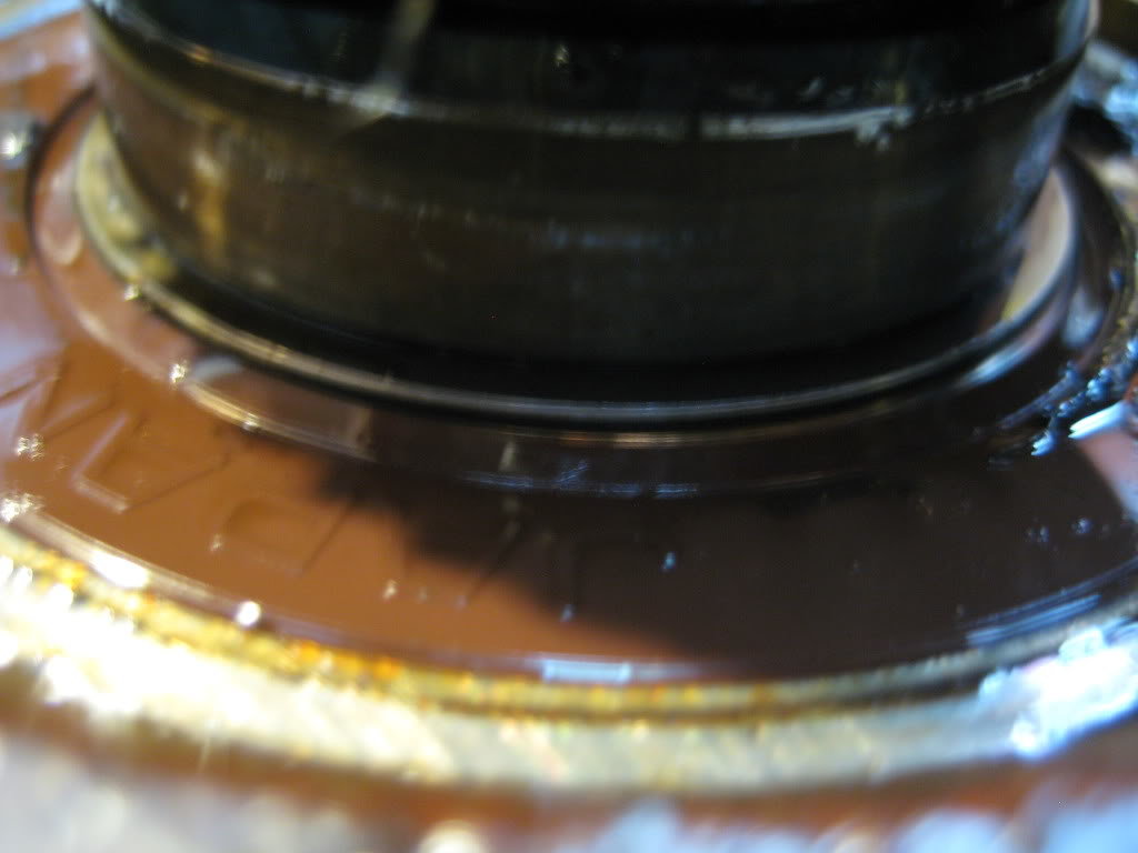

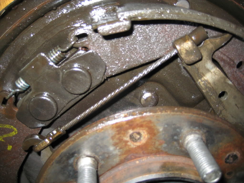

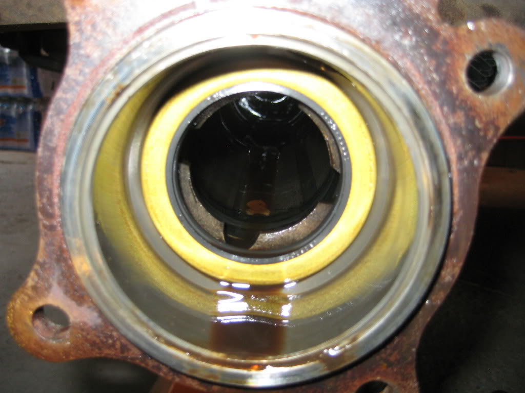

    I am in the middle of attempting to replace my drivers side rear axle seal because there was gear oil leaking out of the brake drum.
    I have just a few questions if there is anybody who has done this before that is willing to help..

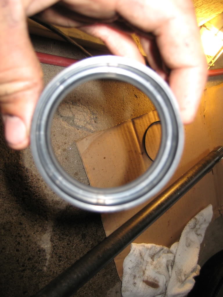

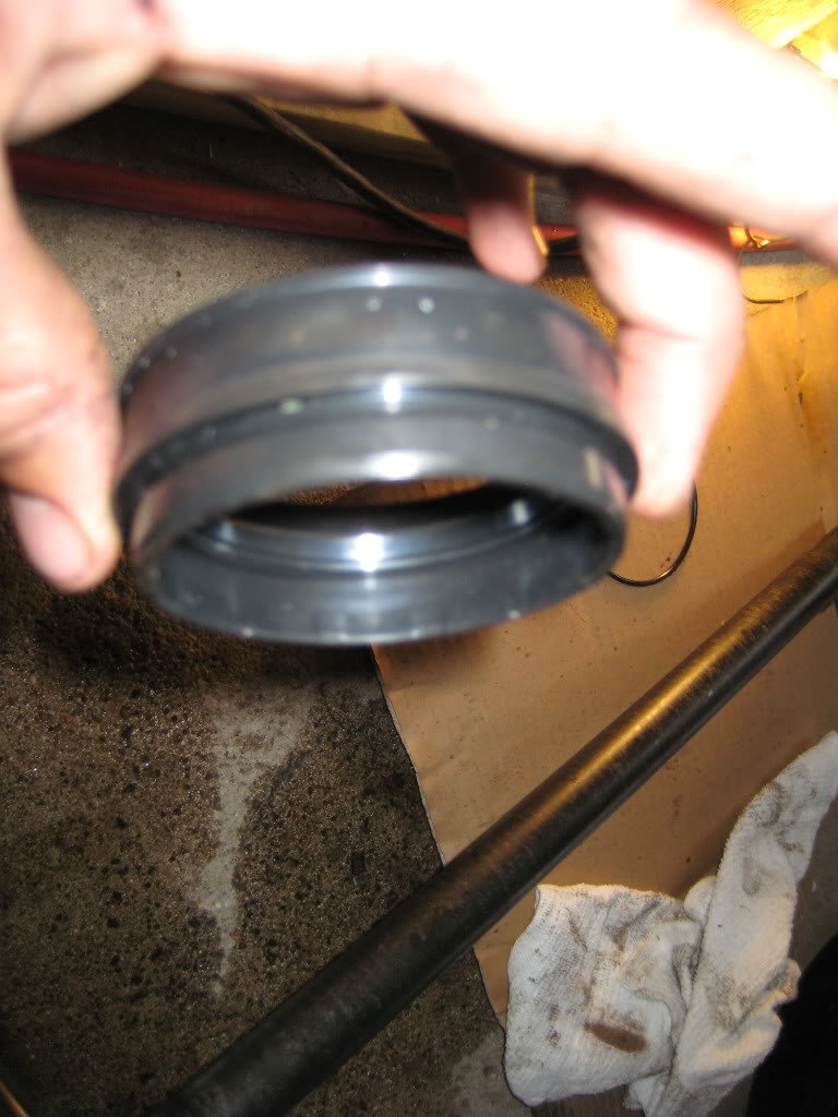

    First; Is this the right seal?
    Are there any tricks to getting the old seal out?
    And is there a way to know if my bearing is bad, it feels really loose and im not sure if that is the way it is supposed to be or not.
    Also the oil was leaking into the brake drum, which makes me think that that maybe the bearing or the seal on the inner side of the bearing might be whats bad if the oil is able to travel through it to get to the inside of the brake drum:
    Sorry for the bad pictures and thanks in advanced to anyone who might have some advice.

    That seal doenst look familar to me (i havent done the rear in over a year so dont quote me)... i would pull the old one and compare.
    To get the old one out i just used a mini prybar. To put it back in grease the outside of it and use a can or a block of wood that will fit over the seal.

    I think that the auto parts store gave the seals to me wrong, the one that I took a picture of is actually the inner seal. That is probably why it doesn't look familiar to you. Luckily I bought both the inner and the outer just in case, I pulled out the one that they told me was the inner and it ended up being the one I needed.
    Thanks for the advice, using a block of wood worked.. just hop I didn't damage the new seal putting it in.
