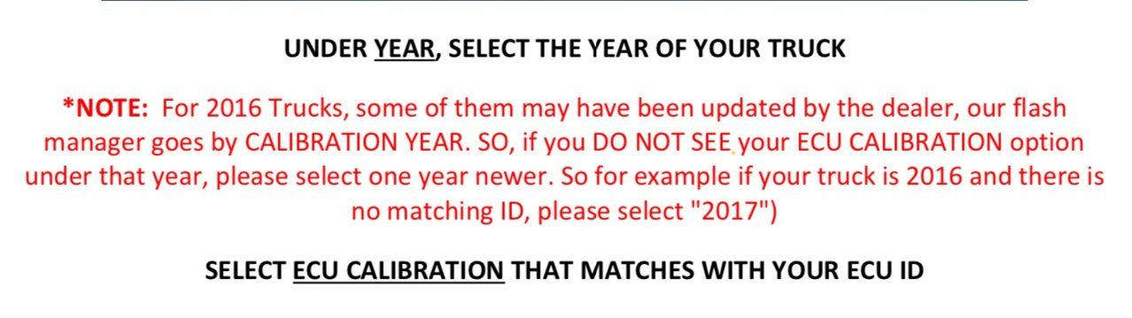

    Normal, nothing to worry about

    upload_2020-6-9_18-37-19.jpg I see this but mine is going in the opposite direction than is described here upload_2020-6-9_18-37-19.jpg

    My 2017 was 04B02. I'm now updated to 04B04.

    If you got OVT, you can update at home. It is about as simple as an OVT flash.

    How did you do it my truck is a 2016 and the ECU is 04B01 the closest one is 04B02

    Not the OVT programs, but TechStream as shown in the post.
    Yes. It is a lot of steps because folks have asked a lot of questions in the past. It is really similar to the OVT programs.

    It says in the post. But:
    T-0033-18.cuw is for 2016 and 2017 MT.
    T-0034-18.cuw is for 2016 and 2017 AT

    Thank you for all your help I am all updated and turned.
