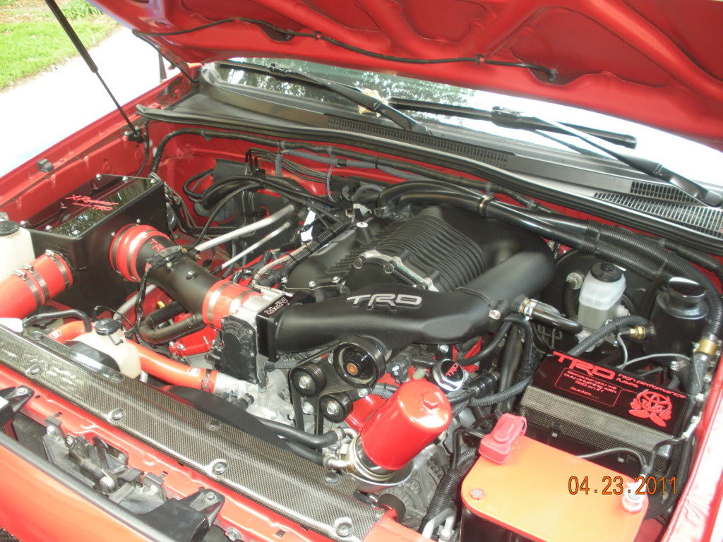

  13. Jul 30, 2011 at 12:50 PM

    Lots baby!
    Me too. Painted RR.
