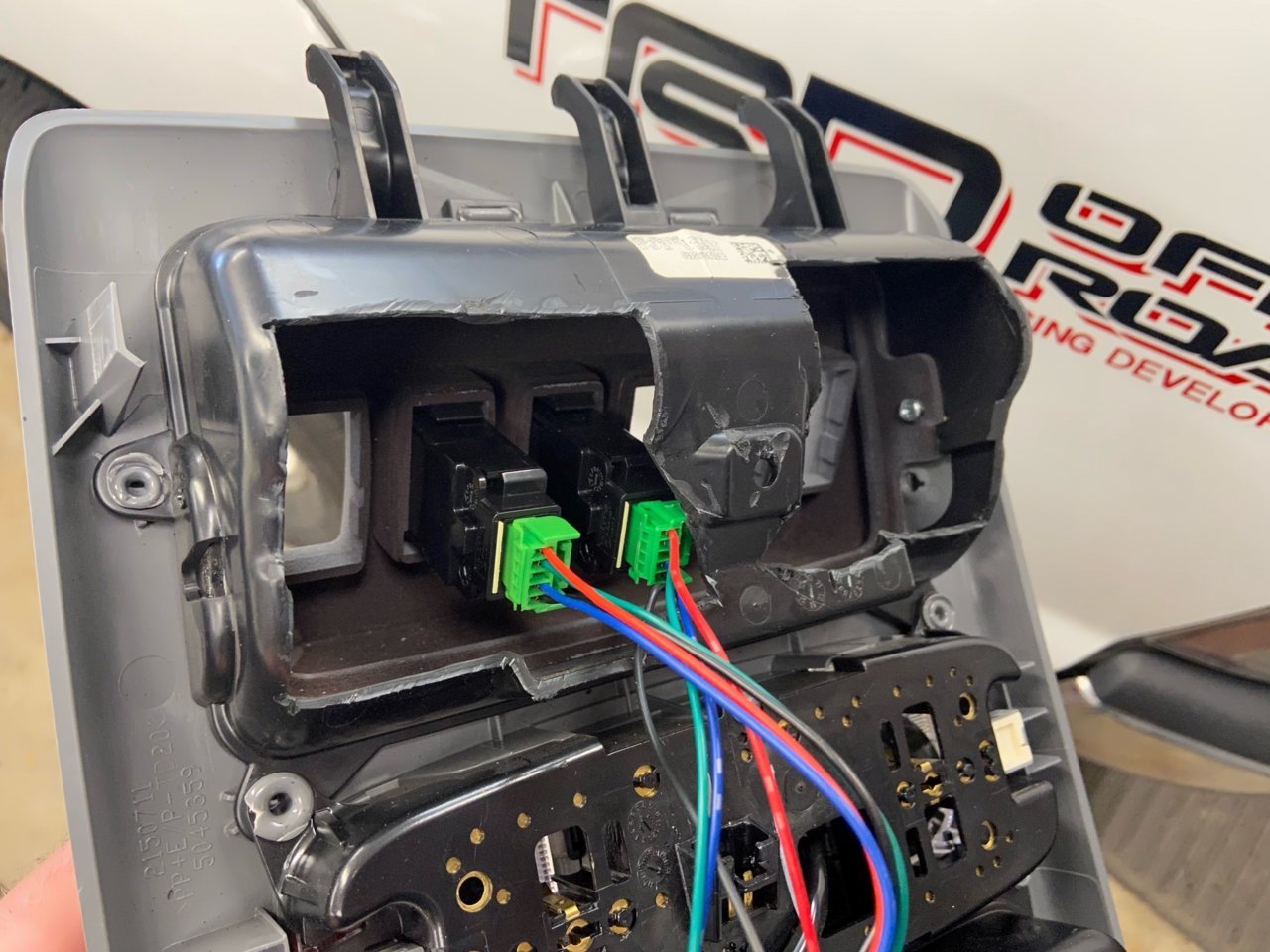

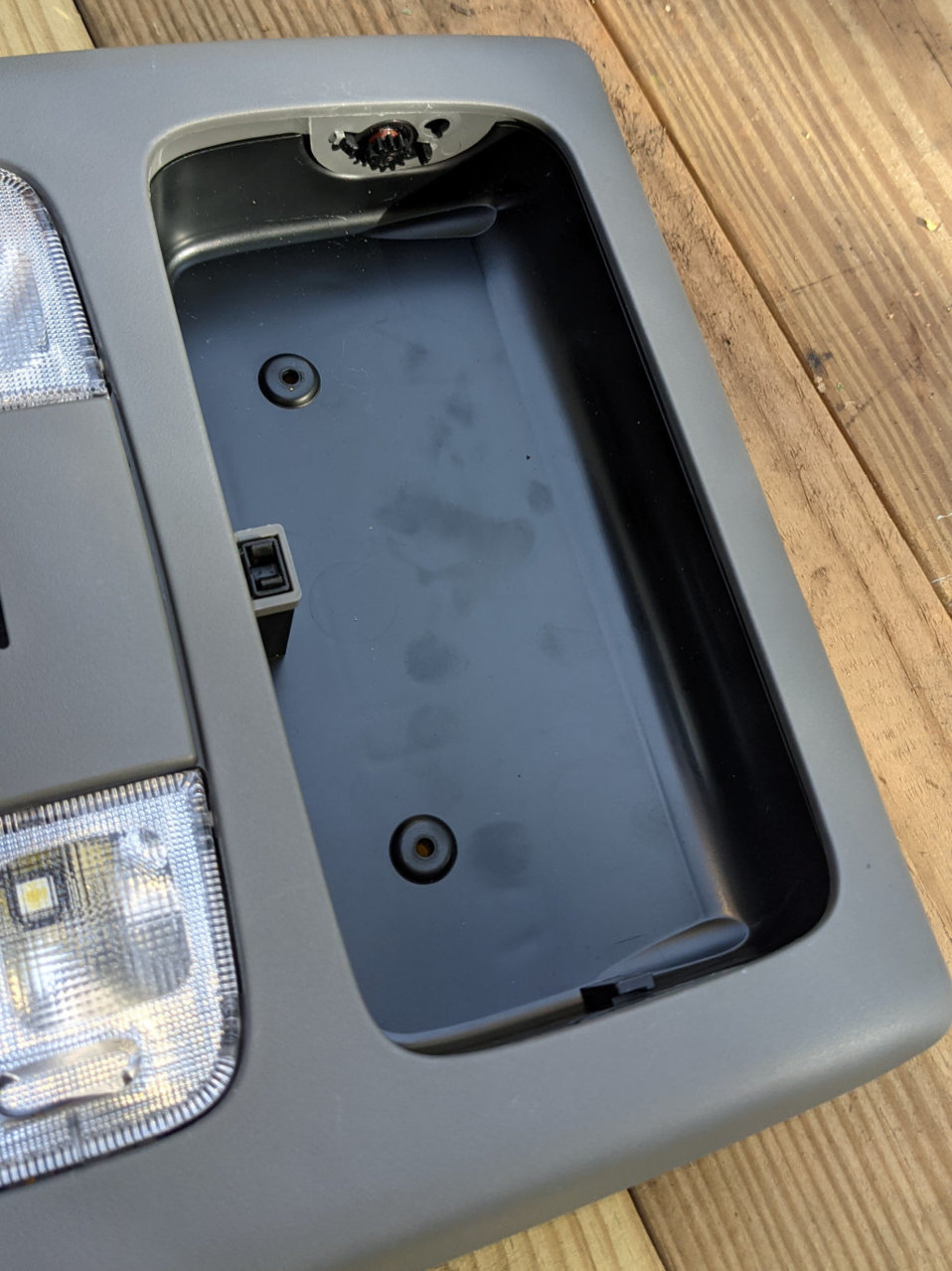

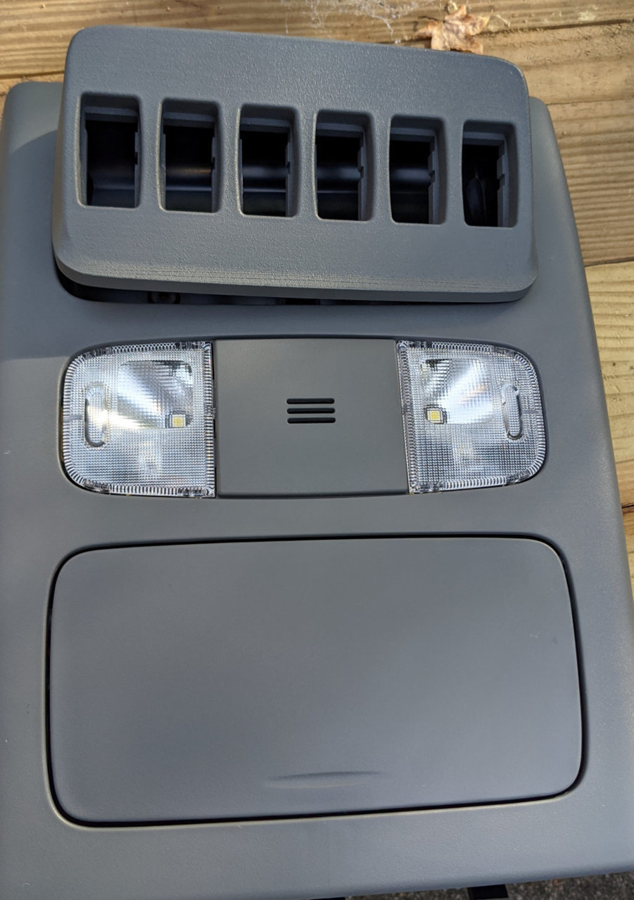

    I just received my overhead switch panel OHP6 for my 2015 Tacoma (2-gen).
    I'm having problems installing it. Unless I am doing something very stupid, the panel just does not seem to fit.
    The panel does not even seem to be shaped right to go into the space where I took out my old sunglasses holder. What am I doing wrong?

    You have to cut out a great deal of the inside plastic and drill holes to mount the screws.
    I have one and it looks exactly like that. Some surgery with a dremel and it works great.

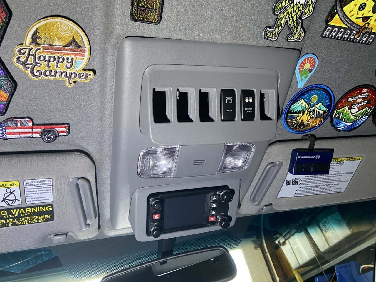

    Here is what it looks like installed. I also had them custom build me a FTM400 ham radio mount for the front.

    Yes, some slight modifications to the backside of your overhead console will be necessary. It’s a tight squeeze but it will fit! The 2 ear tabs on each side of the new panel are for mounting. Once in the hole you can put a screw or nut/bolt though the factory backing and into the panel to secure it.

    That HAM panel turned out solid!

    Anyway, here she is:

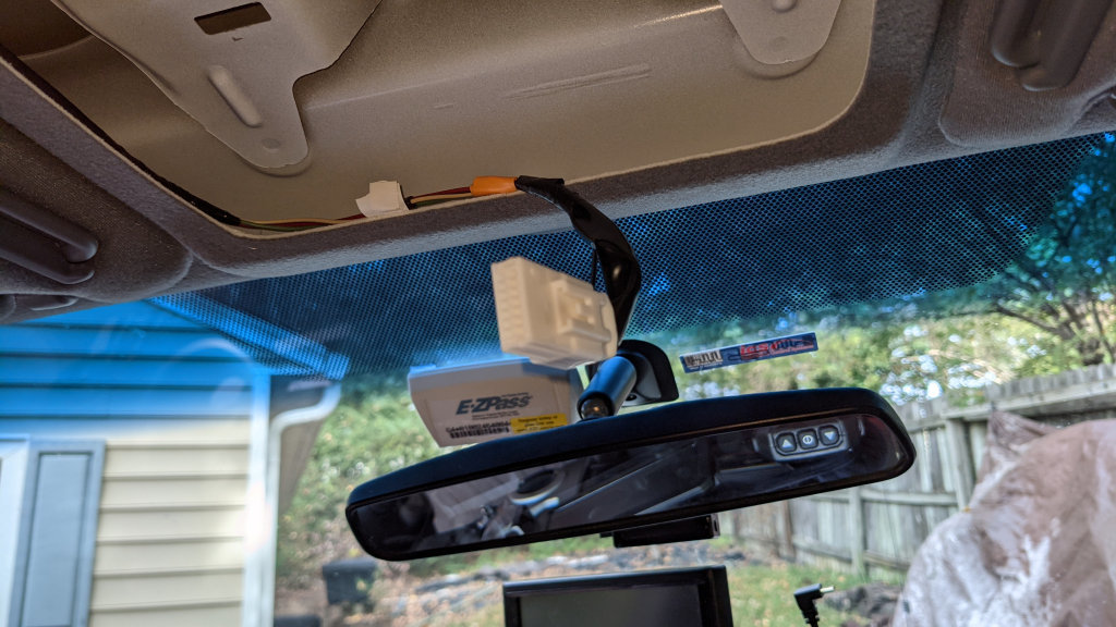

    BTW, When I was up in there I found a big plug that was not connected to anything. I assume it's for an option that I don't have. What is this supposed to connect to?

    Looks like you don't have the backup camera in the mirror? Maybe that?

    Could be. I have the Entune system which has the backup camera on the head unit screen.
