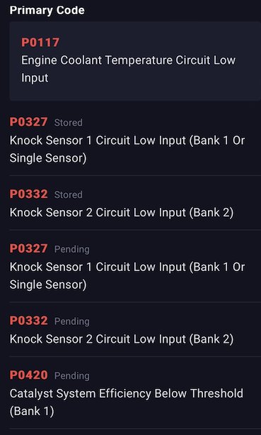

    2. I put the scanner on it and live reading was around 250*. I did nothing until it was around 185*. I didn't check the time but I'd guess 30-40 minutes. Codes are below.

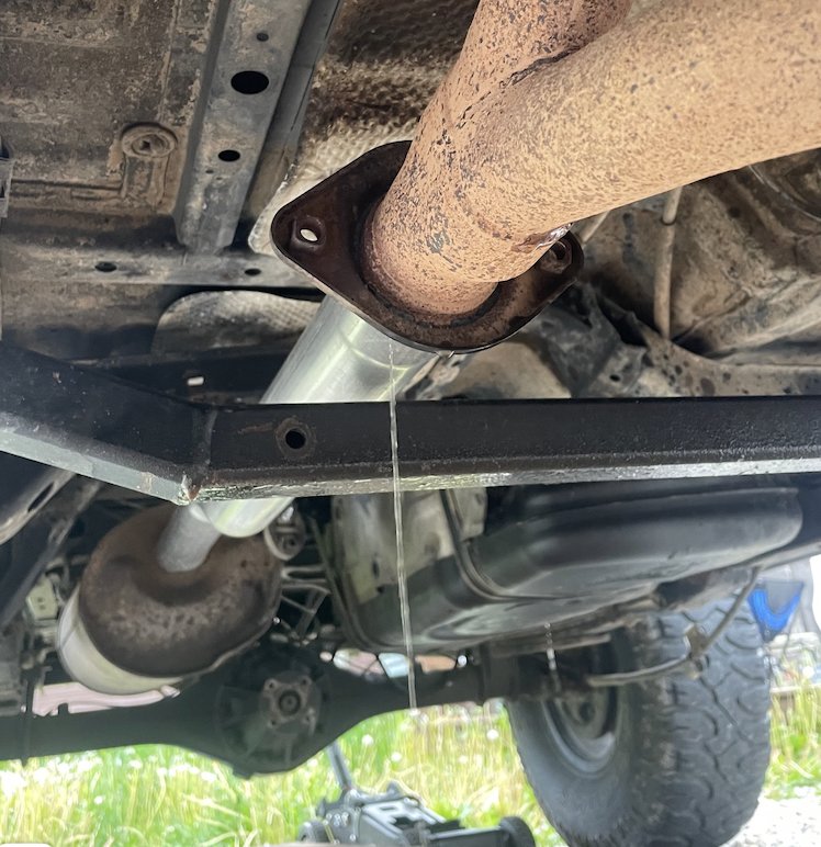

    Cylinder 1 has 60psi compression. I have it at TDC and was going to do a leak down but my air source isn't working. However, while the coolant overflow looks good the radiator wasn't full. Well ... here is why it won't fill up. Going straight through to the exhaust. HG or cracked head. :annoyed:

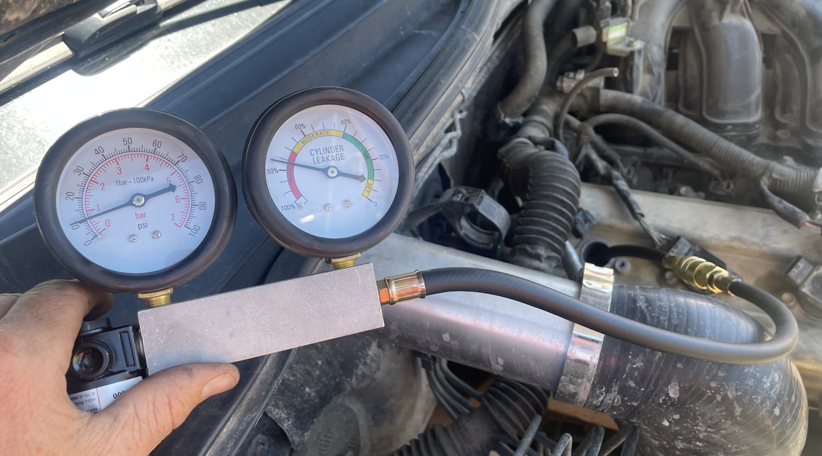

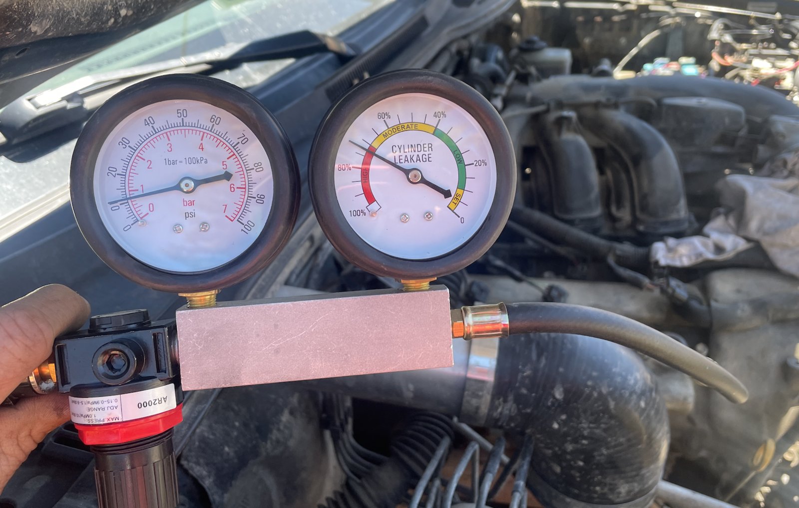

    leak down results for cylinders 1, 3, 5 verifying each valve is closed for the test ... all 3 results were very similar between 70 and 75% leakage just in the red. I could do the other side but is there any reason? I could hear the air hissing out but couldn't isolate it. Based on the pic above it's going direct to the exhaust.
    cylinder 1 ~73%
    cylinder 5 ~ 77%
