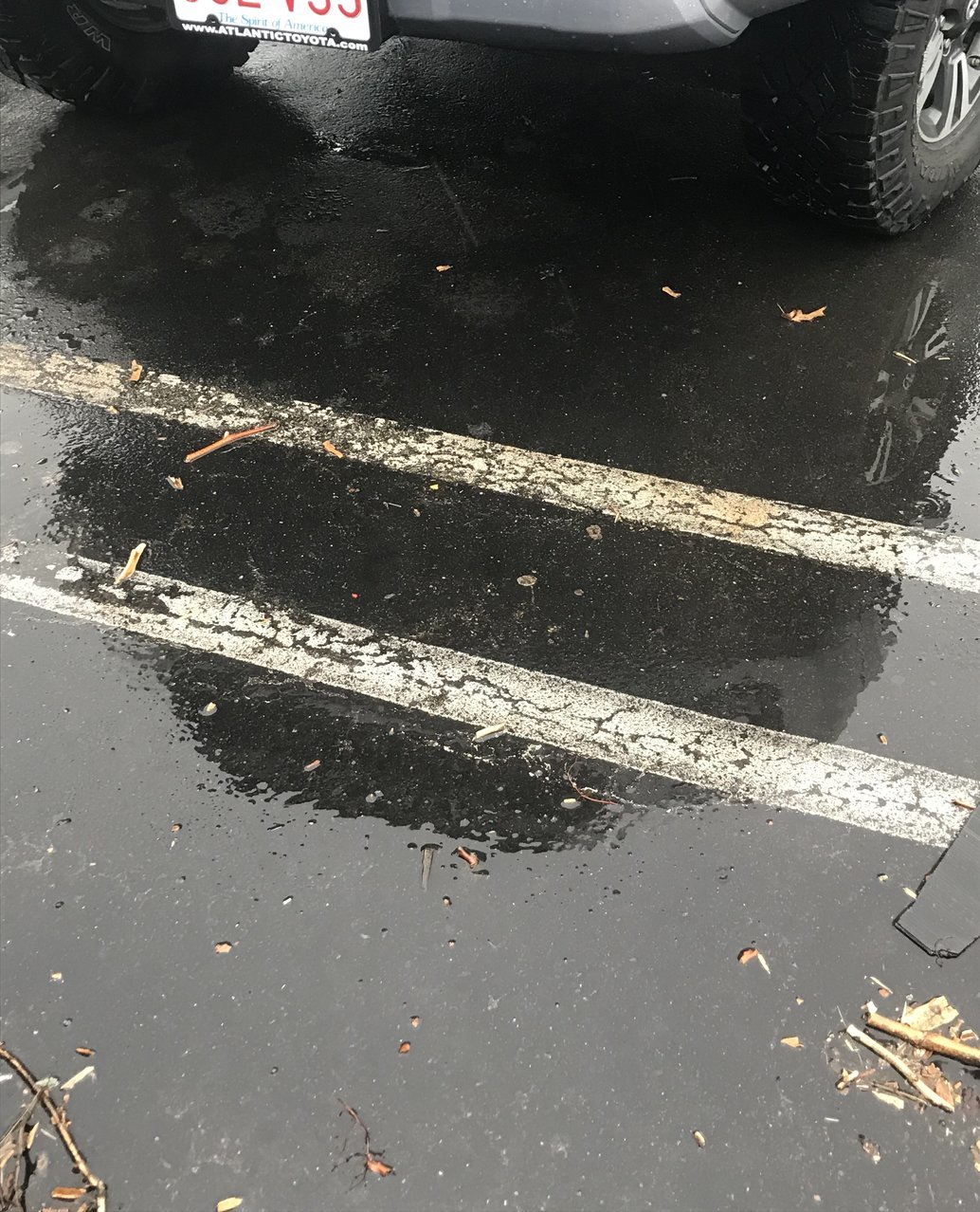

    just pulled into the dealership. Over the summer i had the radiator crack and replace under warranty. No heat this morning and on the drive home in the afternoon she overheated and had to shut it down. Its rainy with sleet but i dont see any coolant on the ground.

    Assuming this is the first time since you replaced the radiator, I would check if there is anything in the radiator/puke container. If all seems normal I would say the likely culprit is a bad thermostat.

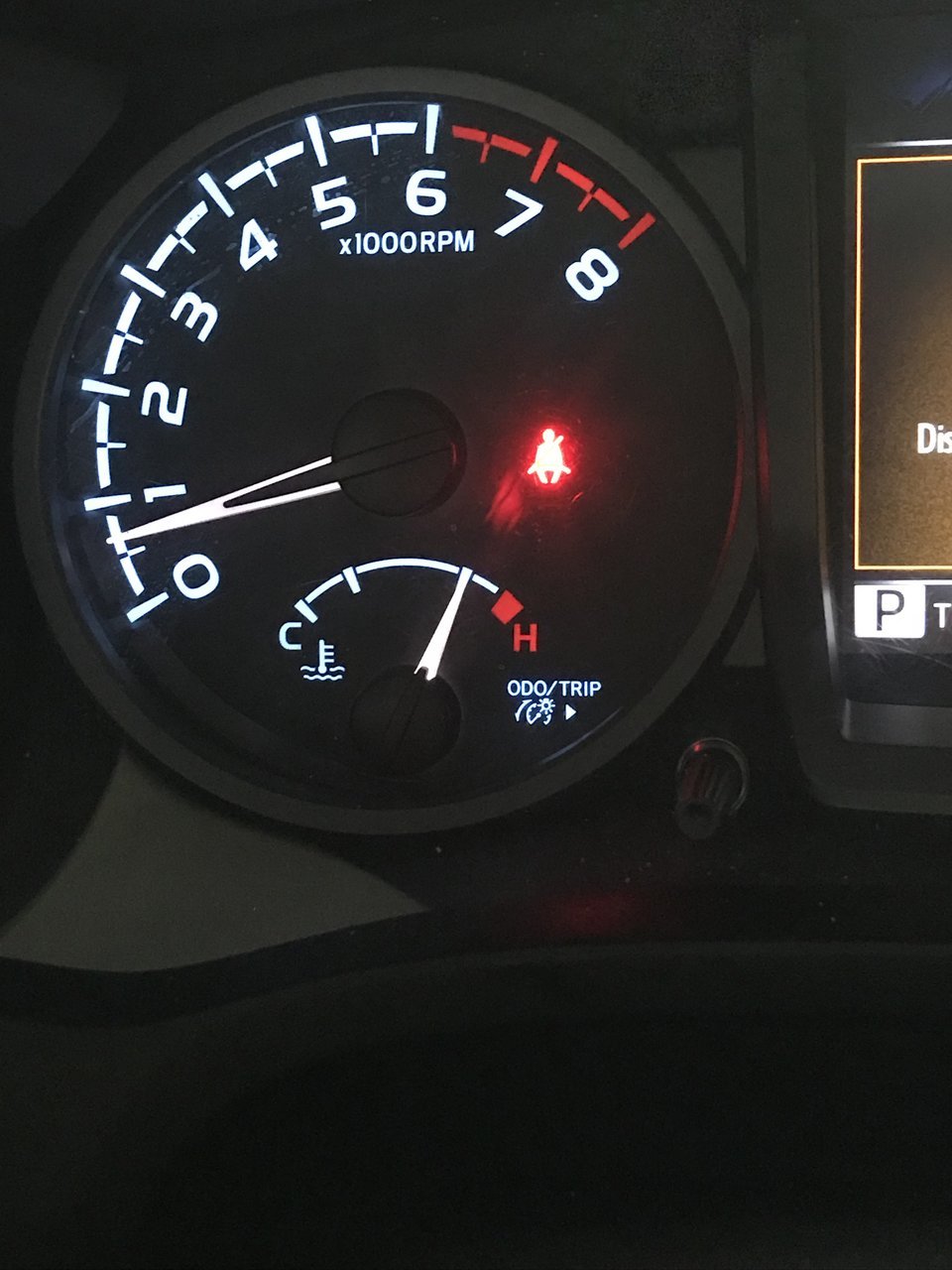

    C24D6459-7634-4F58-B137-08472F8813E9.jpg Shes not bleeding. No coolant in the tank either. Bad thermostat?

    If the water pump isn't making a odd noise I would rule it out. The thermostat is probably not opening if there is nothing in the puke tank and no heat in the cab.

    Might want to have the coolant tested for combustion gasses. if there is no coolant in the recovery bottle you have issues it had to go some place. let the engine cool down and pull the radiator cap and check the coolant level. if its extremely low call the dealer, if its a little low take it to the dealer. What ever you do don't add coolant unless you call the dealer first. Otherwise you get the "looks full to me."
