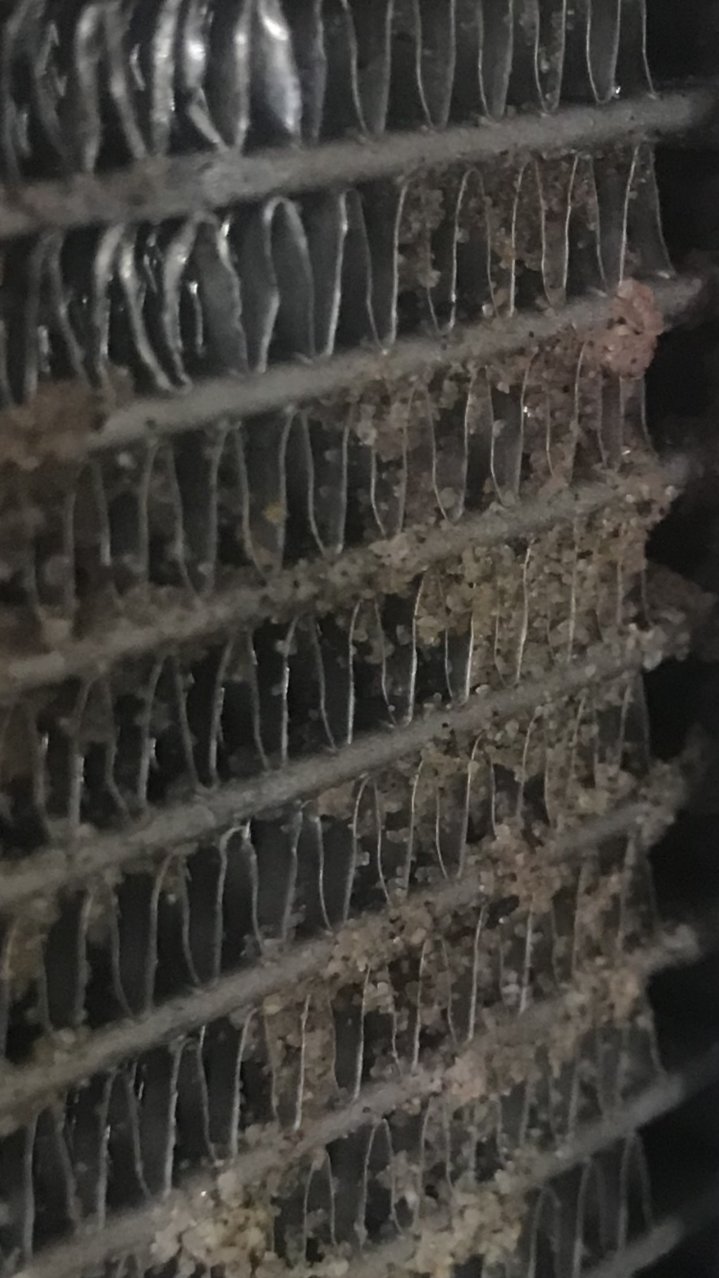

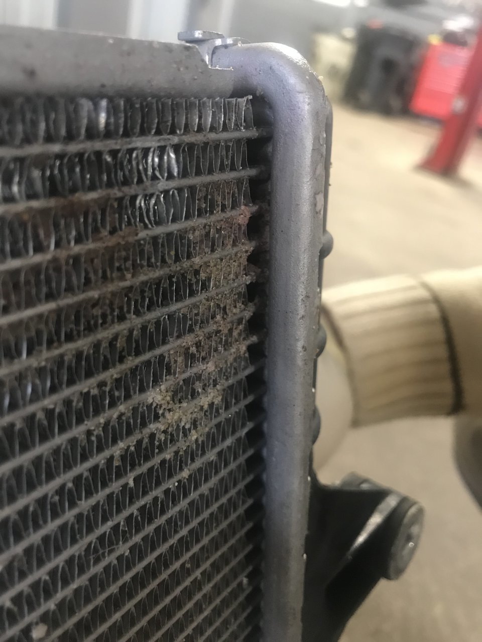

    C089091E-19FF-4CC0-AAA6-E5CA15956FF9.jpg F6996F26-3B0C-4EB5-A213-D1E249AC4937.jpg Ok, you guys are not going to believe this. The new radiator is leaking. Thats right. The third radiator is now leaking! I came to pick up my truck at 4 and they told me the new one was leaking while the truck was parked. They have to order another one. Obviously Toyota is having a problem. Now with the snow storm bearing down I wont have the truck back till Wed. Hopefully the gay highlander can handle 18” of snow.
    I asked for the second radiator to take a pic and post here. So 20 minutes later the parts guy comes up with the second radiator. There is no visible crack. Only maroon color rusty mark passenger side right. That antifreeze steamed away! I didnt even smell it and didnt notice a problem until the truck overheated.
    If there is anyone here loosing antifreeze in the 3rd gen and you cant find any leakage or the source? Its quite possible theres a leak on the seam where the aluminum fin is attached to the plastic. I dont know if its welded plastic or expoxied.
    I asked the service manager to pressure test the new radiator when it comes before it goes in. I also will ask for the second radiator so i can cut it apart and look as to why.
    This is bullshit and Im sure this is a vendor that is making the part for Toyota but come on man make it right!

    They also need to check for stray voltage in the coolant. You may have an electrolysis issue.
    Drunken Chewbacca likes this.

    F78FDE9C-277E-49EB-83AE-FFB4DF5BFAD0.jpg Closer pic of the red crusties.
