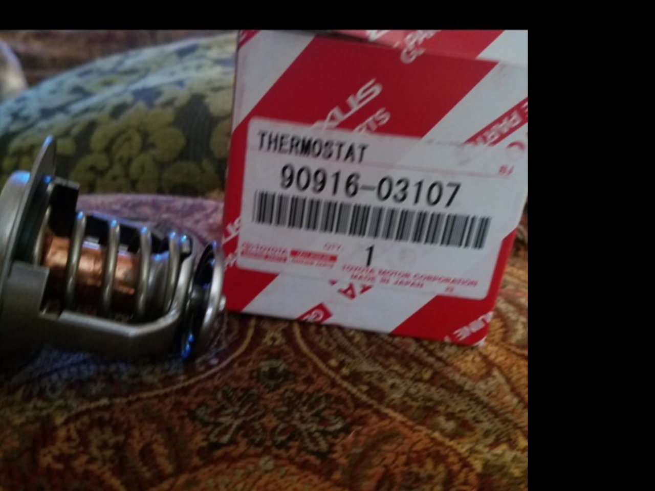

    I would get the 170 corolla stat from the dealership,
    Mine failed from advanced auto 3 months later,
    The Toyota one is so much better in quality
