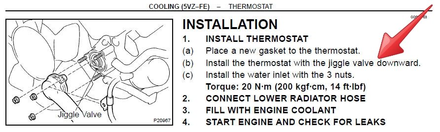

  19. Nov 21, 2013 at 11:30 AM
    #19
    Dirty Pool
    Dirty Pool FLIES ON THE FRIES, KETCHUPS WATERED DOWN
    Mar 24, 2013
    #100471
    2,266
    59.4 Miles, 56.67° NE Of Moab
    99 XCAB V6 MT TRD
    Dirty Pool rear bumper/air tank with integrated spare CV shaft storage, DP customized TJM front bumper, 8000 lb Ramsey/Technora rope, E-locked, Extended breathers with front diff catch can, PCV catch can, SAWs with DP heim joint seals, DP custom 6 leaf rear springs/Billies, DP custom skids, 2lo, Gray wire, Cap, Bed Rug, Black steelies, 01 Center console, Map lights, Disraeli gears
    See the red arrow. It is widely documented (via ScanGuage) on this and many other forums, that the 5vz-fe will run about 10 degrees hotter with the jiggle valve in the "up" (wrong) position.
    e89abd99-5d3d-4e9e-ab8d-44d2296c42ef_zps_6791b275e5670456bcabf6dd42f04bc1cff23918.jpg
  20. Nov 21, 2013 at 11:41 AM
    #20
    JLee50
    JLee50 Well-Known Member
    Nov 20, 2013
    #116986
    391
    Phoenix
    Stockish 99 4x4 TRD
    ToyTec coilovers
    Factory service manual FTW. ;)
    Thanks Dirty Pool!
