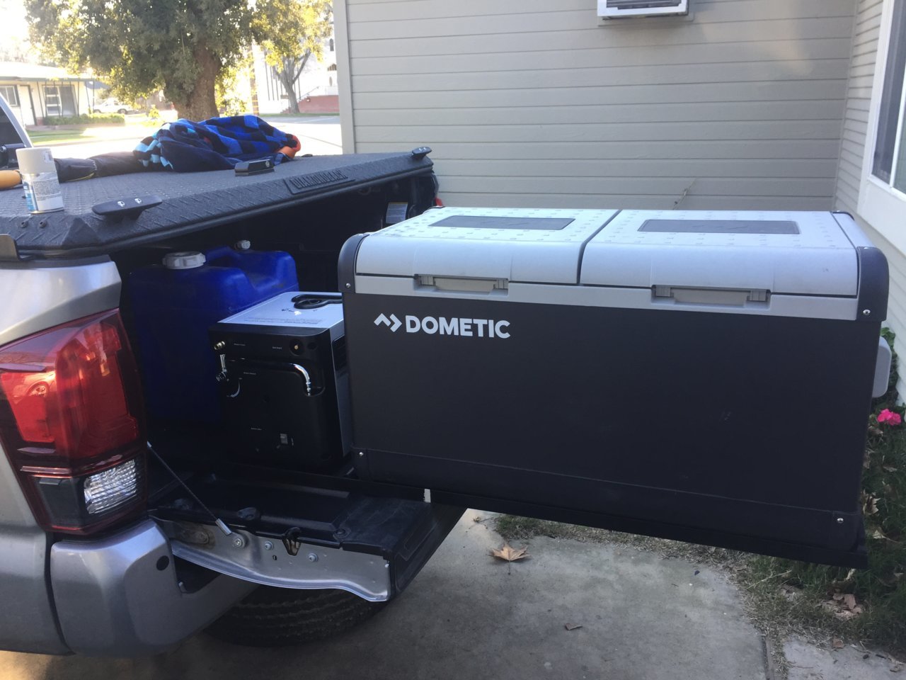

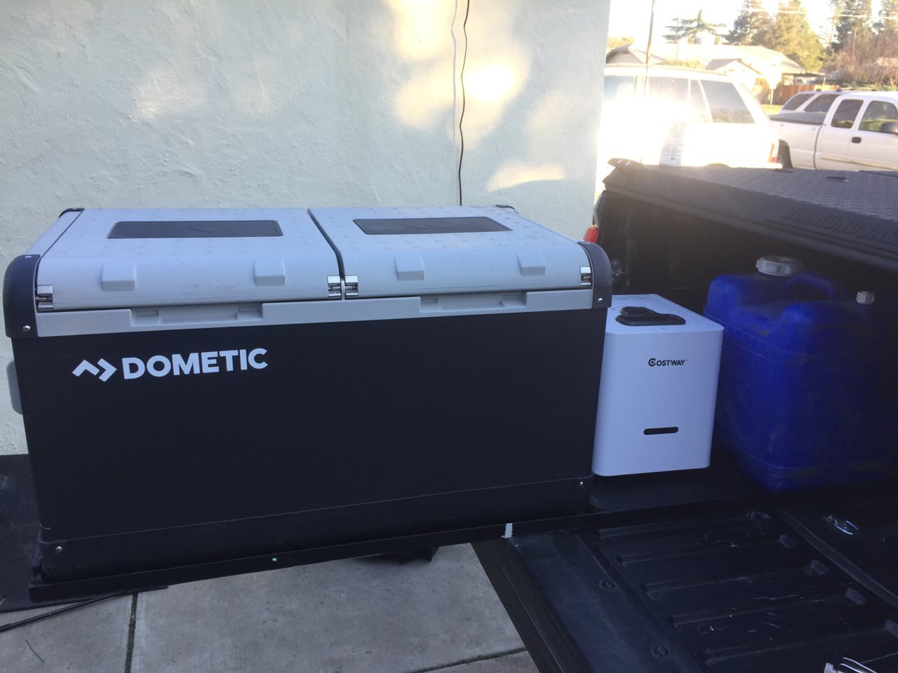

    Finally finished a little DIY bedslide. I needed a very low profile slide to allow my Dometic fridge to fit under the cover. I made a basic frame out of angle iron and 3/4” square tube. Had it welded together and I riveted aluminum to the base. Slides great. I used two C-channels to hold down the front when it slides out and it works great. I have the fridge, hot water heater (depenses cold water too), and water tank. My camping set up goes in and out of the truck, so everything is easily removable. I was just tired of sliding the fridge out on the tailgate to grab stuff behind it043842AC-ED7C-4DB2-A4D7-7C2D6D0667E5.jpgF9CA0E55-3EDD-4DD1-B52B-041E2CAE1E57.jpg87132627-BE8D-4D59-A999-F8E798F0D8AF.jpg

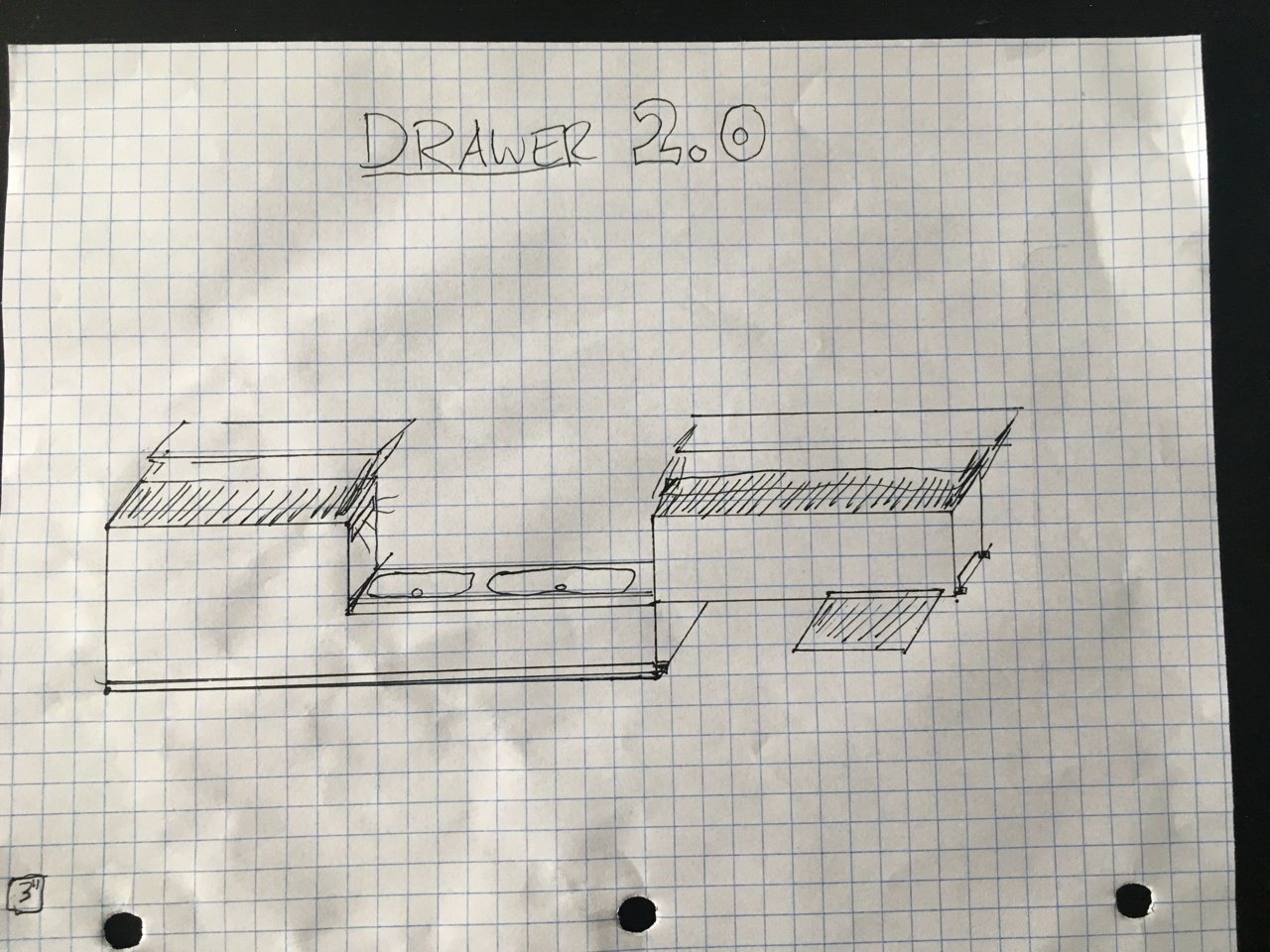

    Thanks for the kind words. The design has been totally fine as glued 1/2” nailed joints. I just got back last night from doing the Mojave Road again, and it did great. The only changes I would make to this drawer is one locking slider instead of 2, because it’s a touch awkward to push down on the knobs and pull to get it open. I usually pull it open like 2” and grab the front plate to pull open, but if you are on an incline it can be a little weird. 1 locking slider would free up a second hand, but the sliders are only sold in pairs. The drawer is heavy and so getting it in and out for me is tough, so I use my RTT hoist I made.
    I’m actually building my 2.0 version of the drawer with 80/20 extruded aluminum right now. Hopefully less weight and more utility as well. So I’ll be selling this drawer soon.

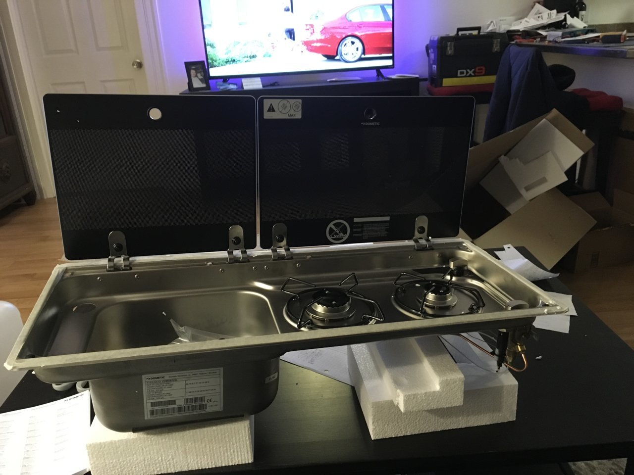

    Drawer 2.0
    With this design the upper storage area slides to the right to reveal the sink and cook top
    230E009B-F88B-4E61-AF8F-601E5CB4F69C.jpg 0C3DACE8-2645-486D-B47F-4E9C06F6167D.jpg
    My new sink/burner combo made by Dometic

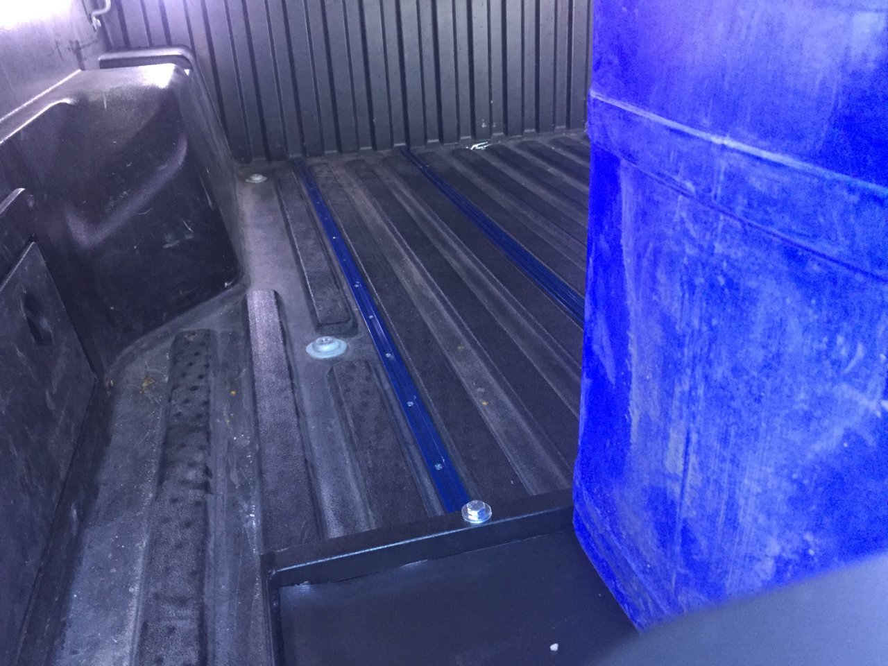

    Papadave, my box is almost done! It should be ready this week (pics coming). I want to mount the d-rings in the center of the bed. I found very thin metal near tailgate and can't seem to find any near the front of the bed. How did you mount them?
  16. May 1, 2019 at 10:03 AM
    #136
    Papadave418
    Papadave418 [OP] Well-Known Member
    Jul 17, 2017
    #224251
    1,938
    I mounted with washers to the composite bed, it’s pretty tough. If I did it over I would use Rivnuts. But I’ve had no issue with just to the bed.

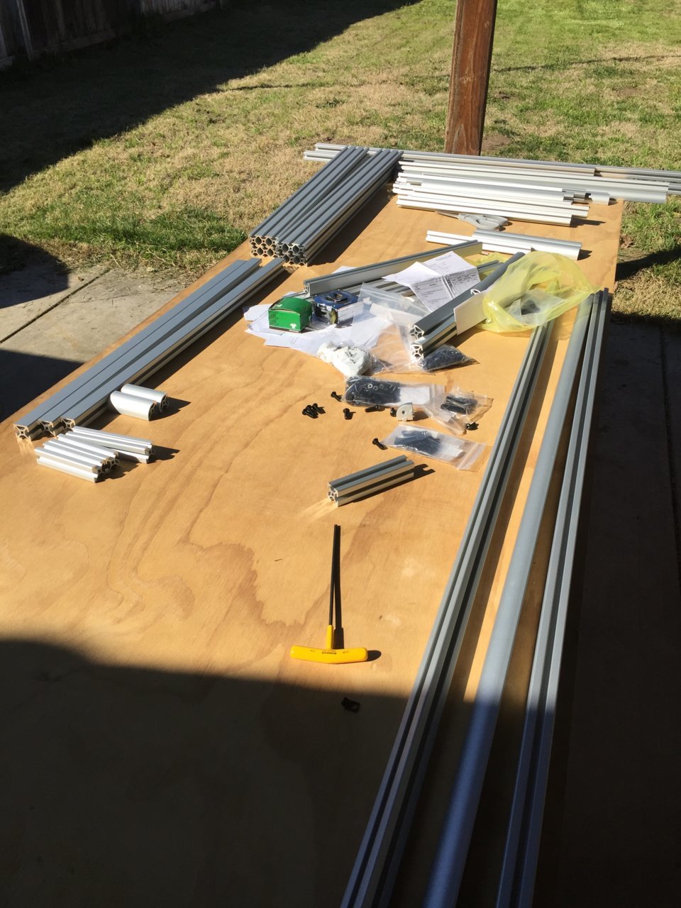

    Finally got to work on my drawer, it’s coming along
