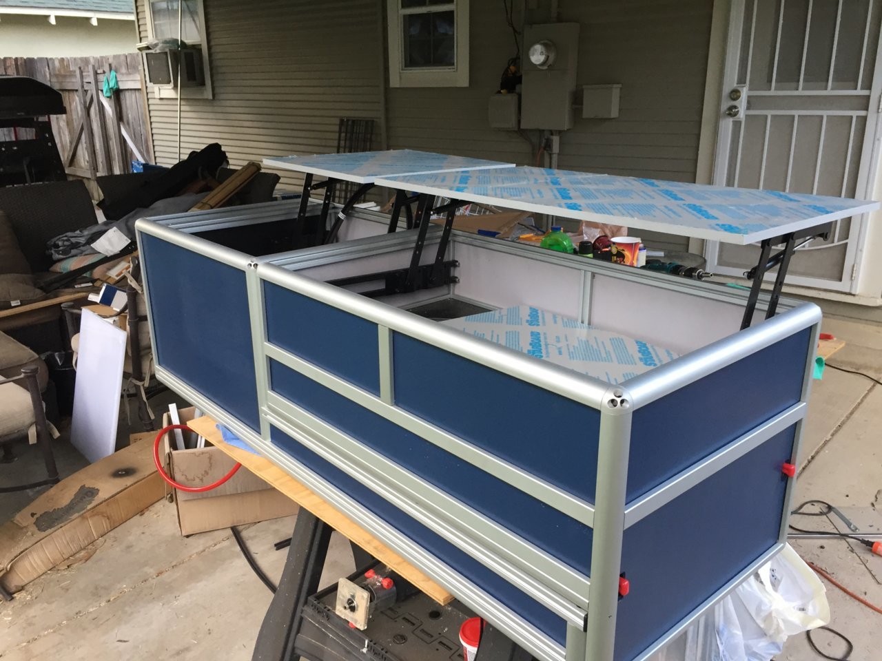

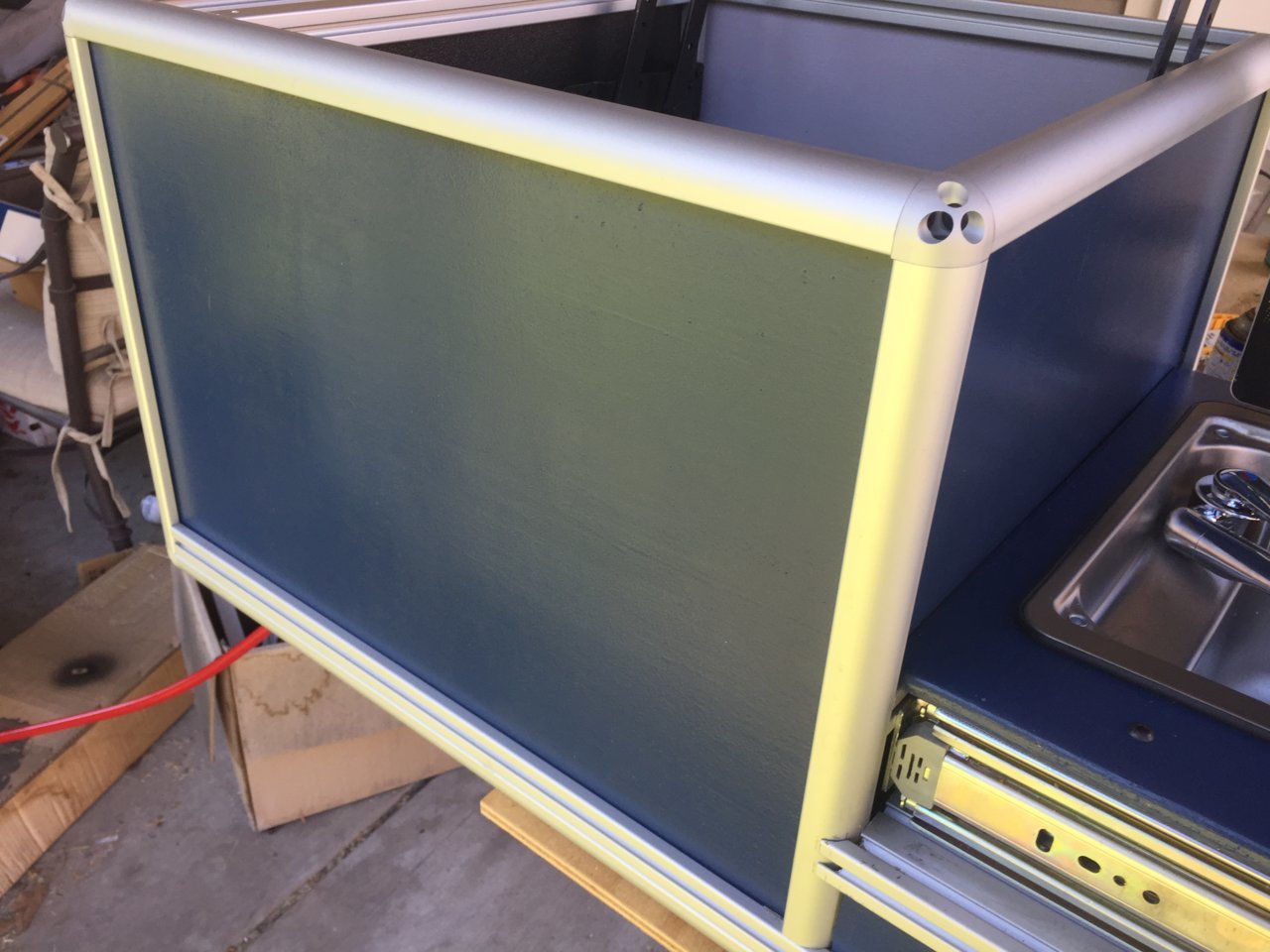

    Design looks excellent so far! What kind of material are you putting between the extrusions (the blue stuff)? Whats the weight capacity of the setup, like can you stand on it without it giving?
    I have a camper above and have always wondered how these extruded cabinets would hold up as a step
    burrotaco likes this.
  3. May 28, 2019 at 11:29 PM
    #143
    Papadave418
    Papadave418 [OP] Well-Known Member
    Jul 17, 2017
    #224251
    1,938
    The black bottom of the cabinets are 1/4” HDPE which I would say is too thin to stand on. The frame would be fine and I’d say is strong enough. The blue sides are 1/4” ply (which is actually thinner than 1/4”) and they won’t carry any load like the bottom panels. If you built a cabinet with a top panel that isn’t inserted into the 1/4” channels than you could easily make it work for a camper

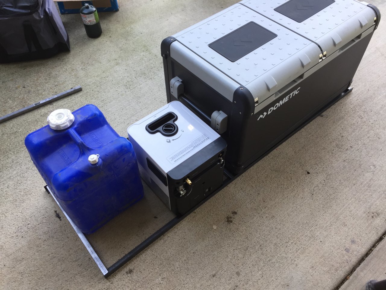

    Here’s what I’ve got.

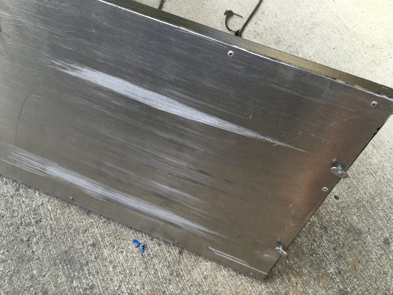

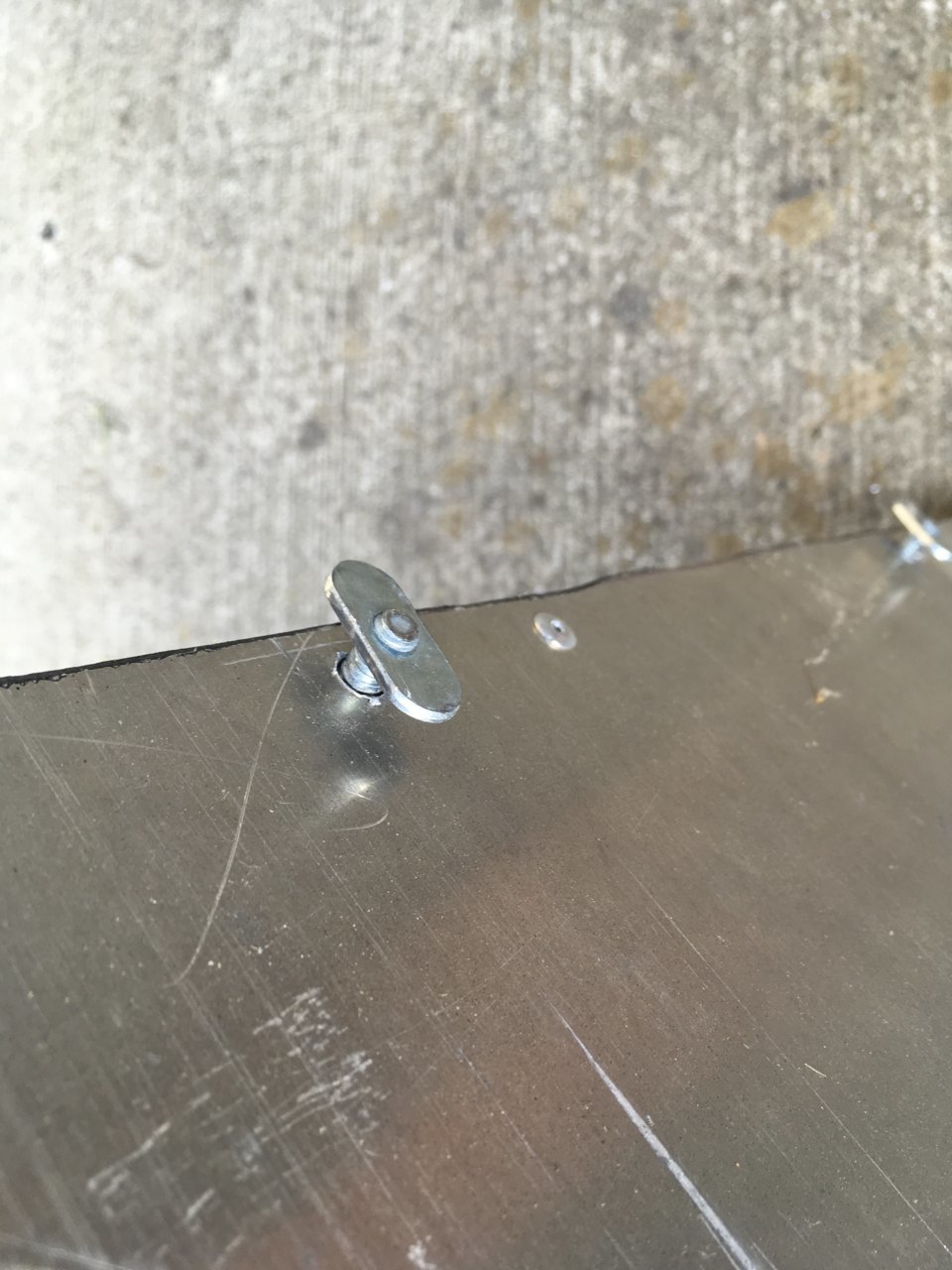

    I used 1/2” square tube for the cross braces, 1” angle iron for the long sides, and an aluminum sheet riveted for the bottom. Welded those together with a length of 56” and about 20” wide. I used two C channels that are normally for table saw guides, anchored those to the bed, and 1/4” T slot nuts to anchor the front end of the slide to the bed. I painted a gray line on the side for my maximum pull out distance. That way the slide doesn’t bend or disengage from the C channels. Hope that helps

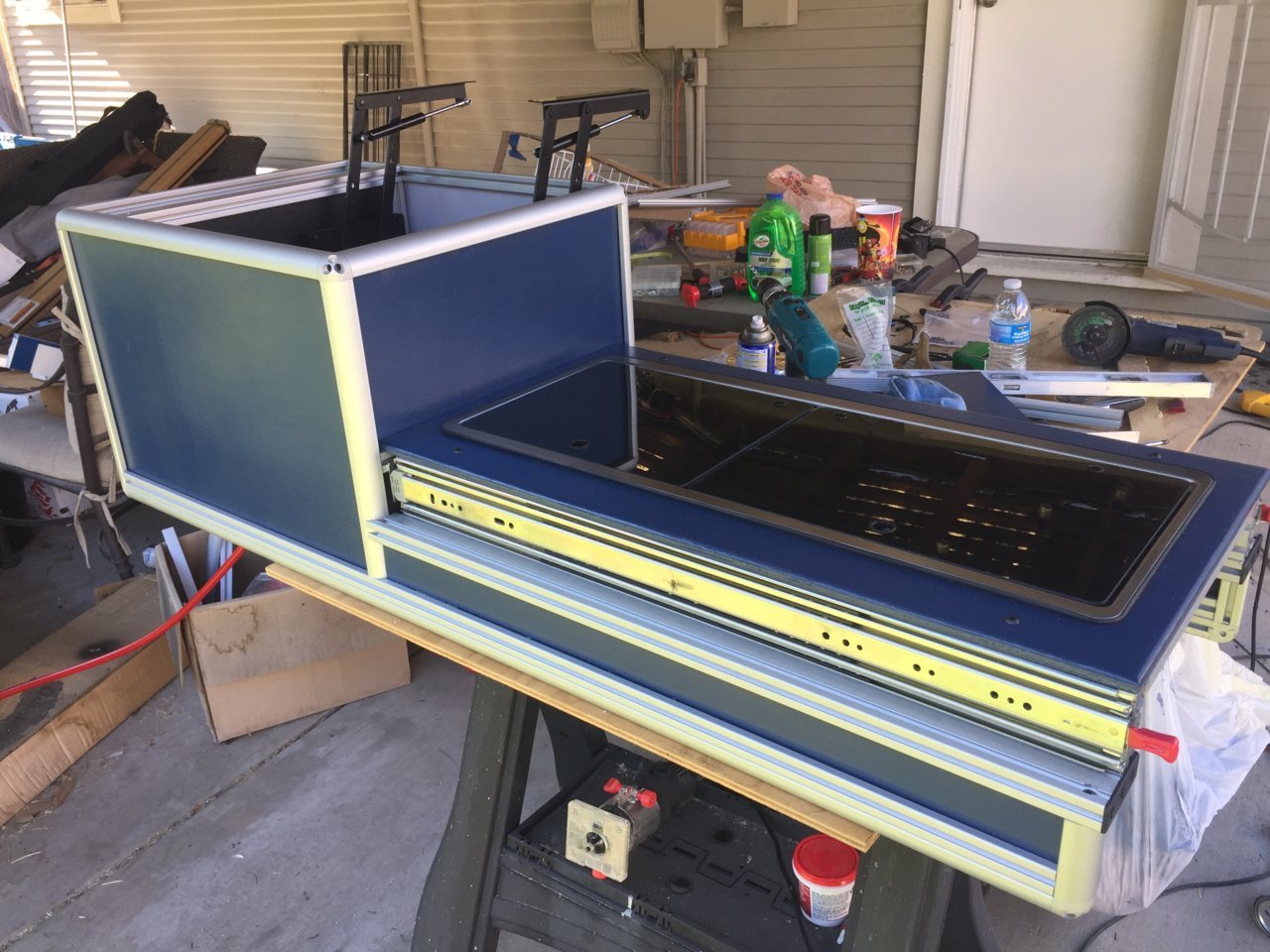

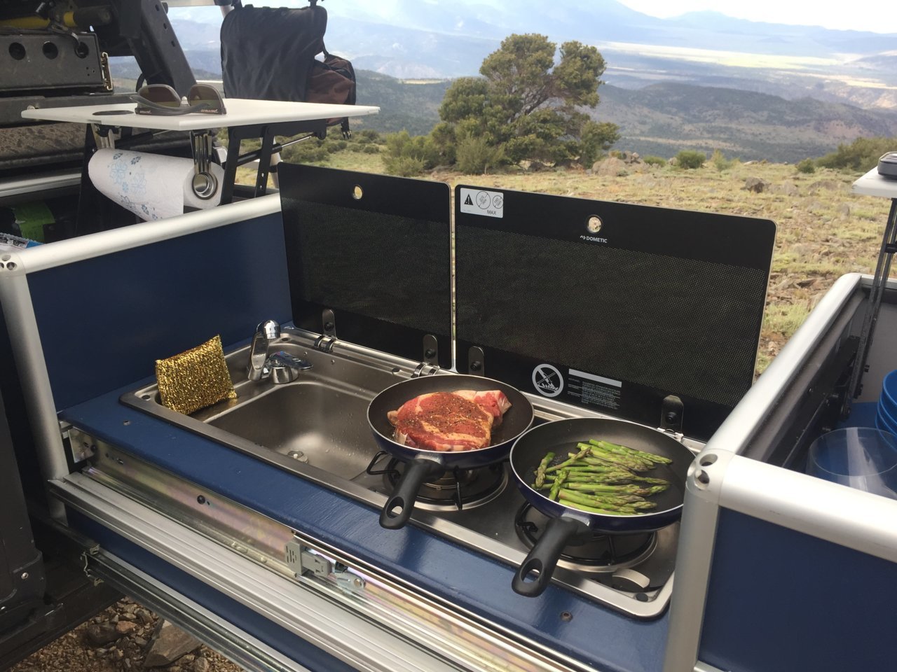

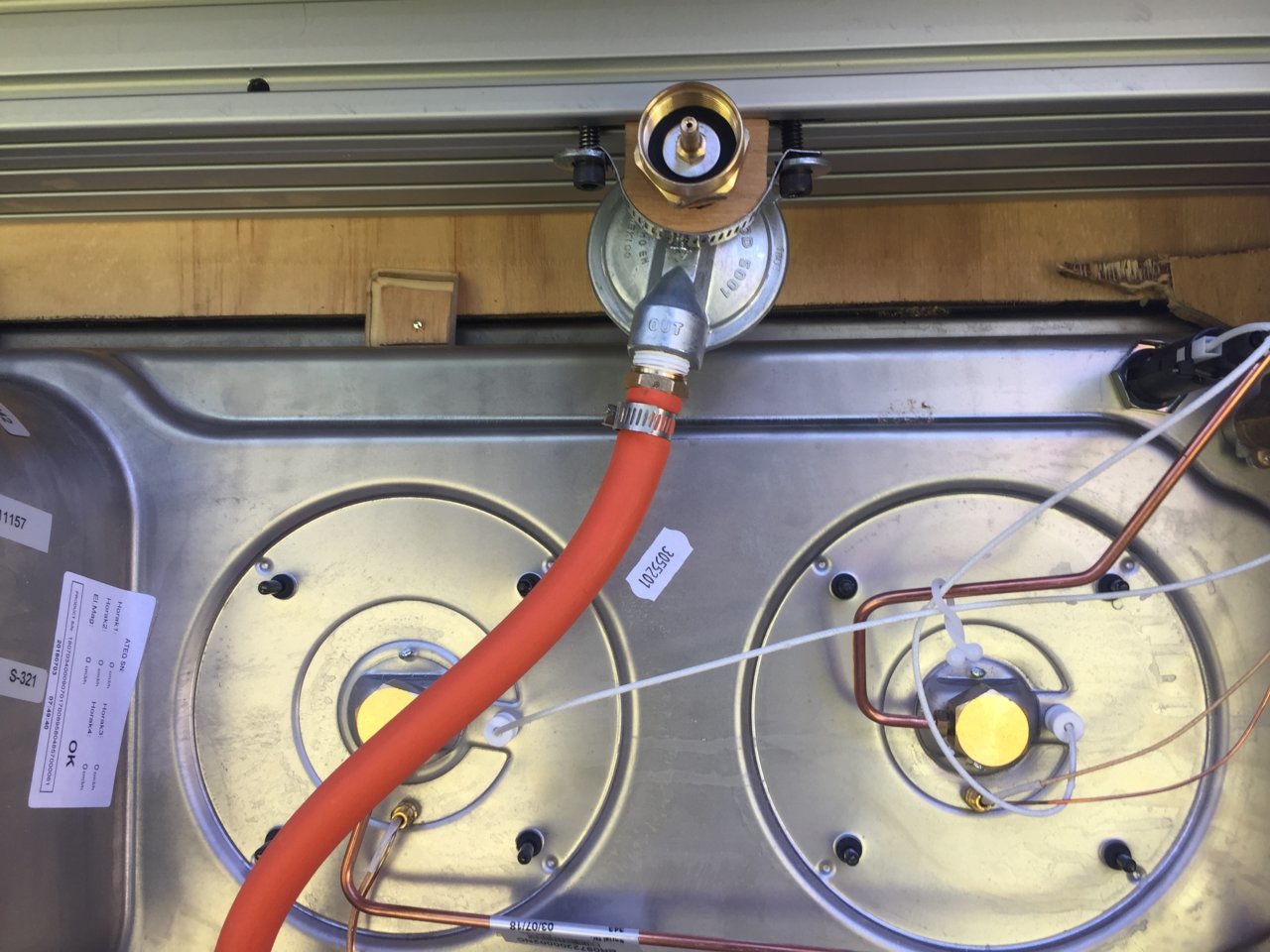

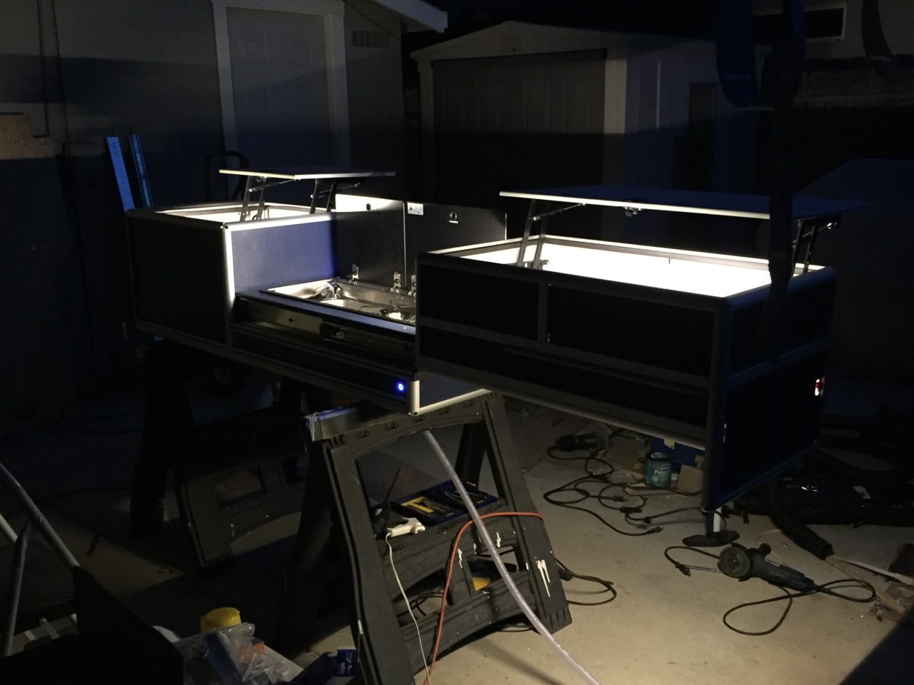

    Ok so yesterday was good as it’s finally starting to really come together. Trying to get it done by Friday for an Overland Bound trip I’m leading which currently has about 12 rigs. I’m excited :)
    (My back patio is trashed from this project, it will get clean eventually)

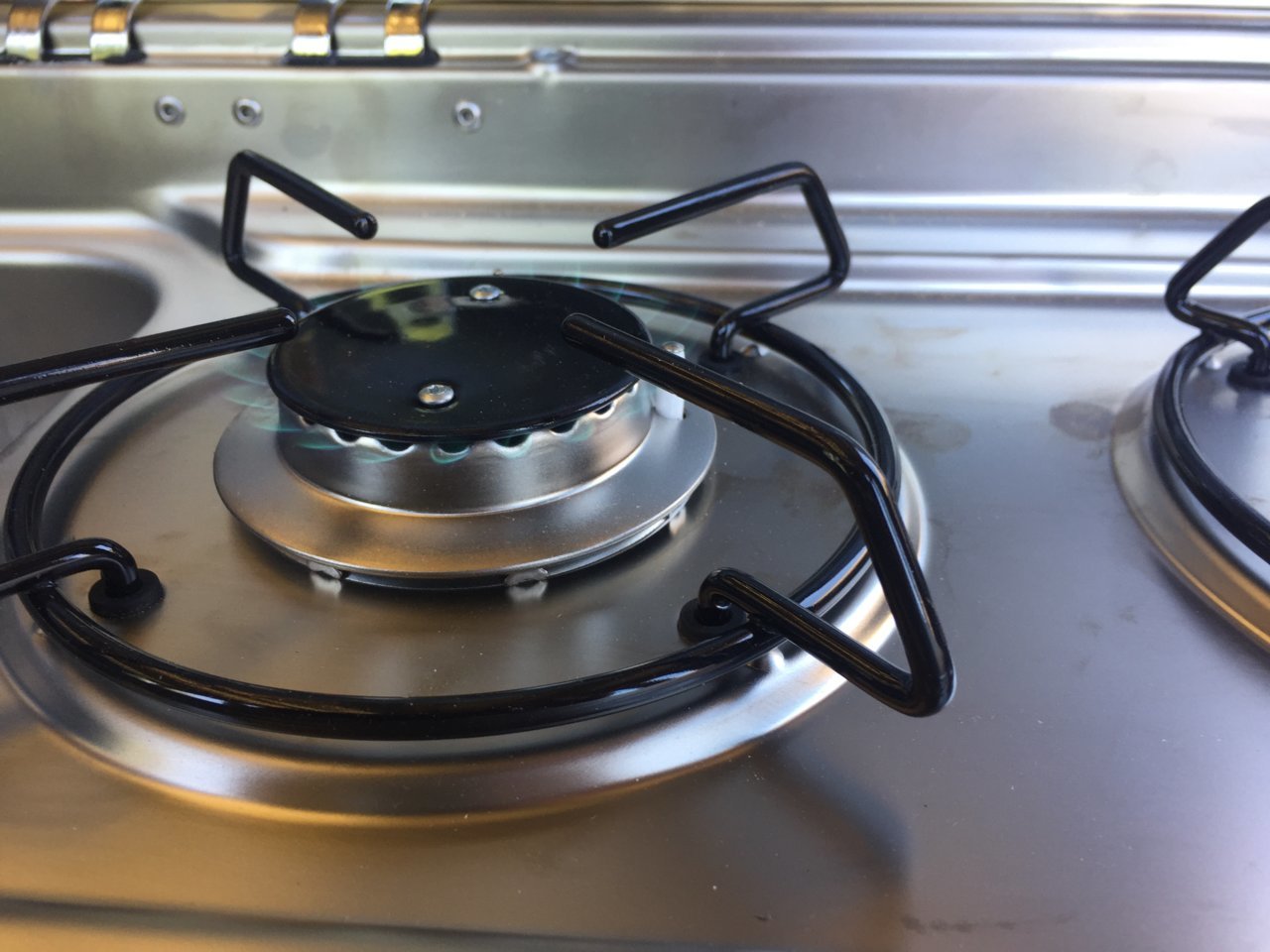

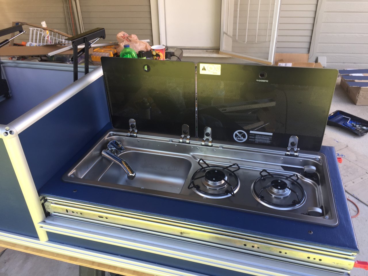

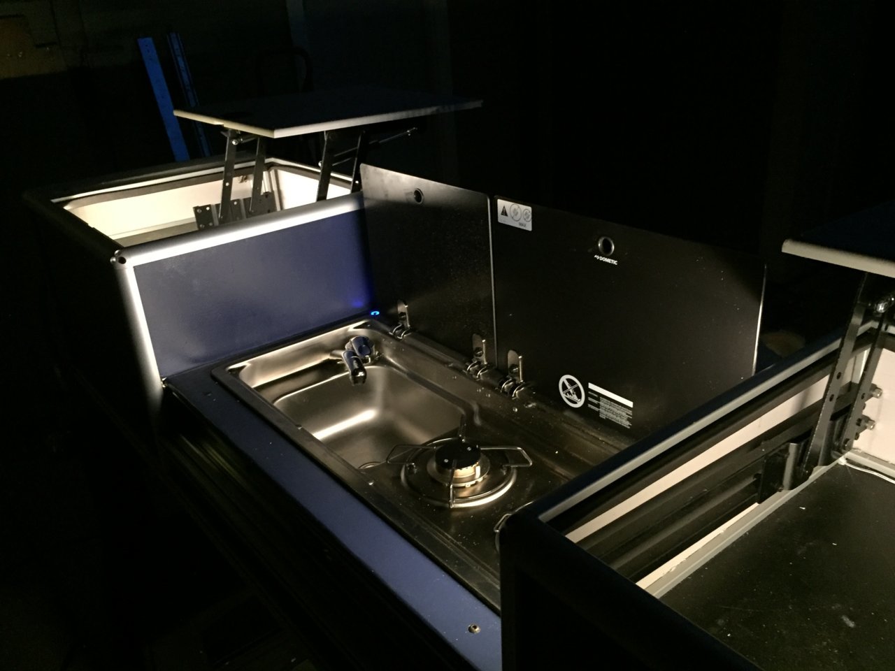

    Got the sink/burner top unit installed
    DD651D93-743F-4F49-B6FD-37F11AA56512.jpg 405B47BF-51DF-4941-929B-23B9A06B2937.jpg
    Currently I’m sticking with 1lb propane tanks and my plan is to screw in the tank when it’s open and I’m cooking
    Simple mount
    Finally FIRE!!
    Got on my last coat of PU
    Got the HDPE boards cut for the drawer lifts and now need to attach them and wire up the electrical

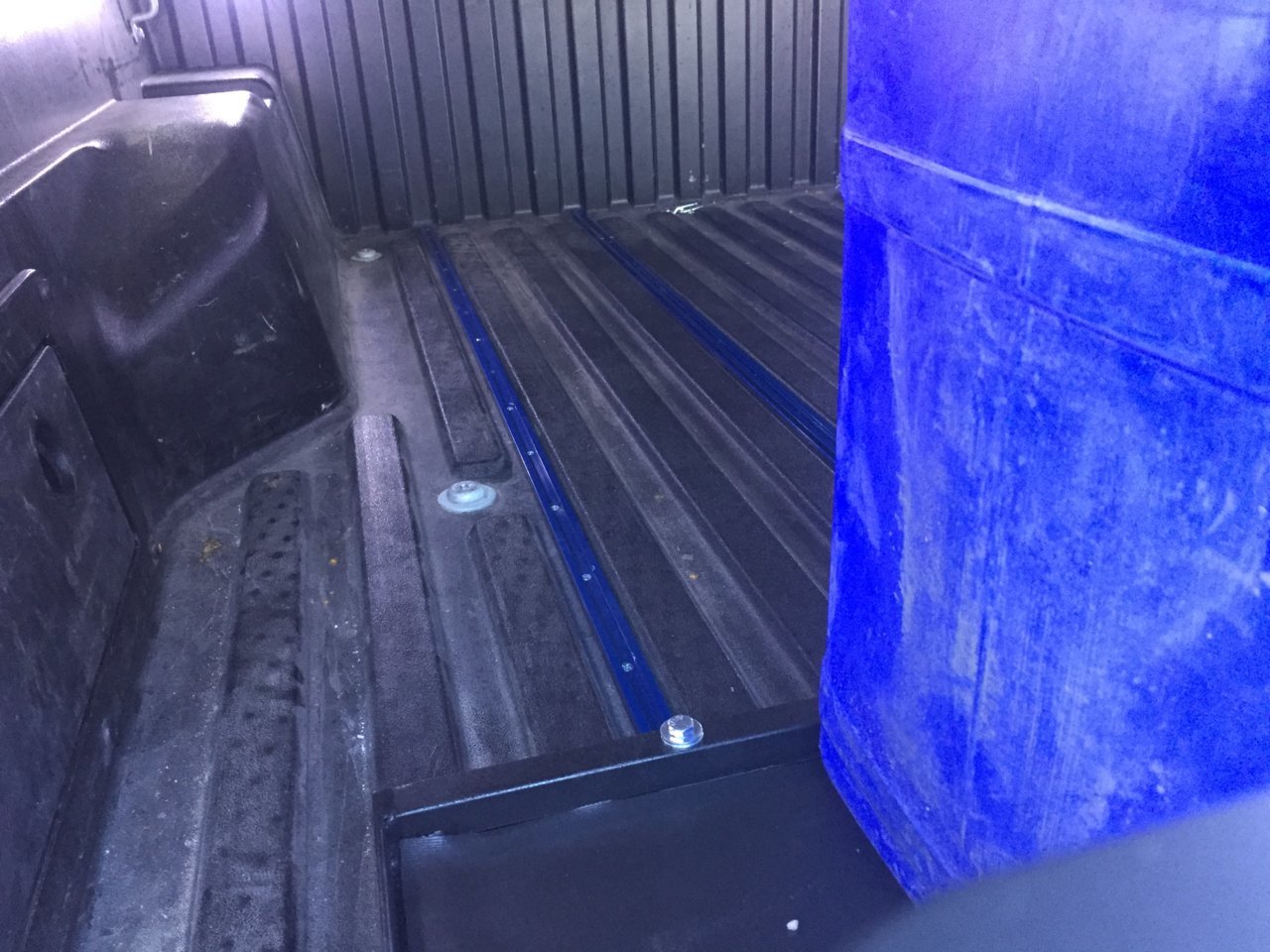

    Got my new bed mount worked out, previously I used tiedowns to anchors on the bed, which worked great. But this new design doesn’t have the outer box so I put some 3/4” bolts through the bed that the mounting plate catches to anchor it, and a turn buckle to keep the tension.
    This was fitting it, the gap in the bolt is gone, I added a metal plate on top to make the groove tougher, and hooks to hoist the mount and drawer if needed. And of course I painted it :)

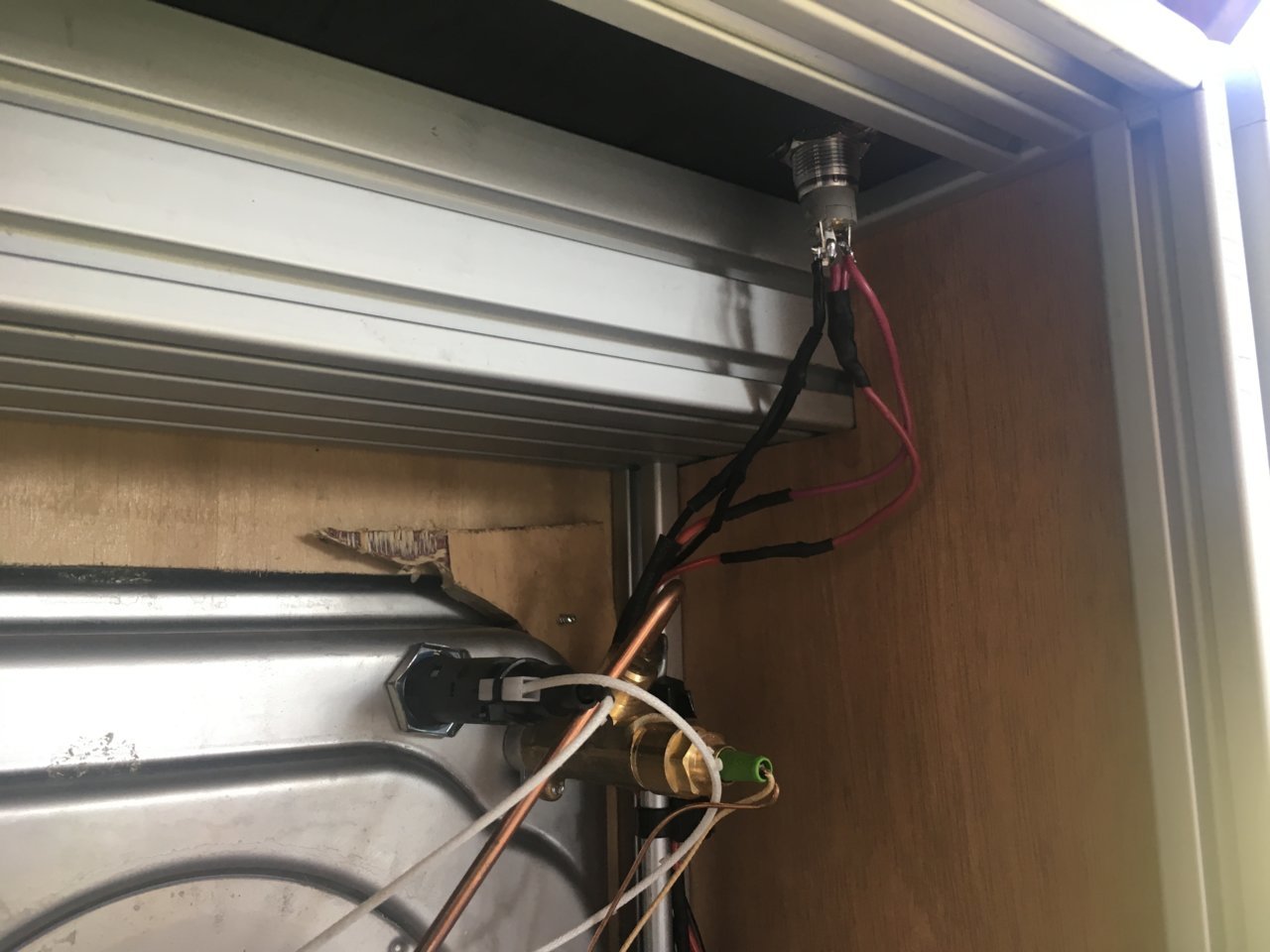

  13. Jul 7, 2019 at 7:51 AM
    #153
    Papadave418
    Jul 17, 2017
    #224251
    1,938

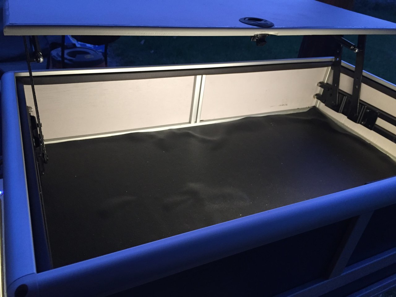

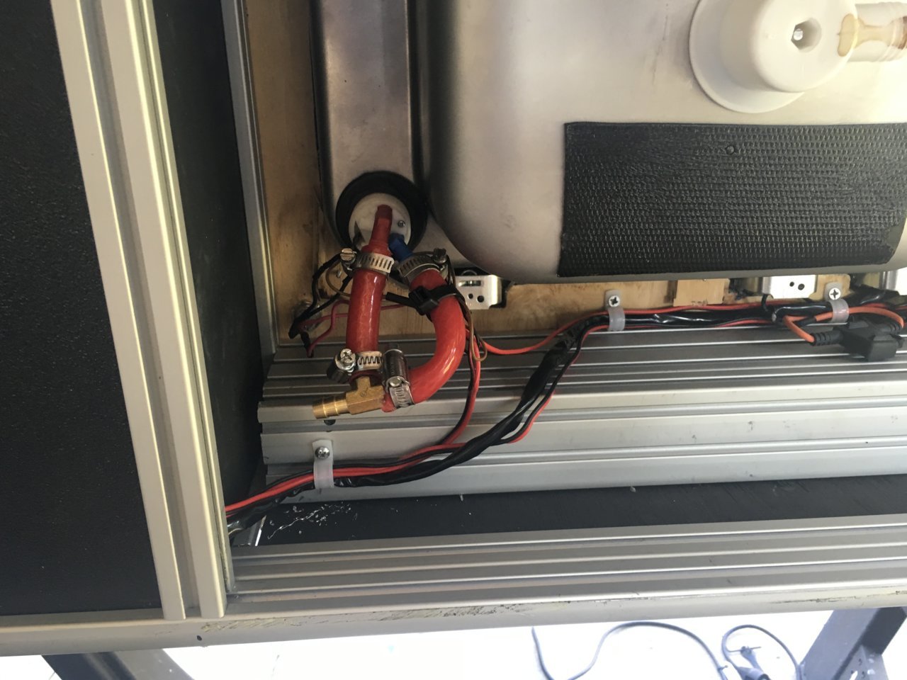

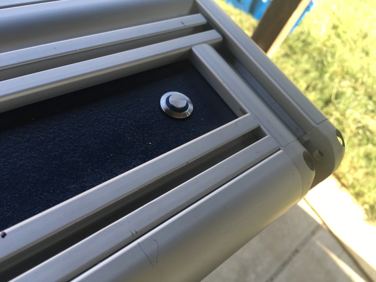

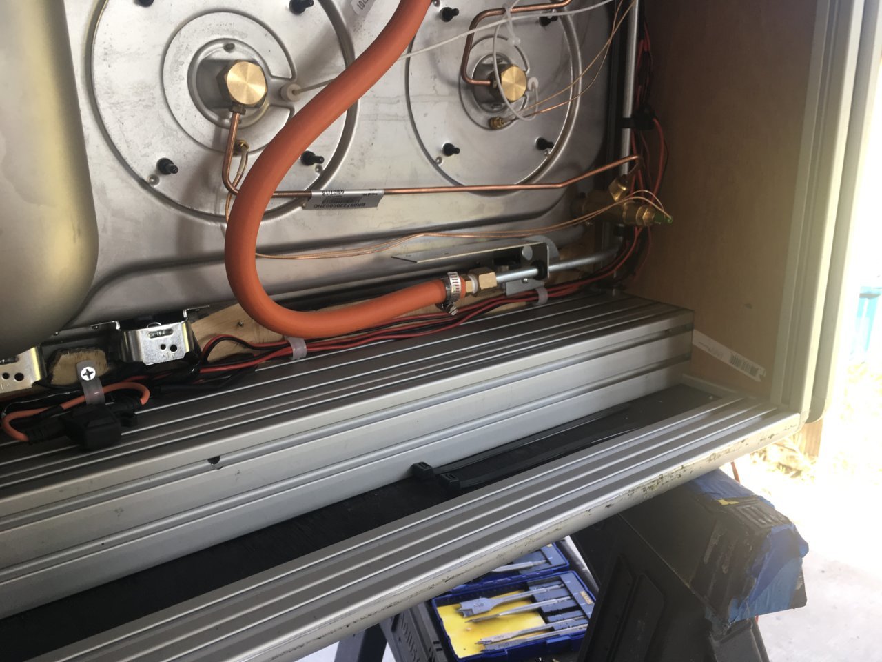

    Yesterday I got my wiring done on the drawer. I tidied up the wires and added an inline fuse for good measure. I have 3 switches which control the lights and power for the sink. The main power switch is set up at the end of the drawer and it is illuminated all the time in the truck. That way at night I can see where the switch is as it turns on the interior drawer lights and ground lighting underneath. When the drawer is open to expose the sink and burner there are 2 more switches accessible. One by the sink controls the power for the sink pump, it doesn’t turn on the pump as that is actuated by the sink handle. The third switch is by the burners and that controls the light that specifically illuminates the cooking surface. I hate cooking by flashlight, I know 1st world problems. Those two switches illuminate blue when switched on so it’s easy to make sure I don’t leave the sink pump on. This sink/burner set came with a water container and pump which I tested the duration and it gives me 6:30 minutes of continual water, not bad.
    I still need to add the rubberized drawer liners which will cover the wires inside the drawers.
    A736BF9A-6CBC-4D25-A319-75FE0FA151A0.jpg 6221AAE0-4119-44C3-AD2C-E0078EF87545.jpg 832839E4-BE45-4BAF-8949-19DA61F3AA4F.jpg 39428712-03A0-4511-873C-F8ED164BE522.jpg 9FD40F0B-7B07-4F49-8392-61709339C473.jpg 9ED88C6C-8829-4047-983A-87AF65CD3EBB.jpg 2D644F25-A182-4234-BEE0-38CE7EF4C22A.jpg D74CCE0C-190C-47F0-9482-EF44E45CF7FC.jpg

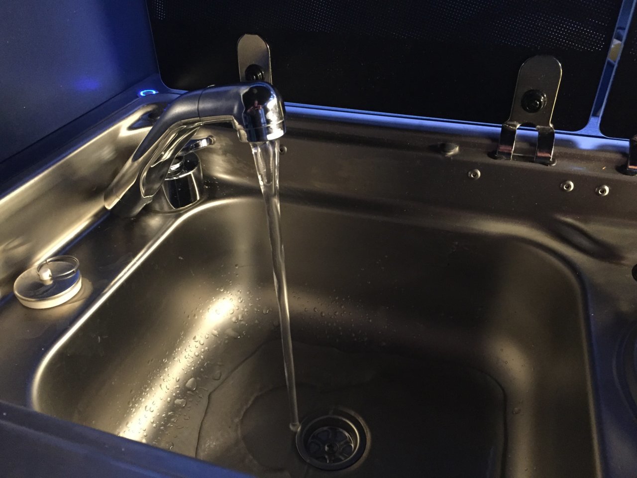

  14. Jul 7, 2019 at 9:19 PM
    #154
    Papadave418
    Jul 17, 2017
    #224251
    1,938

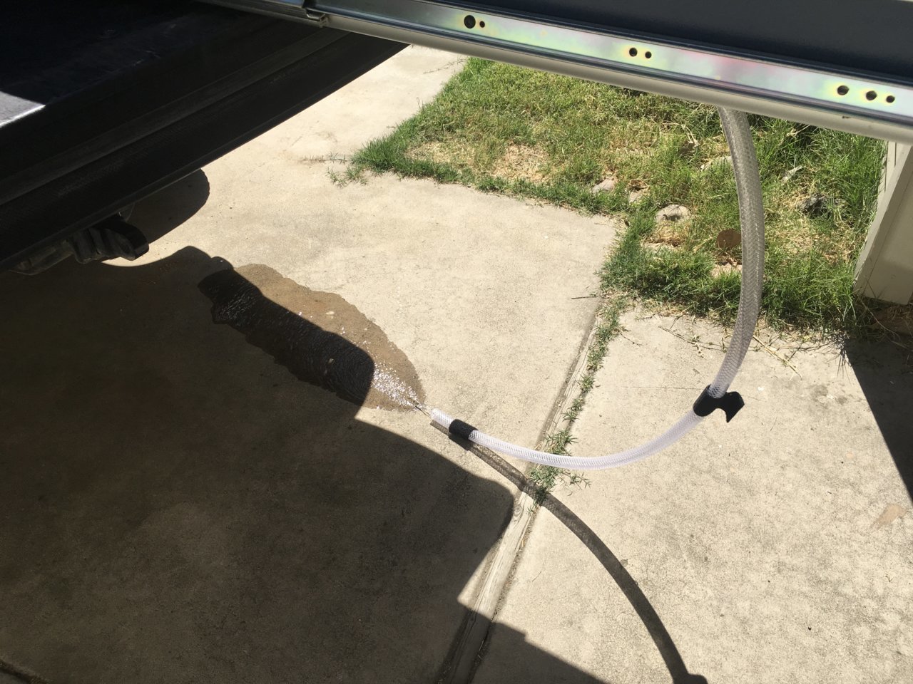

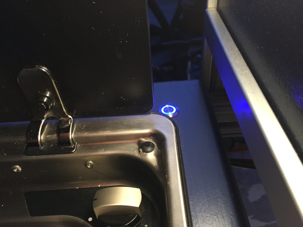

    Water is working, better picture of the illuminated switch, and drawer liners in (which also cover the lighting wires).
    D4D4DA83-FB0D-48D8-BA7C-3E9CB08ED961.jpg E850AC5B-1767-4A8E-8DFD-EE3D6A474FA1.jpg BD23A3A9-956C-4C70-A473-F0AD87492B1C.jpg

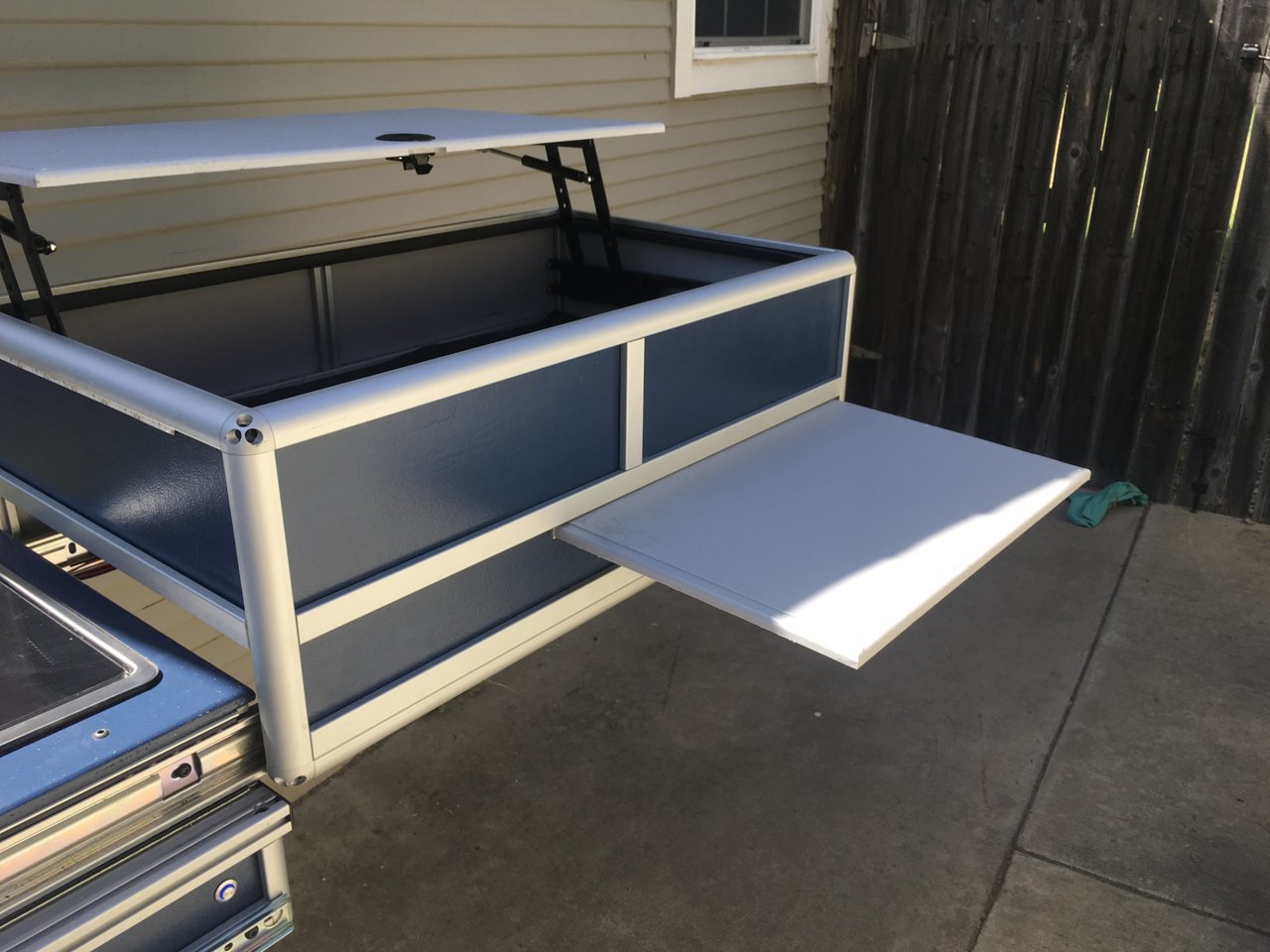

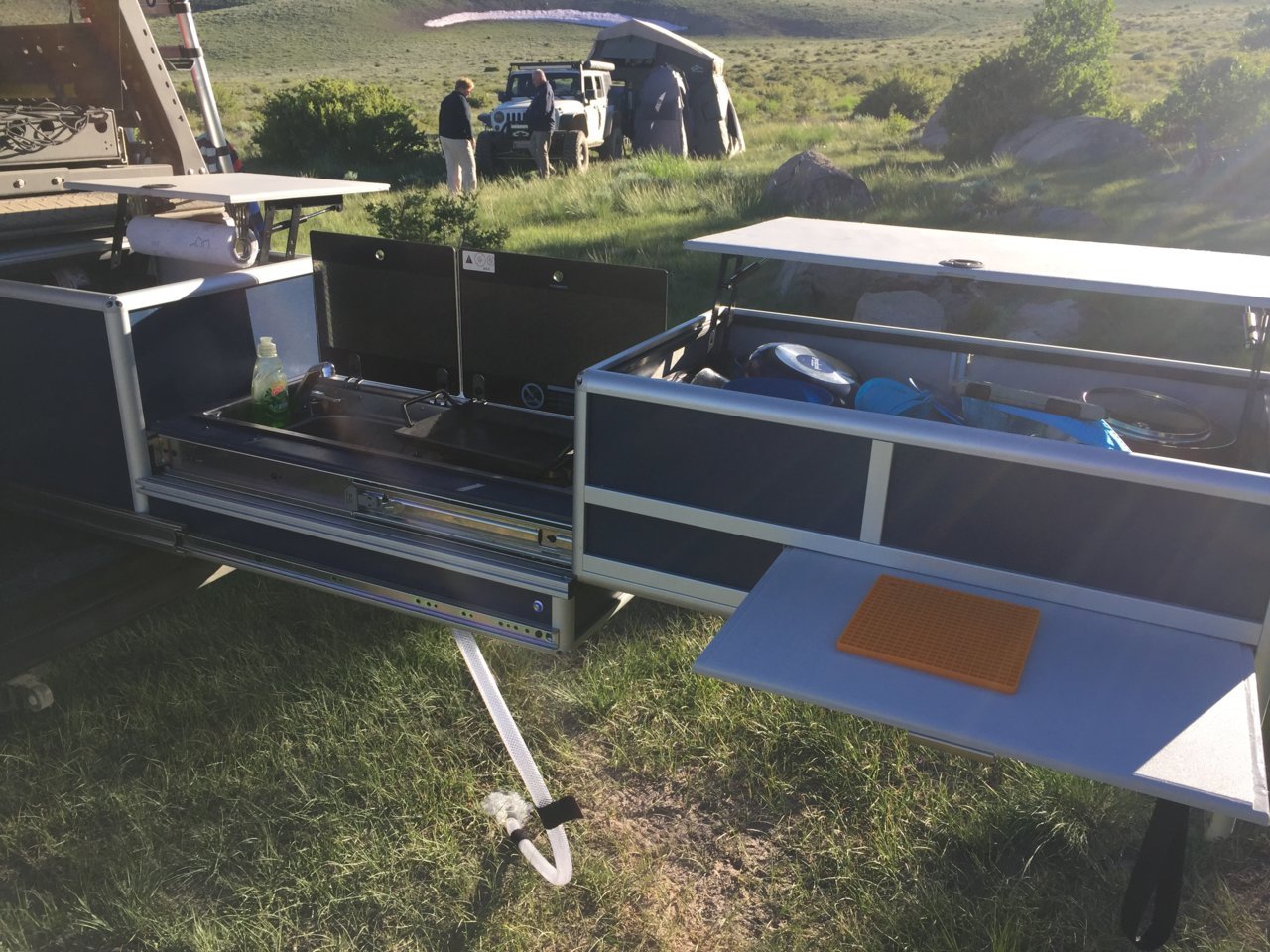

  18. Jul 18, 2019 at 9:12 AM
    #158
    Papadave418
    Jul 17, 2017
    #224251
    1,938

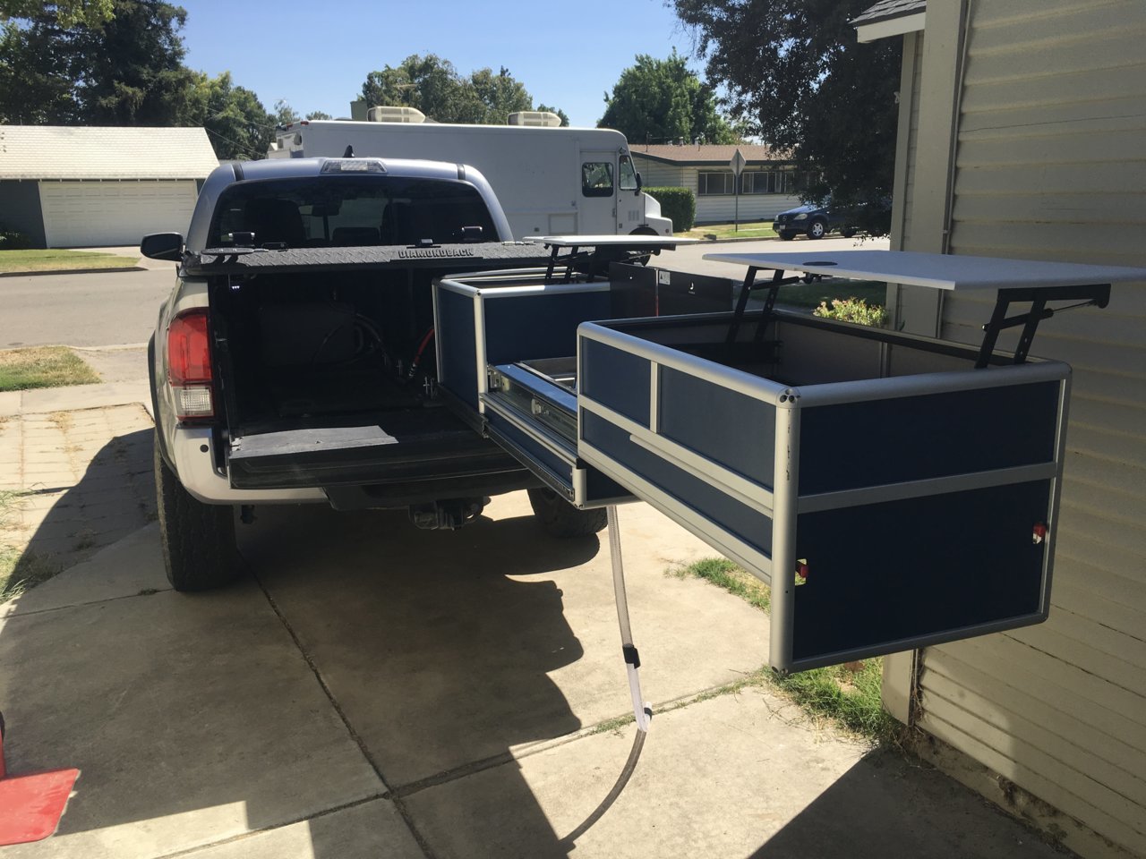

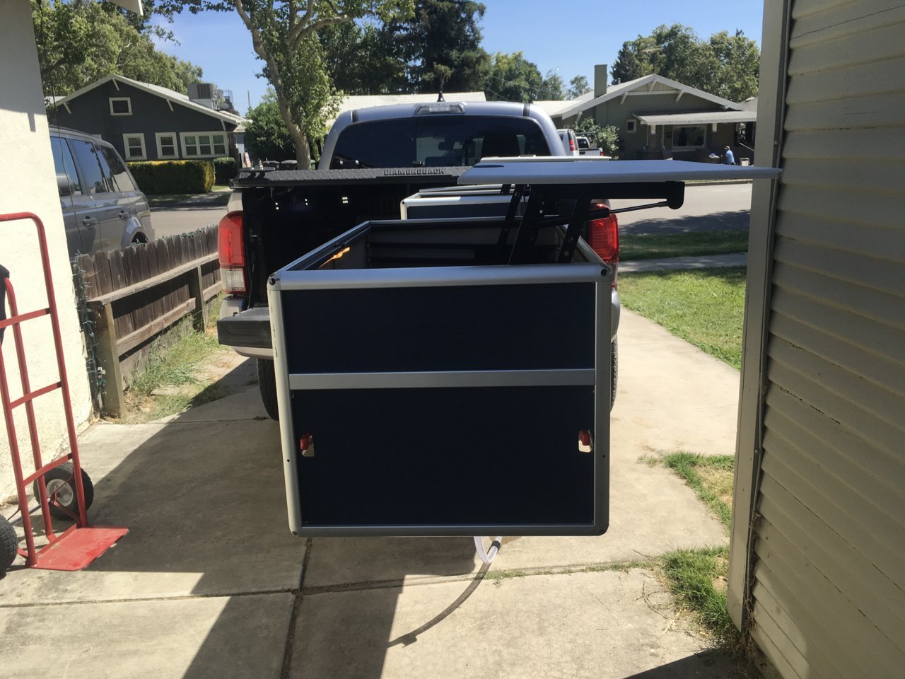

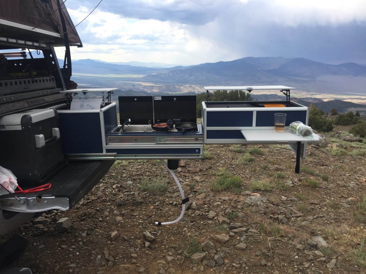

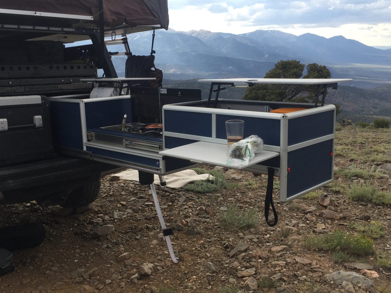

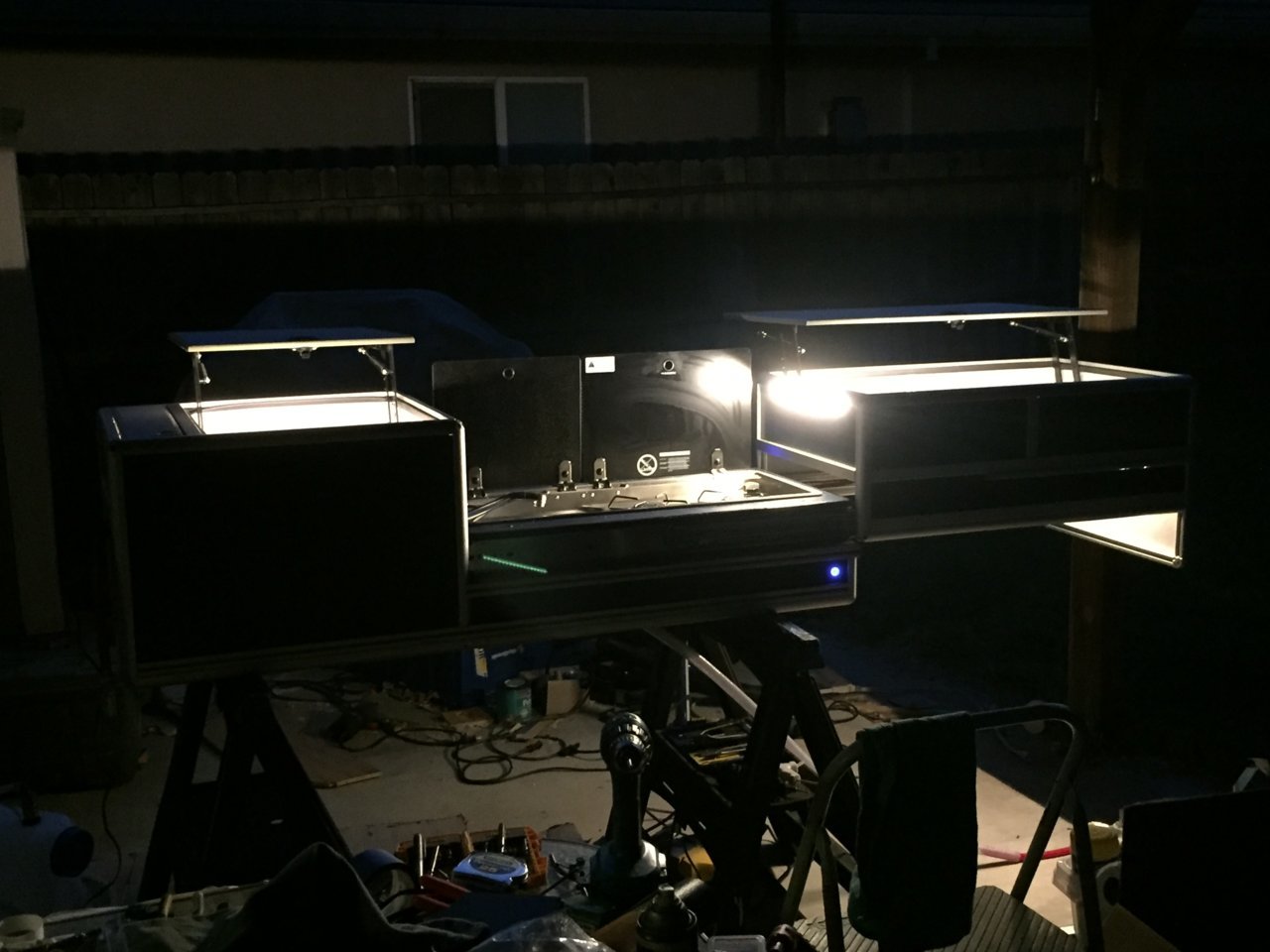

    Well here it is, ALL DONE!

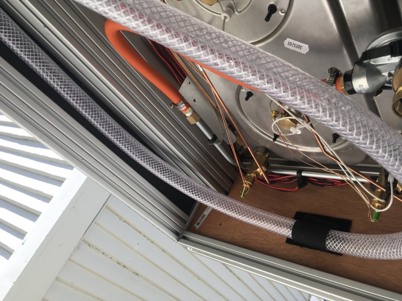

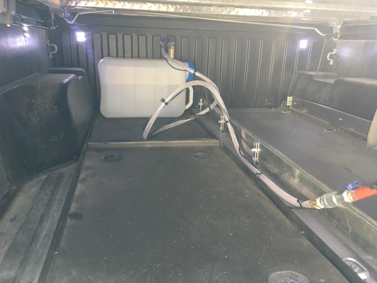

    Electrical for the lights, water pump, and plumbing. It works so well I’m stoked.
    Thanks for reading along, if you’ve got questions ask, and I’ll see you on the trail
    0F1AE034-4FC5-4F3D-B812-D7D883928217.jpgAB5D3F47-4BE3-46A5-9944-362D0C4CE8EB.jpgEC464F71-BFB1-4995-A35A-84C67E30BC5E.jpg2A53D826-363F-4B73-9EDD-B19050BC341A.jpg
