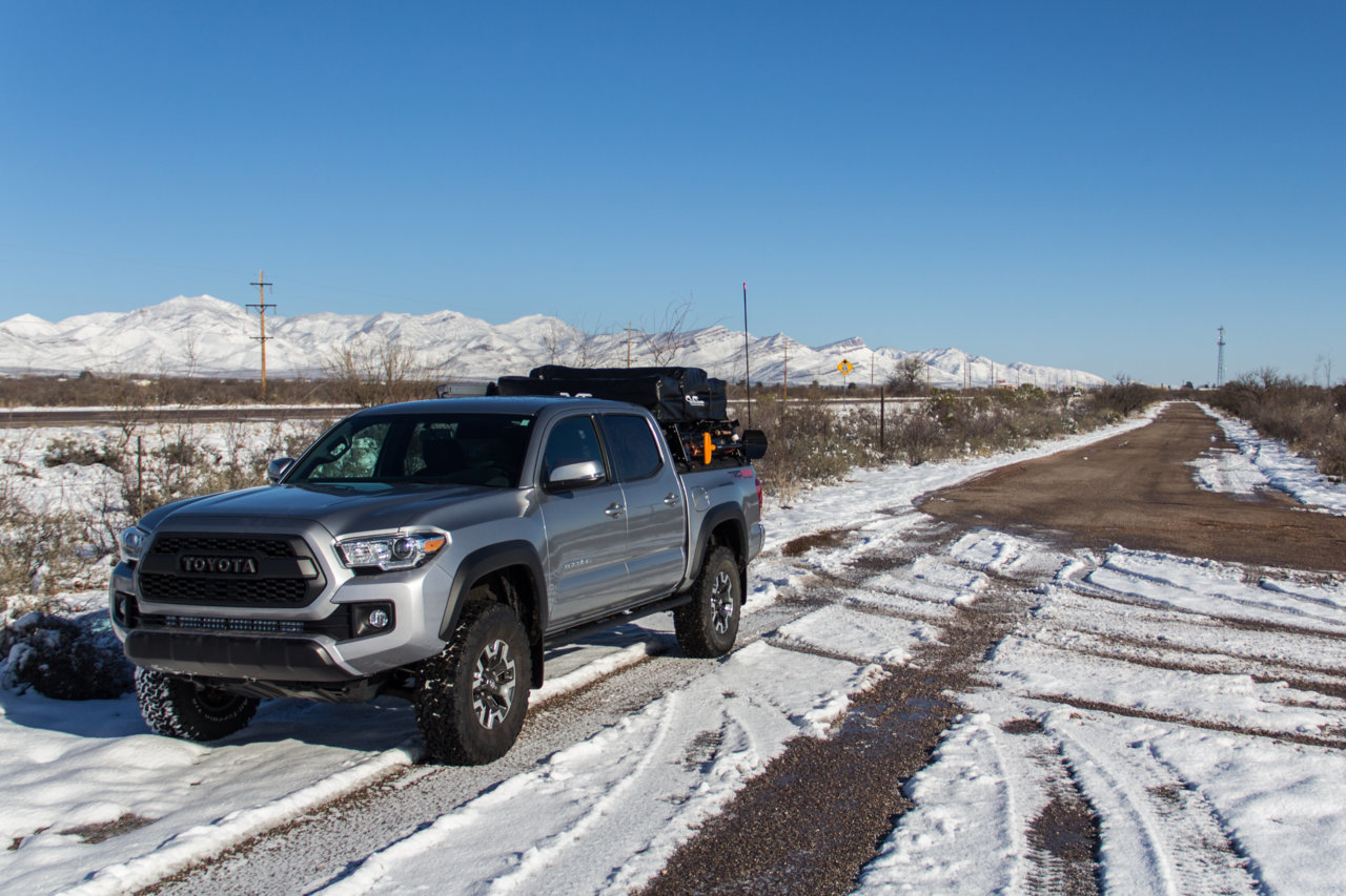

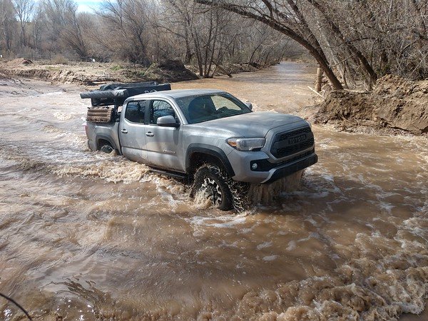

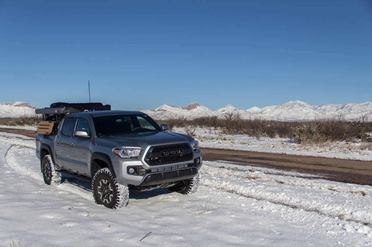

    Overlanding rig setup. 22.5 hub to fender front, 23.5-24 hub to fender rear with basic setup
    1) Bilstein 6112 front 2 inch lift
    2) Bilstein 5160 rear
    3) OME Dakar EL096R (heavy)
    4) KO2 265/75/16
    5) Diamondback cover
    6) KBVoodoo premium all steel rack
    7) CVT tent
    8) ARB 6.5 foot awning
    9) caliraised light bar
    10) OCF rock sliders
    11) CB radio with Rago fabrications rear mount
    12) Total Chaos Bed stiffeners
    Link for the walk around
    https://youtu.be/qTO9HHNjpbA

    Yea, solid bang for the buck. The tires cost $188 each, shocks are like $1200 total, and the rear leaf springs like $600 (can get the medium springs too if you don’t carry much stuff).
    And you don’t need new wheels, offsets, Upper control arms, trimming, rubbing problems, etc

    Yea, I wanted a “no worry” build and went with that setup; highly recommend :)
    The digressive Bilstein shocks help a lot with body roll on the road, and I can turn corners quickly even with a large load. Off road medium bumps at medium speeds are soaked up too. But washboards are bumpy :/

    So I went camping with my full setup in the rear and was sagging pretty badly. So I added the Dakar heavy leaf springs first, but didn’t realize how much of a lift they were (like 3.5-4 inches without weight) so my rear end was super high up.
    So I needed to lift up the front at least two inches and was going to get 5100’s all around. Then I saw the 6112/5160 combo wasn’t THAT much more so I went with those.
    However... a 2 inch front and 3 inch rear lift with stock tires wouldn’t look great, and already had trouble with a flat tire last time I went off roading so I went with the KO2’s described.
    Love it in the end :)

    Much better on and off road. That being said they’re digressive shocks and they come with everything that comes with that.
    On road. Smooth but yes firm. They really shine when you’re turning a corner and help prevent body roll. You feel less like a boat.
    Off road. So pot holes and medium bumps at medium speeds are soaked up well and not harsh and you truck feels in control (so medium and low speed trails are great). Only downside is if you’re on washboard or gravel, it’s pretty bumpy. But more or less similar to stock in that regard. If you plan on speeding in the desert, probably not for you.
