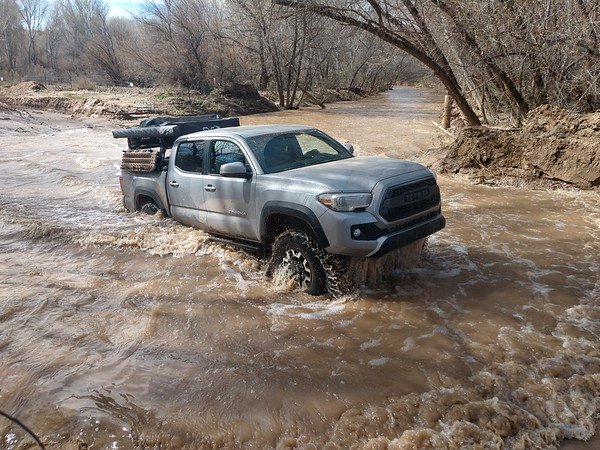

    Water crossing :)

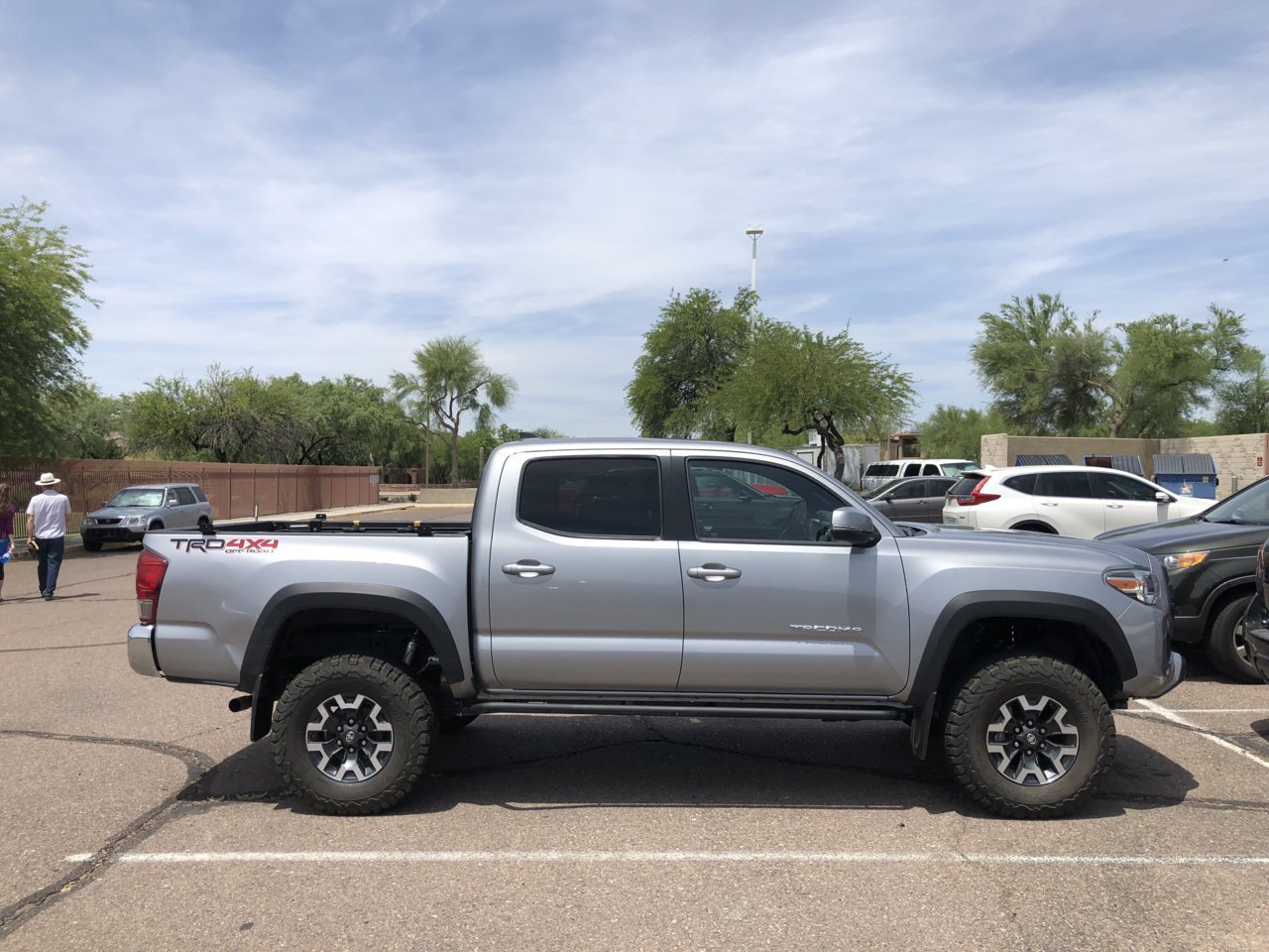

    How it looks with an empty bed

    How do you like the ride? I have the 6112/5160s with medium leafs that I am installing on my 19. Shits been sitting in my livingroom for a year lol..

    So the shocks are awesome for an Overlanding rig. They’re digressive so they provide a lot of resistance early on, which includes during extension. Do body roll with a heavy rig is MUCH improved and noticeable on and off the road. They’re digressive on compression too so you feel washboards but they’re damped decently well.
    The leaf springs are nice. I have the heavy Dakar leaf springs and with an empty bed, they kinda stiff but not so bad. With a couple hundred pounds it’s nice (which I typically do, Diamondback cover and steel racks).
