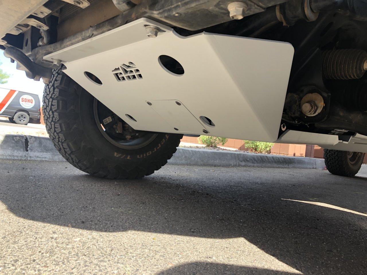

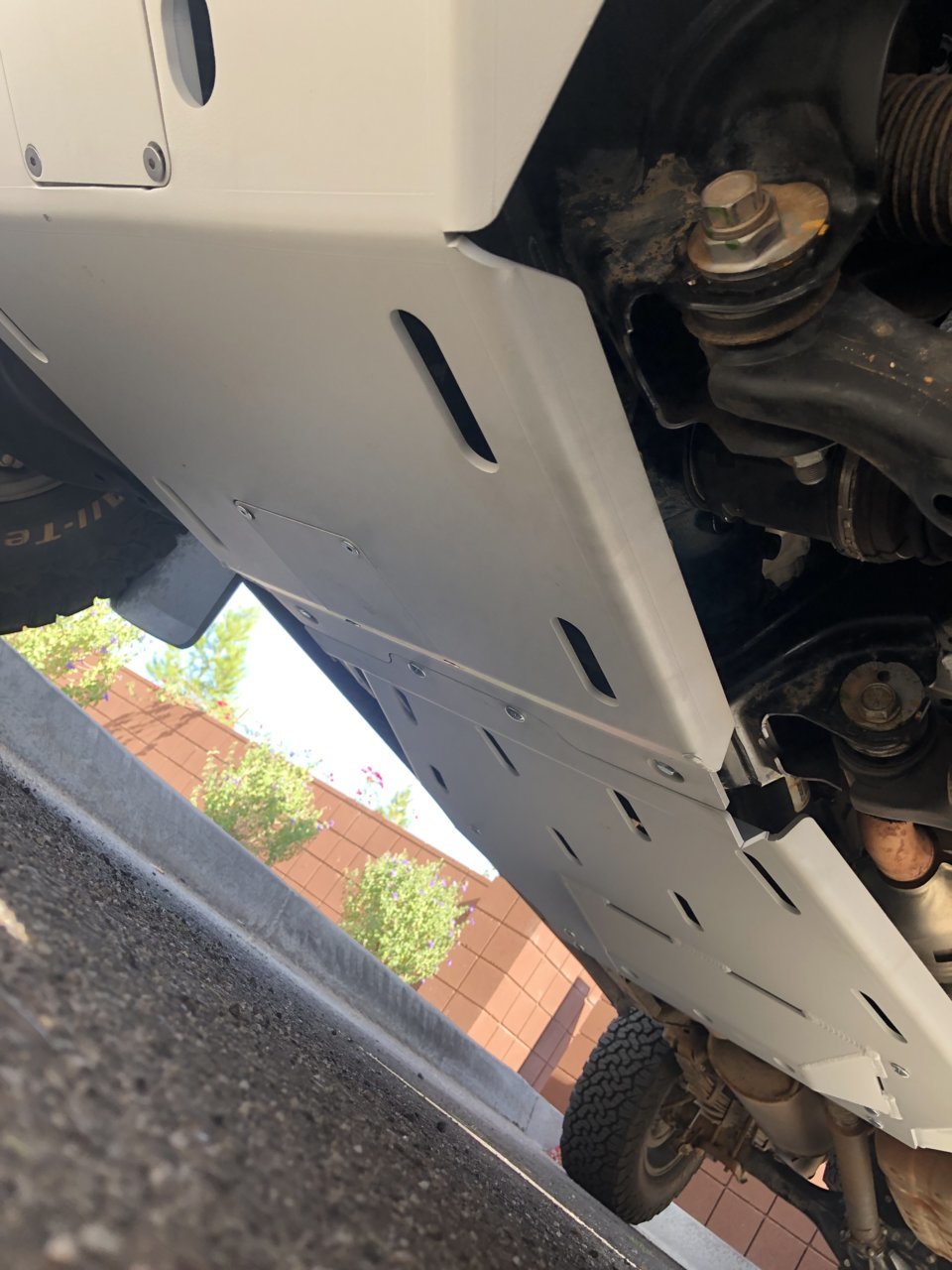

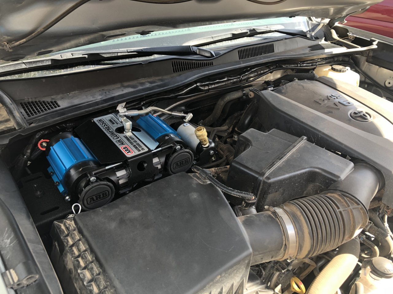

    More upgrades!!! New video coming soon :)
