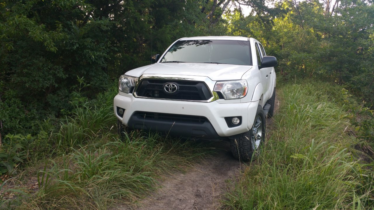

    So i got my windows tinted today!! Looks much better IMO!! 25% front windows and 5% brow and everything else...
    Pardon my dirty truck! Its been raining here in Dallas...
