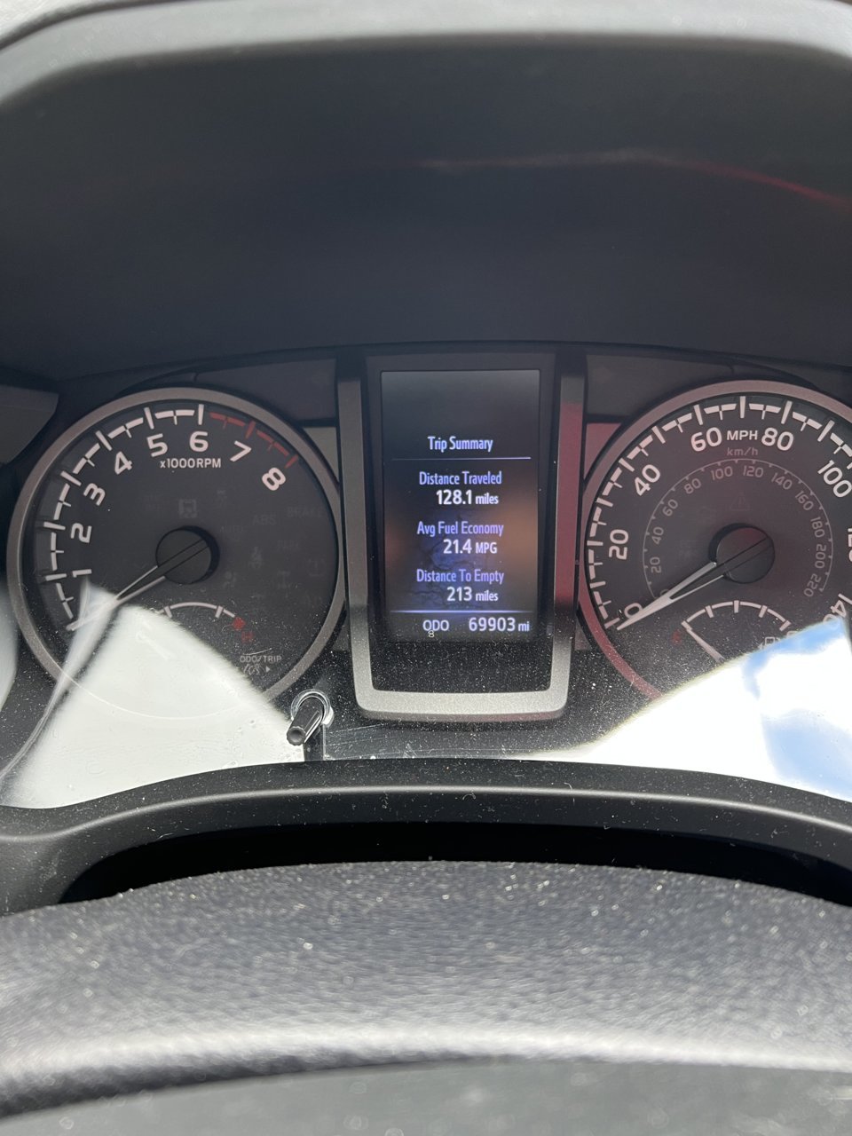

    My recent road trip over the weekend was flawless thanks to the new OTT. I drove back from the Washington coast with my near 6000lb Tacoma and was able to produce numbers I never thought possible from such a heavy rig.

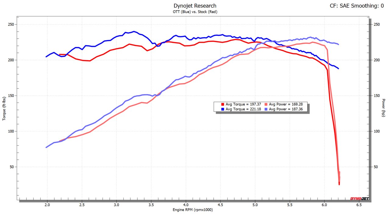

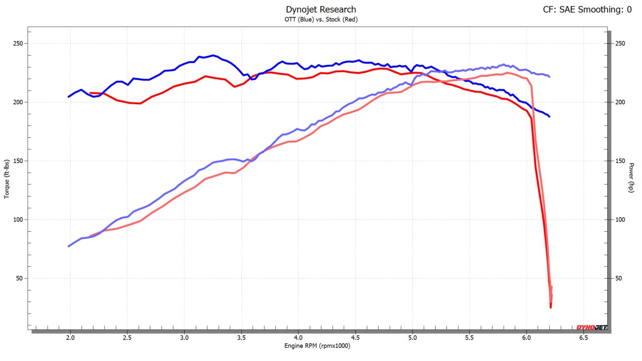

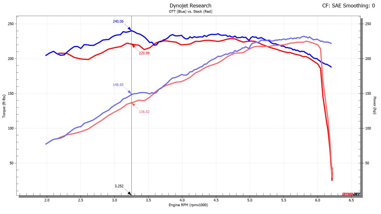

    Why does your stock file have an ACIS dip at 3400, but your tune dips at the 3600 range? Is the red line OTT?

    We couldn't get the tach pickup to work, so we used drum speed to infer RPM. Slight error depending on RPM due to tire size growth. The runs are accurately labeled in the header.
    Attached is the log from the run. (Edit) Stock Run log..

    What's the deal with the dip around 3500 RPM? I see it mentioned above this was caused by the ACIS system (had to google that one). Is there any way to tune this out or otherwise eliminate it? It is quite noticeable.

    It can be tuned out, yes.

    It can be smoothed out, but it is a compromise. Smoothing it will reduce HP/TQ in what I would consider an important RPM range.

    Not by a terribly significant margin, and the resulting smooth performance will yield smoother acceleration with an elimination of the bumpy power dips and bumps.

    OTT also showing SAE Smoothing 0, vs some other data on the site at SAE smoothing 5. The OTT data is more “raw” and other data shown at SAE 0 will show less “smoothing” as well. People need to keep that in mind when looking at dyno data.

    Smoothing will indeed help to even out some of the larger dips and spikes, but typically can't turn substantial dips into even and smooth power curves. It is very likely that you'll apply an industry standard of 5 smoothing and those same dips will remain nearly identical, particularly as the total curve for the two pulls is nearly perfectly mirrored.
    It should be said that it's okay to have that dip I suppose since it appears to be in line with your goals for the tune. :notsure: you guys made a conscious decision to retain it and have elected to commit to it.
    That's not to say though that eliminating it does not have its benefits, or that tuning it out doesn't result in beneficial changes that can be taken advantage of elsewhere.
    Your statement is that retention of the dip is done in order to make the most of what you consider to be an important section of the powerband, but by allowing it to remain, the problem is only displaced at best, and over the course of a full wot pull it'll still be noticed and have an impact on performance nonetheless.
    If this is the goal for the tune, then well done. If it is not, there's honestly nothing wrong with announcing that it was a disappointing dyno day and that further testing and refinement is being conducted. We've all been there.
    I do recommend another dyno day though, at minimum for your own records with proper verification of data and rpm, since inference of rpm's shown is effectively an implied admission of inaccurate and possibly even skewed data.
