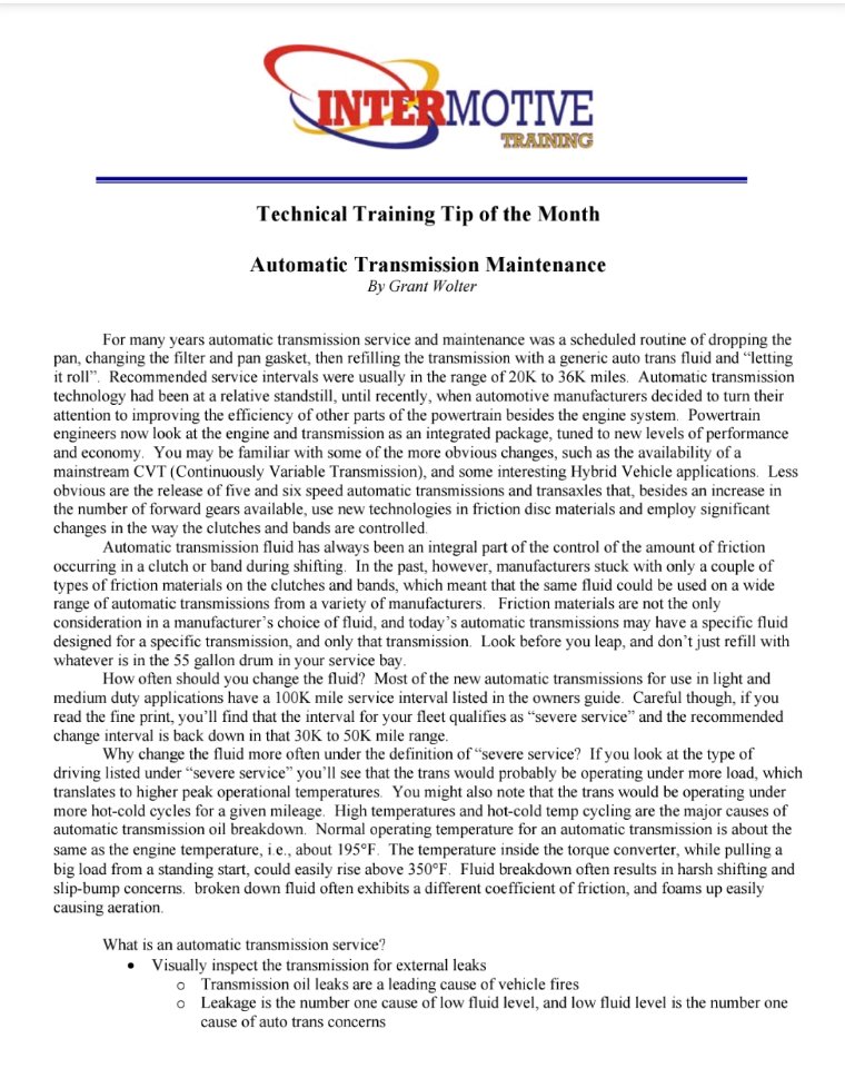

    Nope. I did not mistype 350. That's a feedback I got on my issue with the tune.

    It's amazing how easily information can get skewed. This was my statement dear friend...

    You stated this as if I told you 350⁰ was normal operating temperature and ok to be sustained. It was a worst case scenario type situation... Just to be clear.
