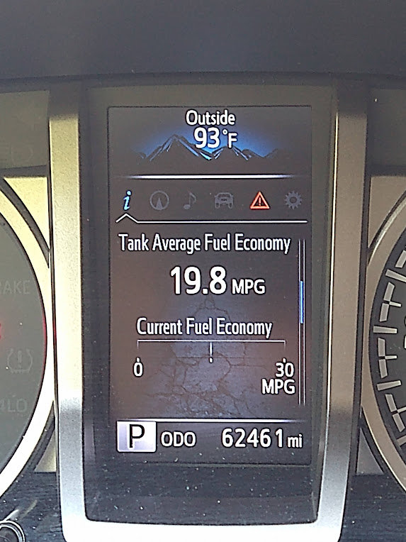

    Is there any benefit to wiping the learned history in the ECU prior to doing the OTT8 tune? I have 8 (Mild) now and low-speed/part-throttle driveability is awful (bucking, throttle off/on), was wondering if the learned settings might contribute to this? My tuner is on an epic trip so I won't be able to get it reflashed for a couple of weeks yet, which gives me time to find an AGM battery - but when he's available, he's going to reflash.
    Also, last tank of gas == more disappointment. Approx. half freeway at 65-70mph, remainder typical suburban driving. Loss of 2.5 mpg, and I track every tank manually in a spreadsheet.

    Were you on another tune previously? Or tuned from stock?

    I was on OVTune 2.0. OTT8 was flashed, nothing else done, took <5 mins.

    I would take that MPG and run like hell and never look back. I think I average about 15-15.5

    I think that there have been minor issues when coming over from other tunes that have overcompensated by using too much airload to try to get power. Remnants of that tune can effect how your truck learns the settings of the new tune. If it doesn't work itself out, I would recommend a reset and reflash. Your truck should not be acting the way you described.

    Thank you for this, I'll get with my tuner when he's back in town and have it reset and flashed again. Hoping that smooths it out!
