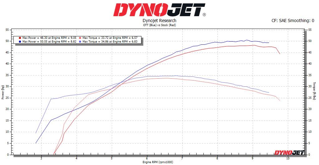

    **Little off-topic fun for those who may be into the moto community**
    If there's one thing you should know about OTT is we love tuning! While the Toyota platforms is what we're here for, this is a little behind the scenes look at what we do when we're not working.
    After fitting my 2021 KTM 500 EXC with a few bolt-on modifications and fitting a fully programmable standalone ECU to the bike, it was to be a fun day on the dyno getting the bike dialed in and ready for some dual sport adventures.
    For those curious, the bike was fitted with a Euro specification airboot that eliminates the reed valves in the OEM boot and the endcap of the factory muffler was replaced to eliminate the necked down/choked exhaust. Aside from that the only other modification was a GET RX1 ECU w/ the GET LC1 wideband. This setup allows for closed loop fueling correction well beyond the capability of the OE ECU w/ the narrowband O2.
    Thanks to Tucker Speed here in Ogden, UT for the use of their dyno. Always great to work with knowledgeable professionals.
    Got the bike strapped in got to work. The GET ECU uses a programing software called Maya. Massive map resolution and access to every map made dialing in this bike a bit more work than the typical Toyota we do daily.
    Fuel Map. (Inj PW in μs)
    Working with a DynoJet 250i dyno and it's Eddy Current load cell, each throttle angle was independently mapped to ensure fueling and output were optimized. Spending the time to ensure every RPM/Throttle angle was mapped to perfection made for a tremendous improvement in how the bike feels. Not something we were able to determine while strapped down, aside from the crisp and immediate response you could feel as the engine responded to throttle inputs; that was quite evident.
    Some of our data analysis during the session:
    Unfortunately I didn't bring the stock ECU with me to do a true before/after, but I did spend a a good amount of time riding with my laptop in a backpack datalogging (LOL) refining my base map before the dyno session. We got things pretty spot on, and with the mild state of tune the bike was in there wasn't a whole lot to be gained. However, other sources have dyno'd stock 500's and we were able to make some significant improvements with some basic airflow mods and a tune.
    Cycle World dyno results:
    https://www.youtube.com/watch?v=JL3AG1OGdiE
    OTT's base map vs a custom tune:
    On the trail the bike is SILKY smooth through the entire throttle and RPM range. The tractability of the bike is unreal with and the throttle literally feels connected to the engine. It's really hard to describe. Even being a cable driven throttle body with no electronic TB mapping that can mask the true character of the engine, this thing feels like a sewing machine. More throttle and the bike just smoothly and predictably accelerates. Very rewarding. Couldn't be happier..
    Recent ride to the summit of Lewis Peak here in UT:

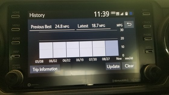

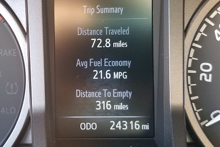

    2021 TRD OR PREM A/T SSM
    A big thank you to @RCTuningFL and OTT! Great person to work with if on the east coast of FL.
    Running OTT for 4 months and over 10k miles. Great tune and still as much fun to drive after 10k miles as it was in the first 10.
    Recently switched from 7.0 to 8.0 w/AGM (mild/medium, 4.88 gears)
    Ample power in the 2.5 to 3.5k rpm range and ZERO gear hunting.
    I can't count how many downshifts I have saved, but my transmission also thanks you!
    A surprise bonus has been the fuel economy which is very close to where it was when stock.
    Since installing 7.0 in May, I have consistently been in the 18.5 to 19mpg range under all types of driving conditions with ~21 or better at 70 on highway.
    A solid balance of performance and efficiency in all driving conditions makes OTT a worthy investment.
    upload_2022-9-6_12-58-57.jpg upload_2022-9-6_13-0-15.jpg upload_2022-9-6_13-1-12.jpg upload_2022-9-6_13-3-21.jpg
